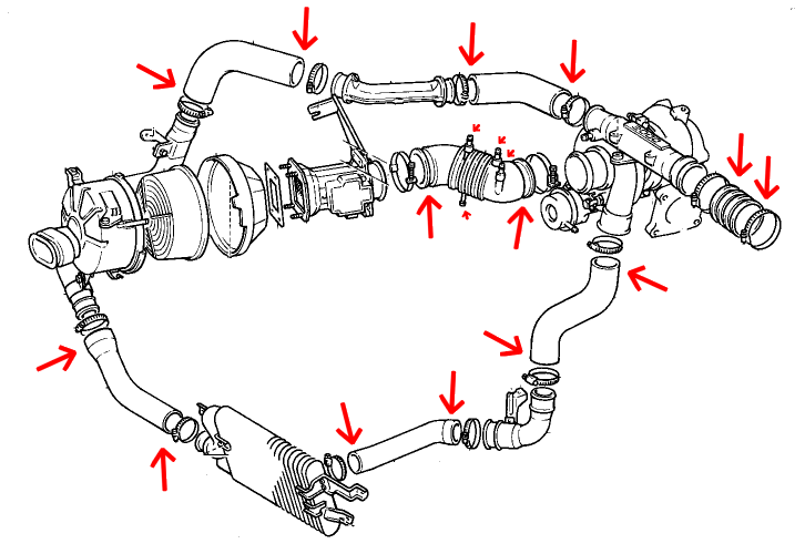

i80.photobucket.com
start checking for boost leaks here:
