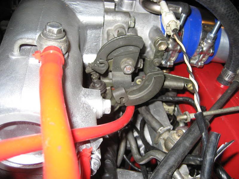

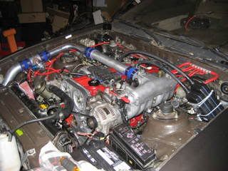

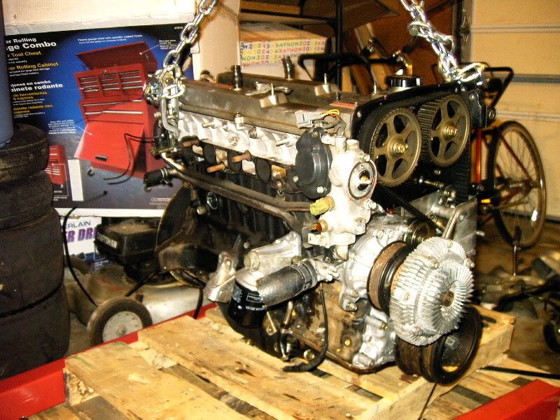

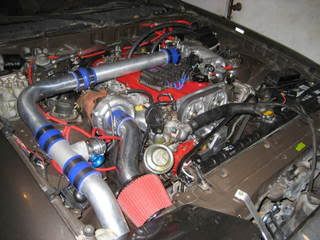

Few pictures if anyone is still watchin this...I haven't been the best at updating it. The motor is running now, but at 400 rpm. TPS issue? Wired other two gauges, in the middle of the auto fan relay, yea everything works now but I need the stupid throttle linkage piece that I can not find anywhere!
Here she is in the car
A loooonnngg 6 months ago...
