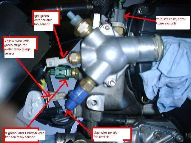

Can someone help me identify the 4 sensors located on the water outlet of a
1990 7mgte auto--I know 3 of the sensors are cold start time switch, temp gage and ac fan switch. the 4th is supposed to be a temp switch for efi(computer)?--can someone help me identify these parts along w/factory part #'s--local dealer can not seem to find it. Thanks.

This what you are looking for?

Couldnt find any info on my thread, really? Did you look at the pic? lol All the sensors and wire colors are in the pic. The only thing I didnt do is post the part #'s for you.
Look in EPC for it.
This might help get you started
http://www.cygnusx1.net/Supra/Library/EPC/291420/catalog.aspx?F=8715&P=1
Or this
http://www.cygnusx1.net/Supra/Library/EPC/291420/Parts/88625C.aspx
Hard to tell from pic witch one is for the TCCS
