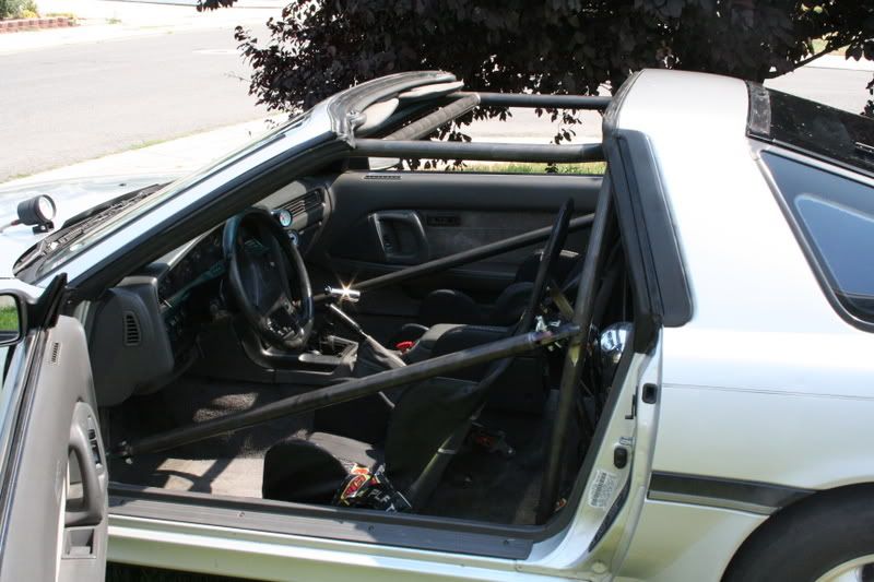

Mine are fixed... and tied into the cage!!!! I don't want to go anywhere when the sh@t hits the fan.
<edit IJ fixed pic>

spiller;1454300 said:
doesnt that create a weak point within the roll cage?
yes and no. since he does drag racing he is not really gearing his cage for a full on side impact like road race cages are. would a welding in doorbar be safer? yes but there is always a trade off. in this case he wanted to not have to climb in to his car like a monkey like i do. it should be perfectly ok as long as a side impact isnt to fast. you would never see that on a road race car but its an entirely different situation.
TUN can you get some pictures of how the seat is attached to the cage please
also please follow this guide for harness mounting and angles. bad angles can break even the best seats and get you hurt or worse
http://www.schrothracing.com/sdocs/2009_Competition_Instructions.pdf

I compromised in my Z car and put a kink in my door bar to make it easier to get in/out, this made it in between a swing out and a straight bar in strength and it stood up well in the accident.
Tun_x
Built to do the NASTY!!
878
Utah
Enraged;1454621 said:
can you completely remove a swingout? if so, it would be nice to be able to remove it when you aren't racing.
yes you can ... which is why I opted for swing outs as my car is still a "street car" :nono:
