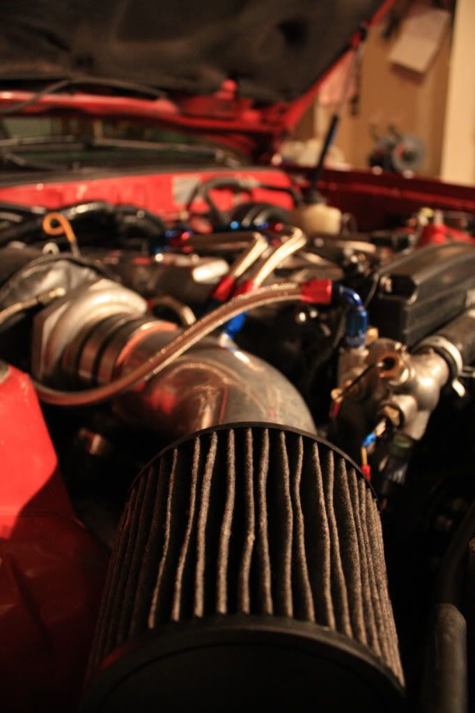

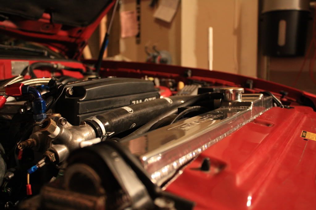

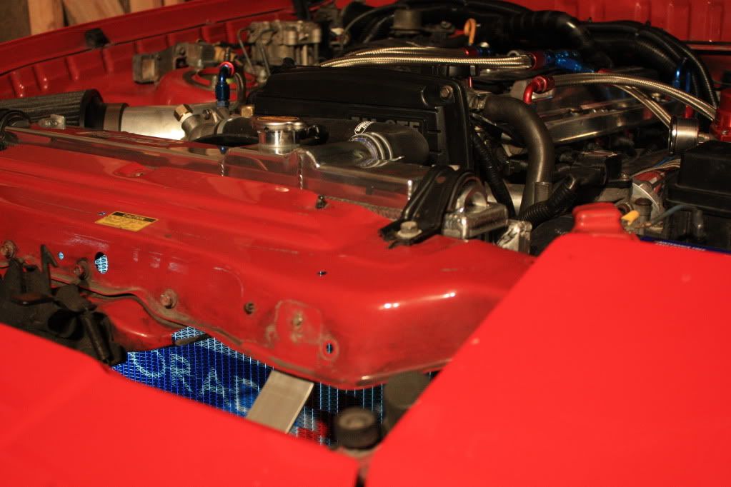

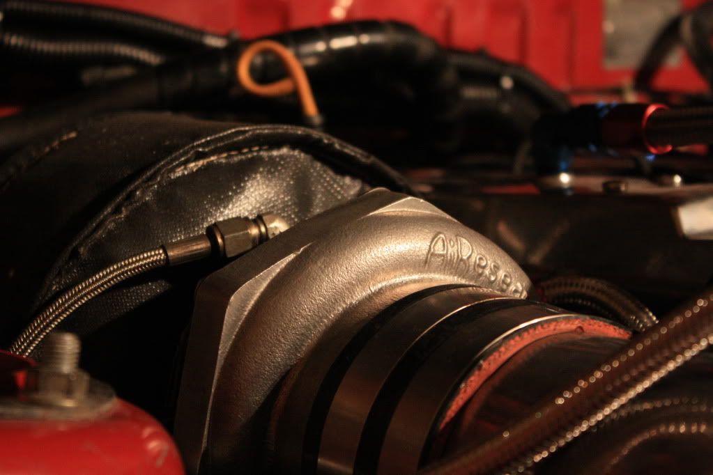

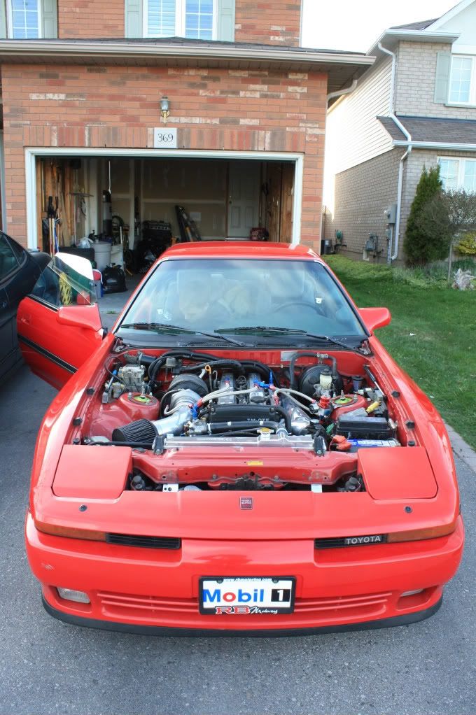

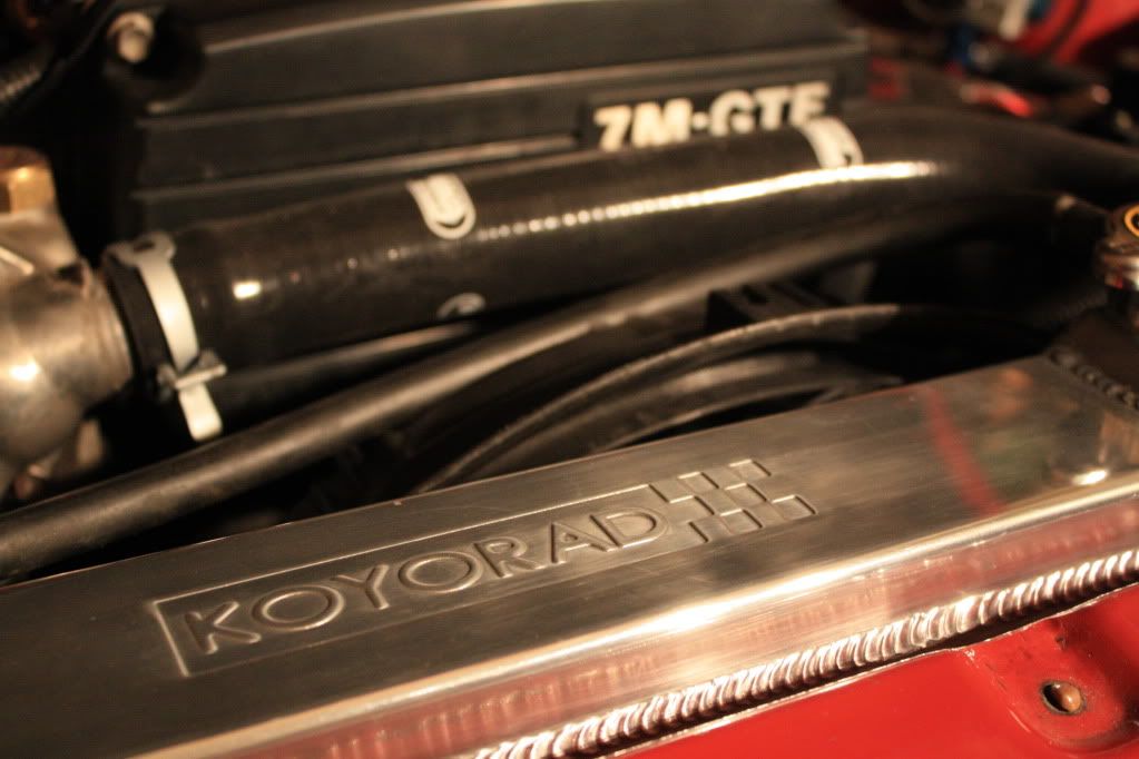

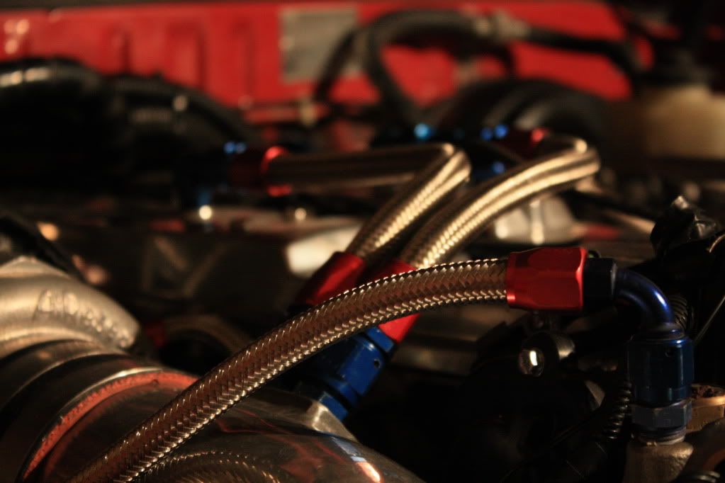

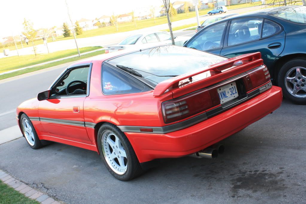

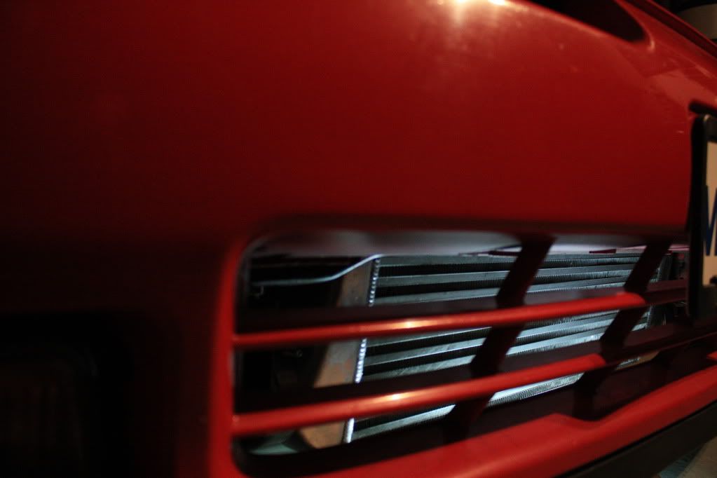

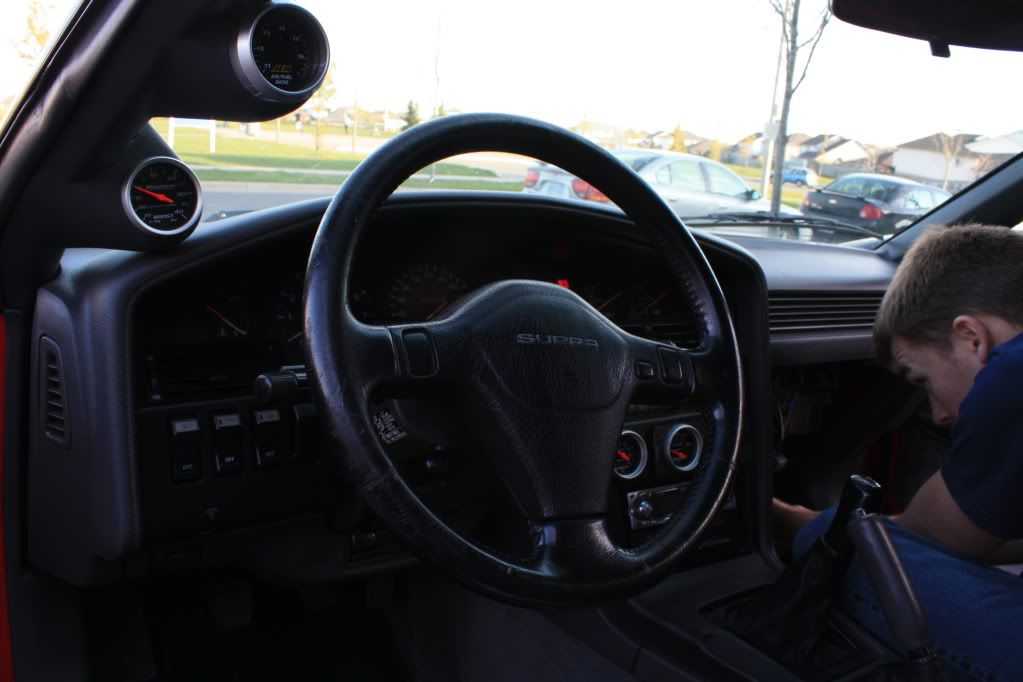

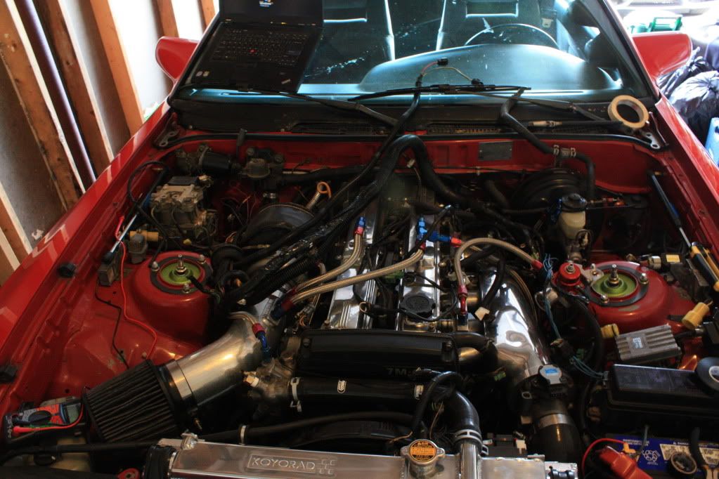

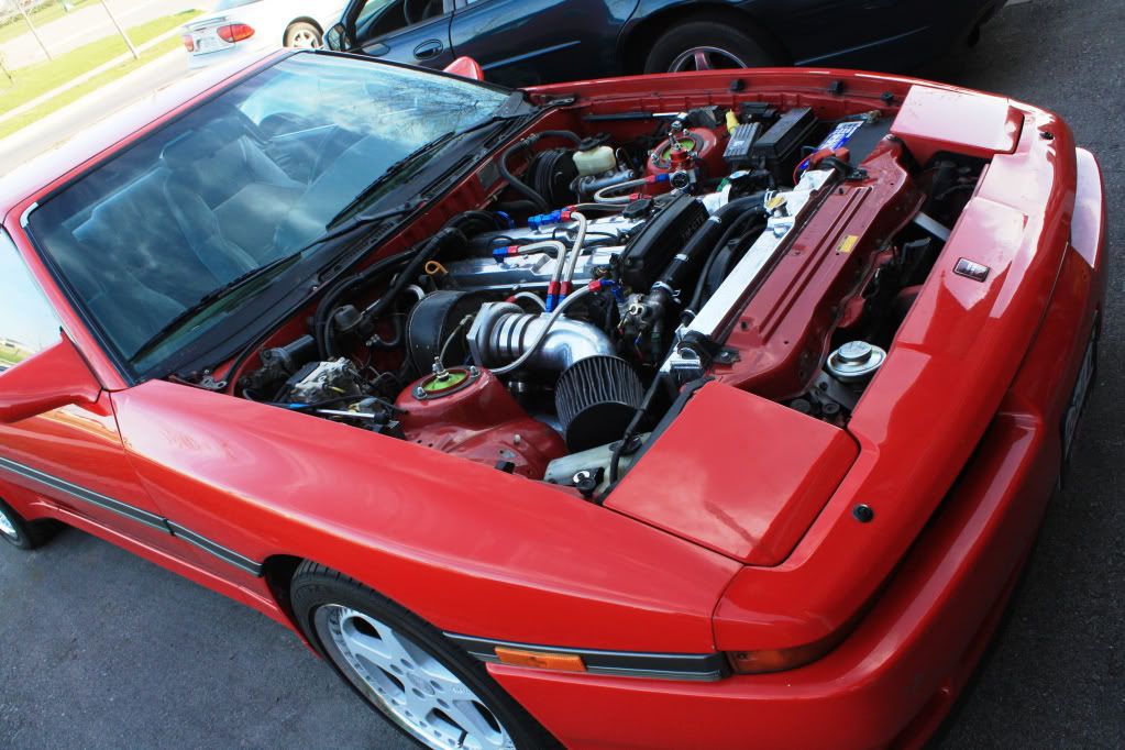

Apparently all codes are solved. Drove the car today and it is running kinda rough but I attribute this to it being completely untuned. Have a lot of reading to do before I start actually doing stuff with the MAFt-Pro. I took some pics to commemorate this momentous day.

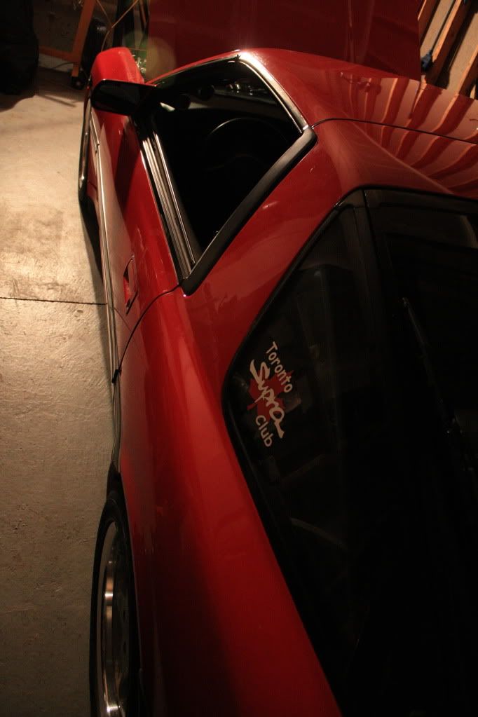

Ya I don't want it stored outside so there will need to be something done. As soon as I get money the bitch will be tuned. Very excited. More pics.

Today the car moved with me to my new house and it did so under its own power. I win. lol
Spent some time and money today. I drove to the local exhaust shop and had the downpipe extended to reach the cat. It is now hooked up and sounds normal again. I think it seems too quiet but that's just because I got used to open downpipe.

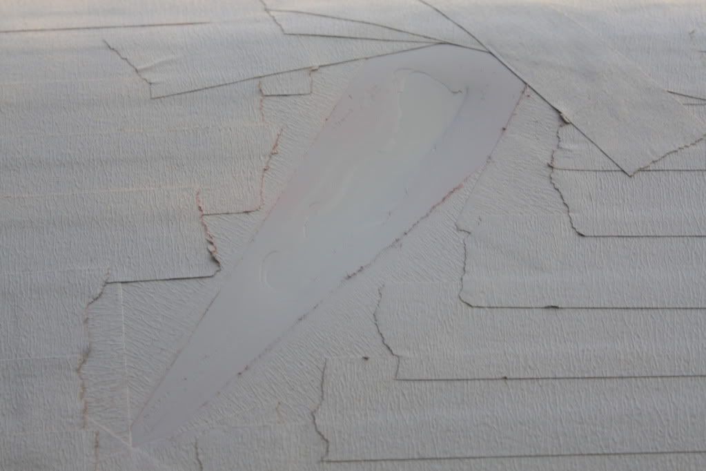

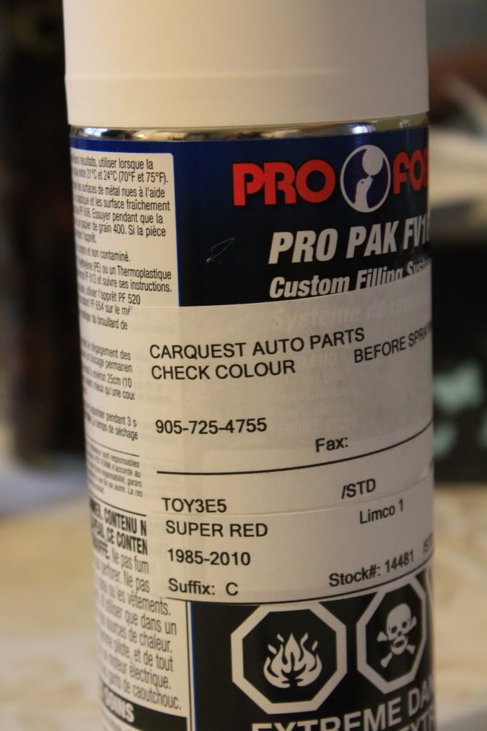

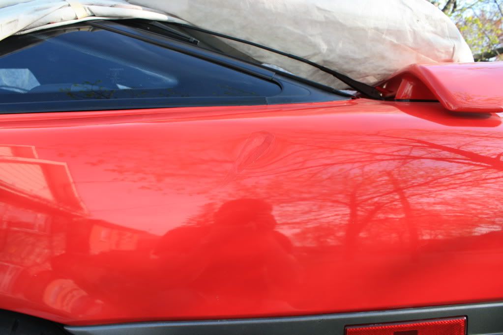

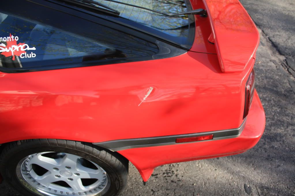

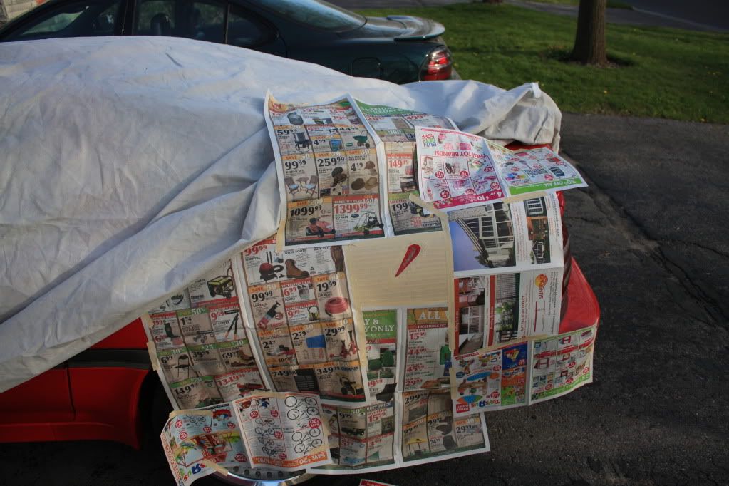

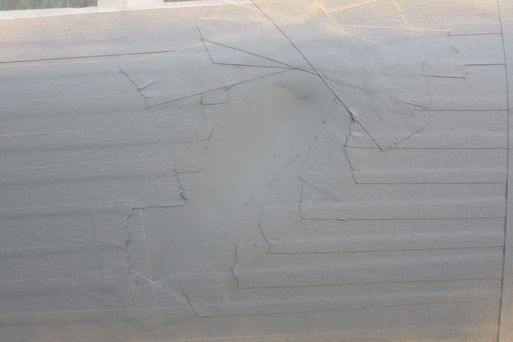

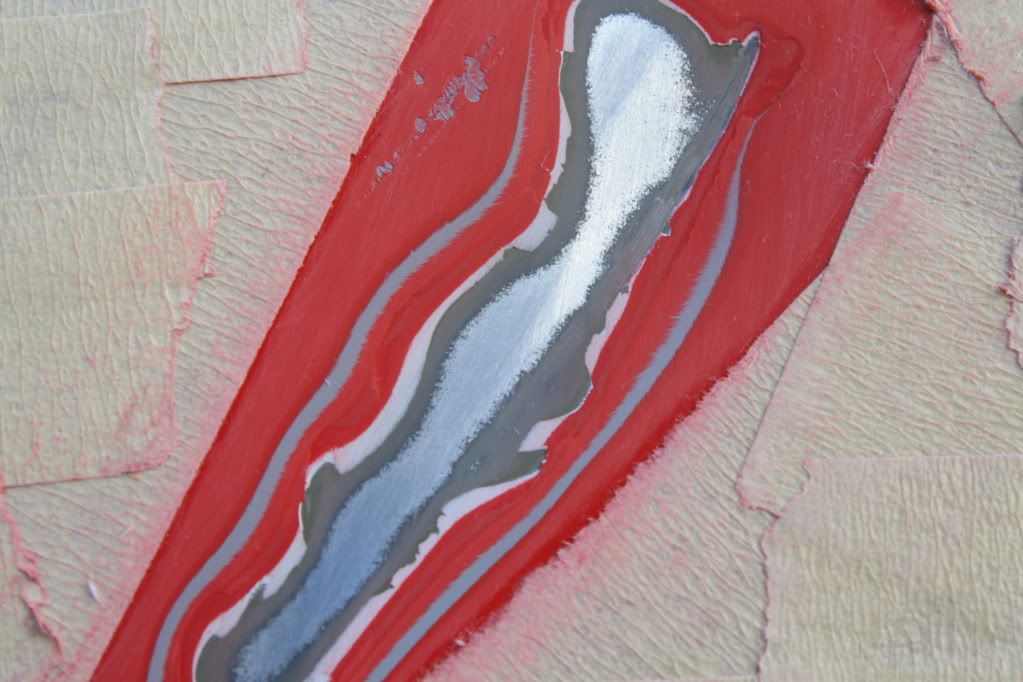

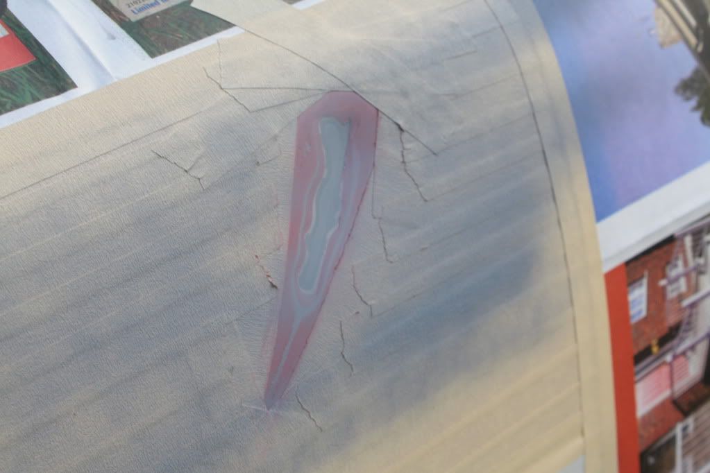

I then decided to tackle the fender that got dented. I don't have body skills so I didn't even try to fix the dent. Instead, I am trying to paint the gigantic scuff so that it doesn't rust before I get the money to fix it properly. So here is what I have done thus far.

Sawbladz
Mar 14, 2006
1,727
Oshawa, ON, CA
It's all finished now. I laid down 4 thin coats and it ended up decently flat with minimal orange peel. The colour is a little darker and the edges where it was taped were raised. I used a brush and touched up around the edges to blend it a bit. Will have pics up later.
