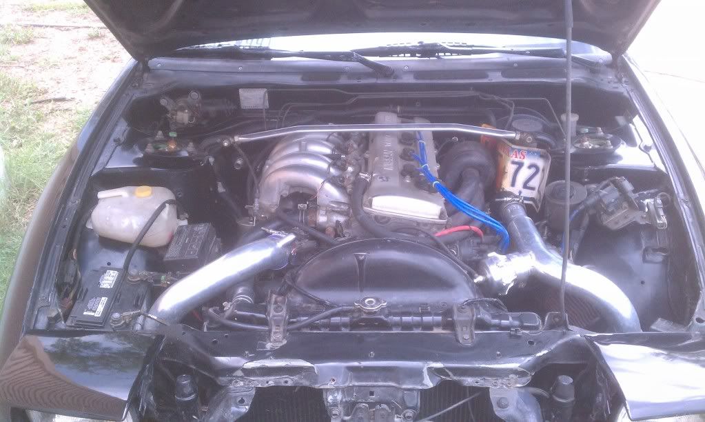

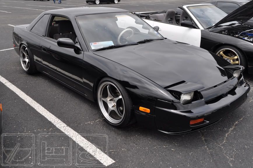

How's it goin? Man an S13...or i believe 240sx. I wanted one of those but the bro n law got me hooked on the supra. I guess since its your daily its still stock.

It was stock at first..haha
I took it out to sar on wed. Night got a 13.6 at 104mph

Ya I already got the engine and trans. It's going in my other 240sx though. I may go 1jz with this one if the 2jz swap works out on the other one.
