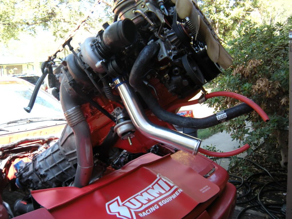

Nice pics, thats one sexy downpipe and some very clean seats. LOl. Looks good is that a stock ct26 or upgraded?
Nobody wants to touch it because it is cast. But i talked to The guy that does the turbo's for drift motion and he said he'll have one by Monday. so I'm gonna cross my fingers and hope That i can get it here by the beginning of the month. I plan on getting it dyno tuned. Hopefully before the meet.:naughty:
its a 57trim with a 10degree clip. Im glad that downpipe is flexable cuz i kept hitting it on shit. haha

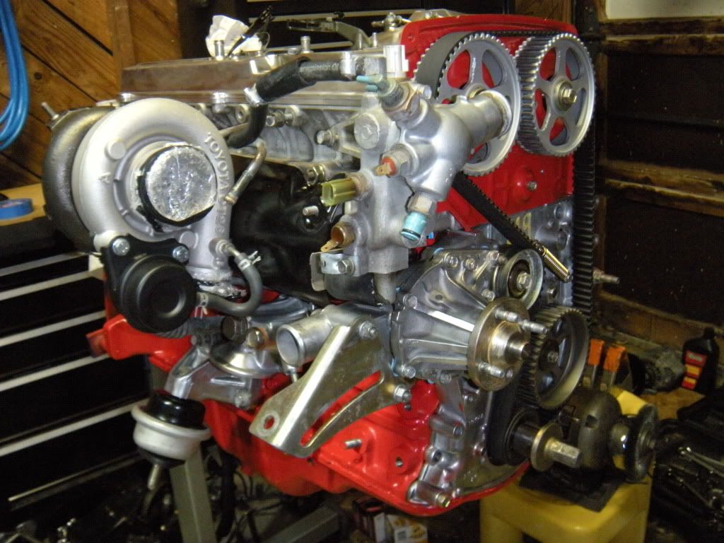

On my way to San Antonio to pull that head off. So, I'll have a better idea of whats going on with it. I think It needs a valve job. Well thats what I'm hoping
Oh yeah and that turbine housing on my 1jz was the wrong one. It was a o trim machined out to a p trim. So it was not breathing right. Hopefully the new one will make a big difference. we'll see.

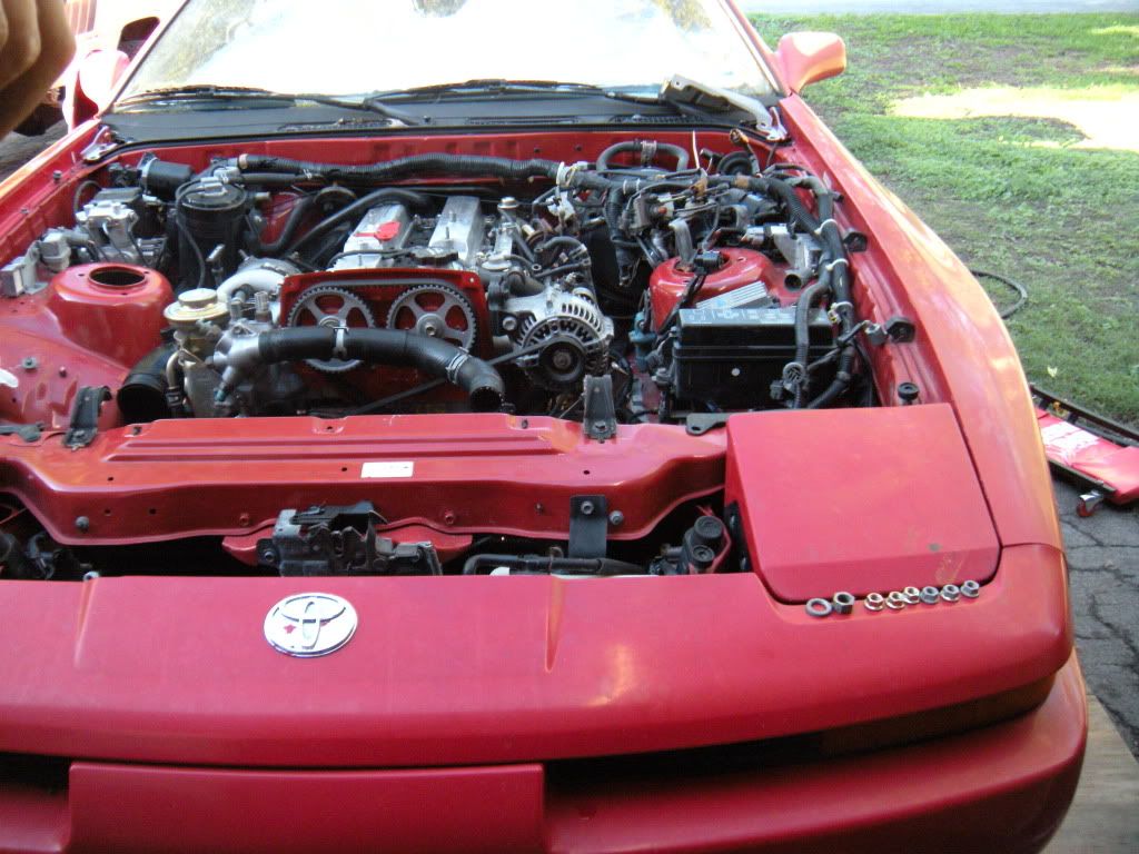

::bhg:: Check it out. Pull the head and found a massive bhg. Pistons and cylinder walls looked good. The head cams and valves look great. So hopefully head gasket and arp bolts and call it a day. Check between cylinders 1 and 2, and 5 and 6. no gasket.
when you put it back together change your oil a few times. I think thats why i got my rod knock.

S.A. you should check the head for straightness before you slap back on. Is that the 7m on that red MKIII you recently bought?
Where do you plan on dyno tuning? When? I'd like to be there if possible. Isn't there a performance shop in your area that's known for being tuning guru's?
Yeah I asked san sup about that. I'm gonna take it to the machine shop and have them look it over
