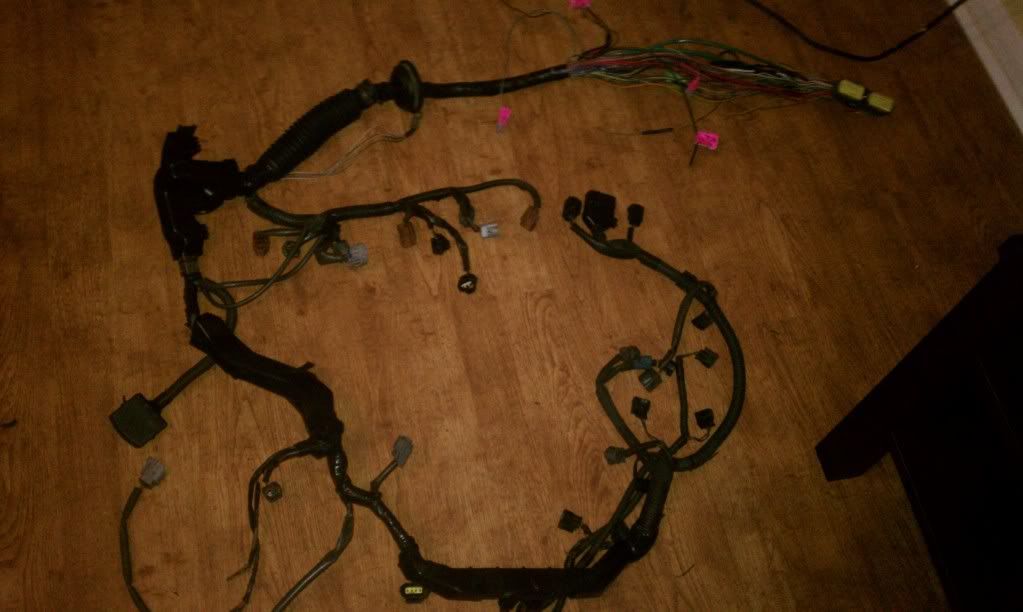

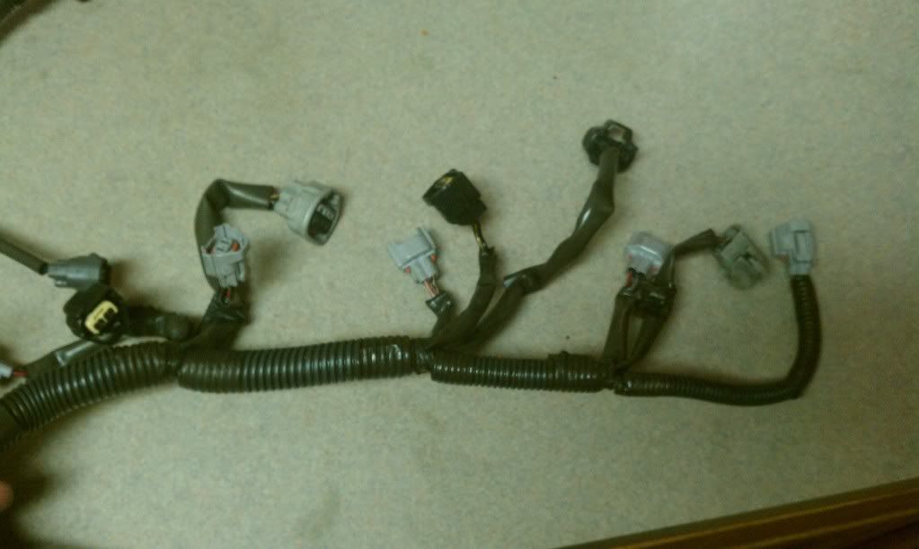

Well I've done all I can do for now with the harness. I'll have to drop the engine in in order to see how much wire I will need for the body harness plugs. I have tore down the hot side, have to get the block cleaned up and painted, before I slap the new gaskets on. I'm having a hell of a time getting the crank pulley off. Its not in the car so it's even harder.
Pic of the cleaned up harness.

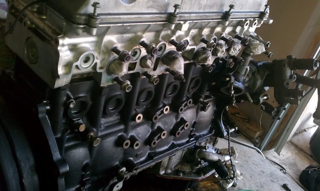

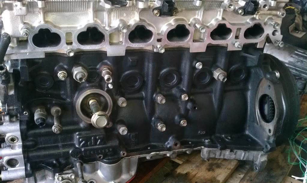

I tore down, and cleaned up my engine today. I ran into one problem I can't remove my oil pump. Do i have to remove my oil pan in order to remove my oil pump?
Here are some pics.

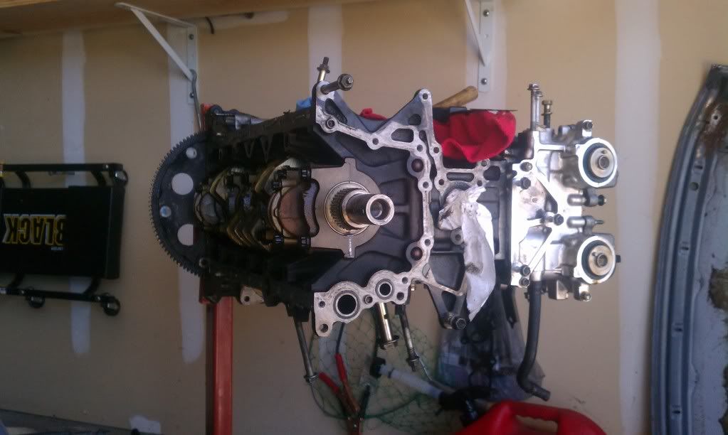

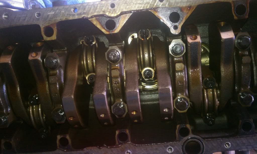

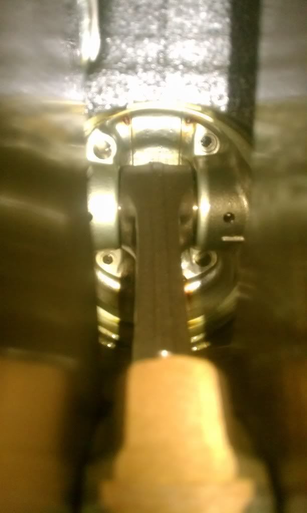

My bro in law brought the engine stand ove,r and I got busy. I removed the oil pump and oil pan. The inside of the engine looks good. no metal shavings found. I'm happy about that because it seems like every seal or gasket was leaking, and one of the turbos was blow. Now just have to wait for my parts to come in. I'm waiting on the following parts, Act xtreme 6 puck clutch kit, fidanza light weight flywheel, OIl pump, water pump, bellhousing, and gasket set. \
Here are some pics of the inside of the engine.

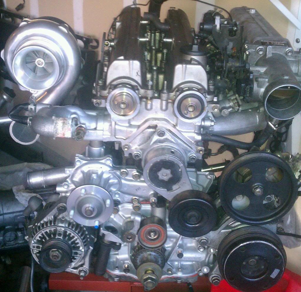

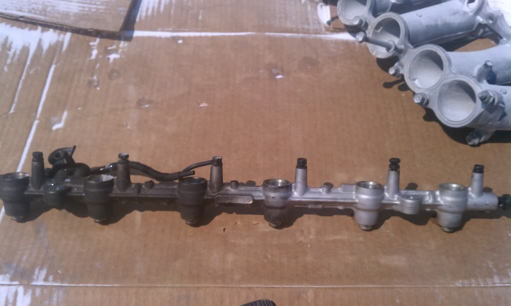

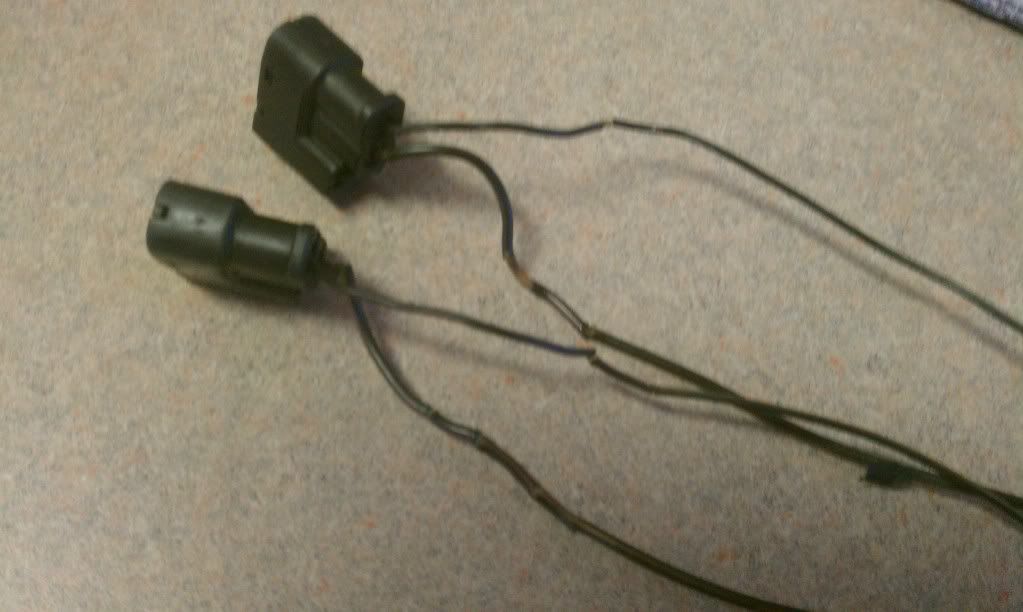

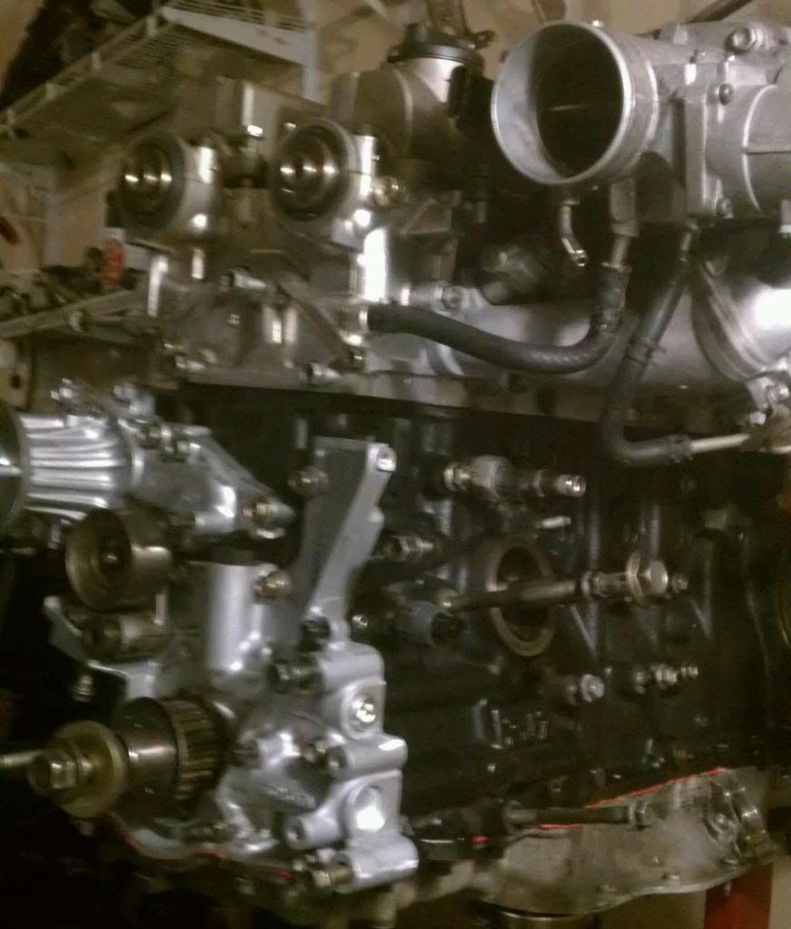

Well I worked on her all day Saturday, got quit a bit done. I soda blasted, and cleaned a lot of parts. Also put both cams, front and rear seals on. A long with the oil pan, oil pump and water pump. Wanted to work on it Sunday but my freaking a/c in the house went out. To top it off it was one of the hottest days of the year 107 degrees. I wasn't about to get in the garage.

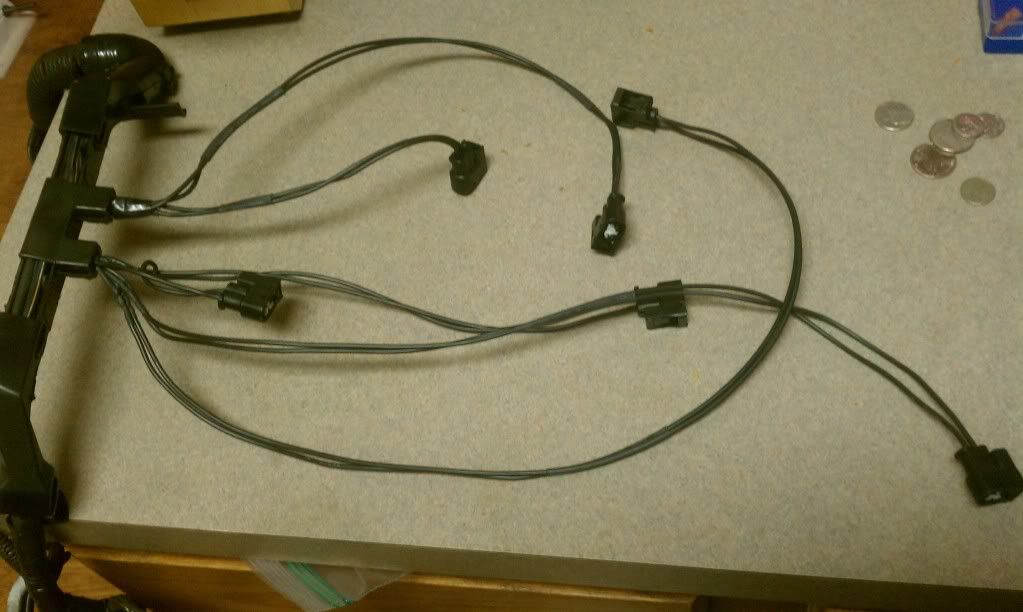

I also installed 6 new injector clips and also repaired and rewire all 6 coil pack clips. Here are some pics of my progress.
Soda blasted parts
The brittle coil pack wires that I repaired
Repaired
New injector clips
Progress on my engine

Done most of what I can, I really need my timing belt to do any more on the engine. Time to turn to getting the car ready for the engine.
