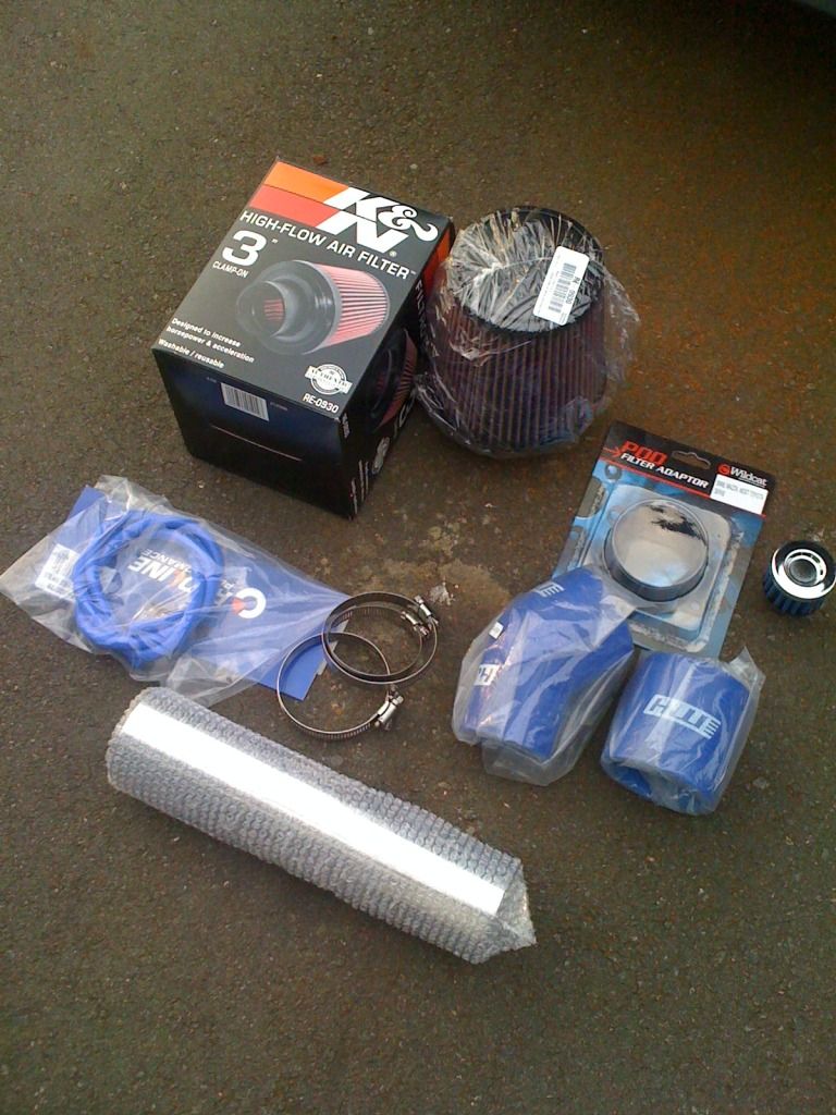

Not much of an update but I have been doing a few things, next on the list is to sort out the induction again and replace my cam covers, whilst doing that polish up my manifolds for the induction and change the spark plugs over.

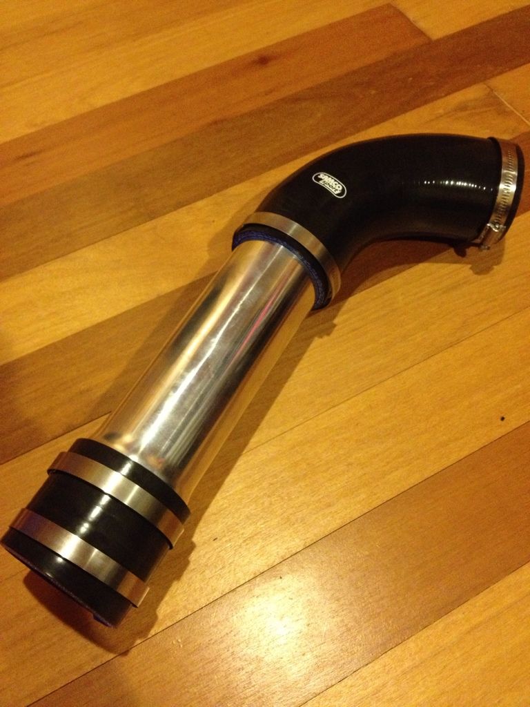

New bits and pieces which I'll need to look into, alloy pipe needs a 15 degree bend to fit correctly

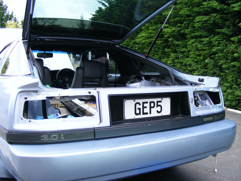

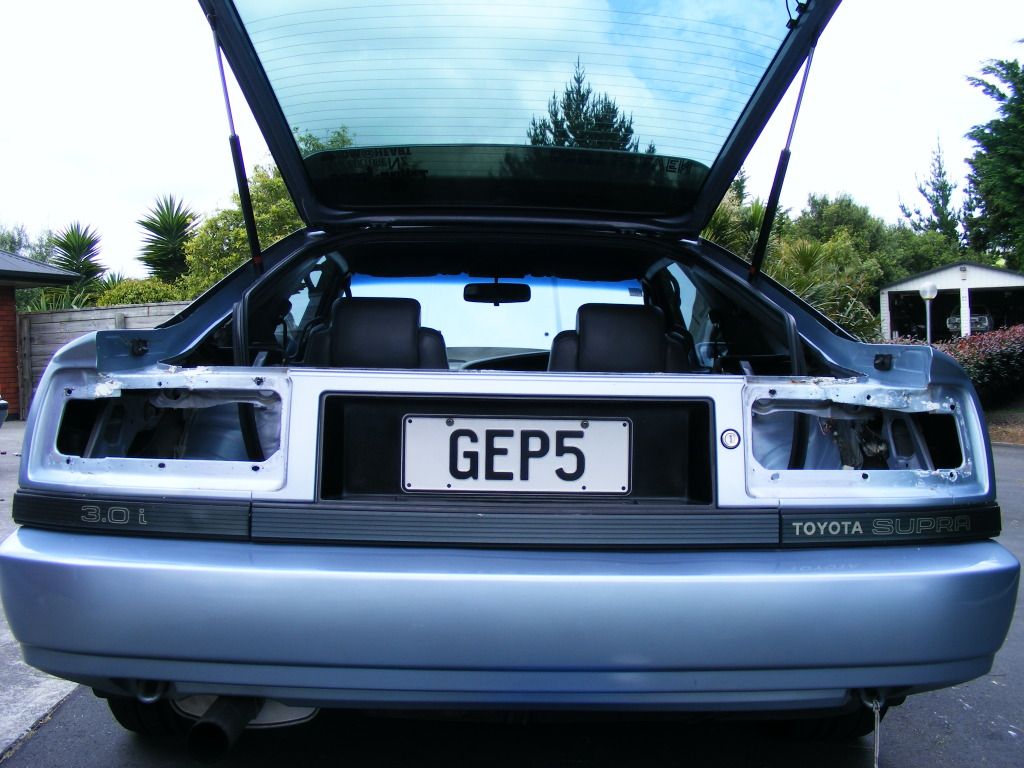

Had a crack at fixing the famous mk3 supra hatch leak, mine wasn't very bad but enough to get to me so here is what I did,
First I lifted up the boot seal to make sure there wasn't any bad bits where the water was getting in, all looked good. Removed the tail lights to find gaskets with a little bit of what seemed to be non setting sealer, so cleaned that away back to metal on both sides and they were surprisingly clean, replaced the gaskets and got my tail lights back on and the same with the boot trim.

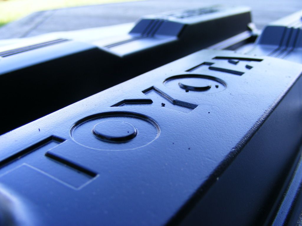

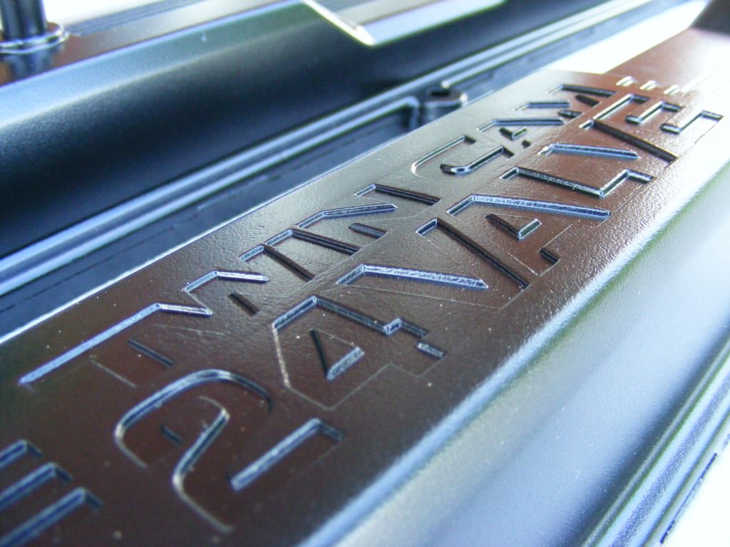

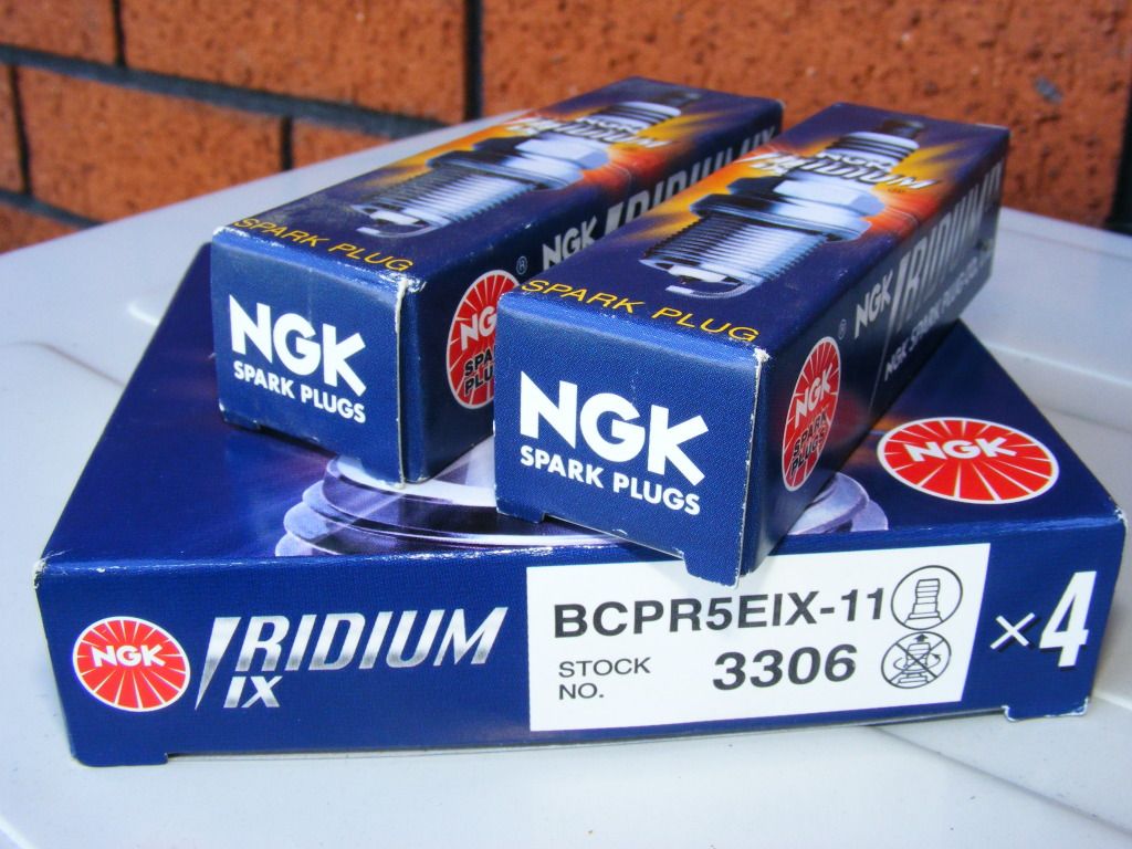

That didn't take too long so my father and I got stuck in to replacing the spark plugs and the cam covers which have been waiting around for a long time. Replaced the gaskets also, cleaned up the manifold and the throttle body which awaits to be put back on as I need to replace the 12 cam cover bolts, thinking stainless allen key bolts which I will have a look at after work tomorrow.
Was surprised to find the spark plugs at $42 each and platinum ones at $50 each thought that was a bit steep.
Thats expensive, they only cost 32$ over here and i can even get 40% discount on them.

Must just be the car I assume, the other few cars I have owned were around $7 each.

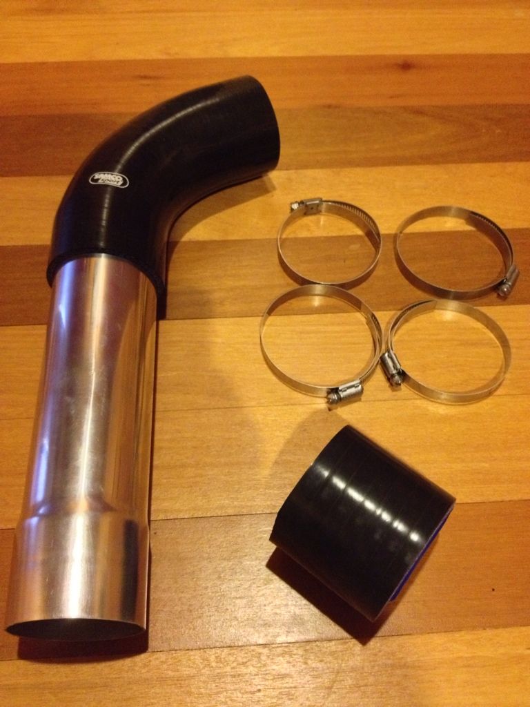

Tomorrow I'll be picking at a few parts from Samco for my induction, 60 degree 3" and a coupler for the AFM I plan to bracket off the strut mount. Should also have a few other updates soon.

Today was successful, Samco 76mm 60 degree elbow, 76mm straight with expanded AFM side end, 81mm Samco straight for the AFM

I managed to install my new parts AFM to throttle body this morning will get some pics up when the weather clears, leak in the hatch area wise it's dry so I'm very happy.
