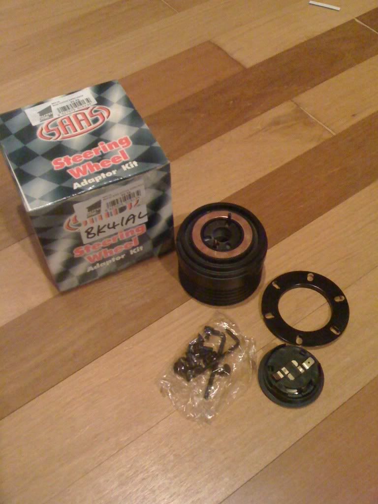

Hi all, today after a very long time tracking down the "correct" hub kit for my steering wheel I decided to go pick up the "correct" hub kit after work today.
The hub is not so correct after all, disappointing really.

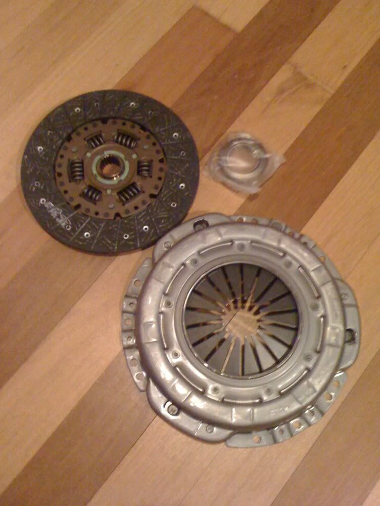

On a much finer note my new clutch came in the mail which I will install sometime soon

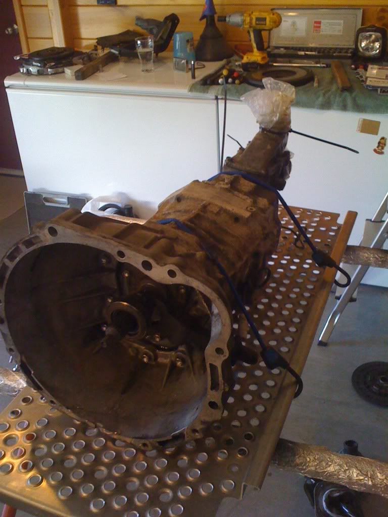

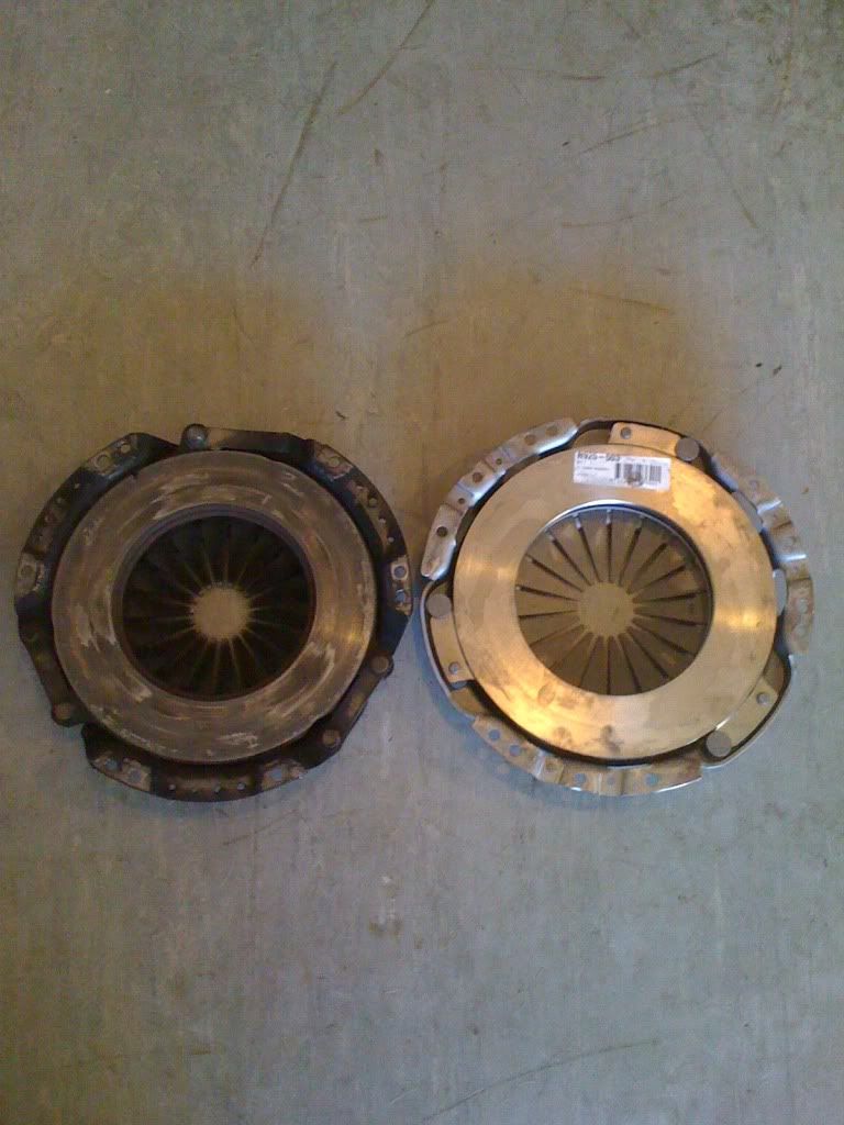

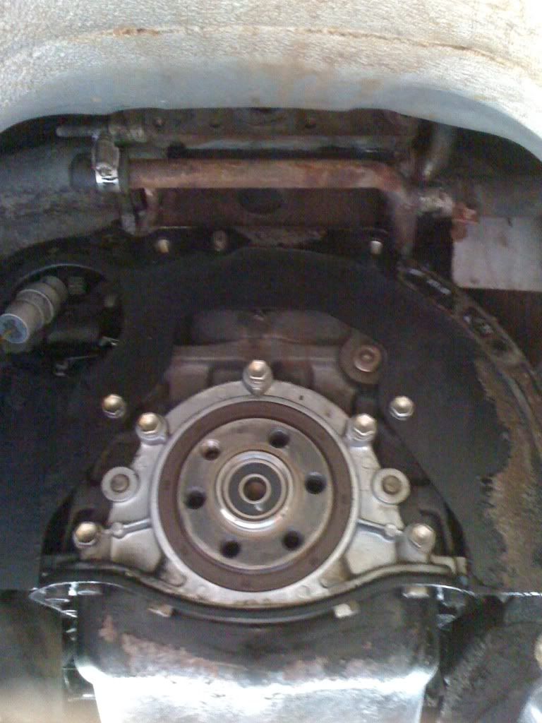

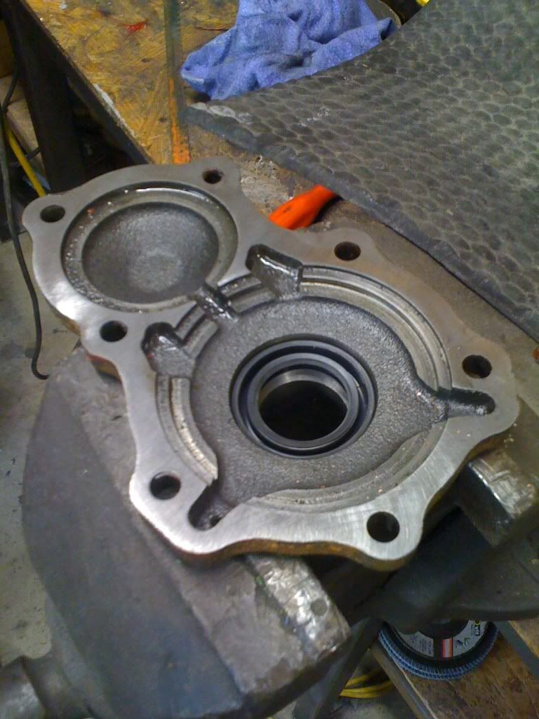

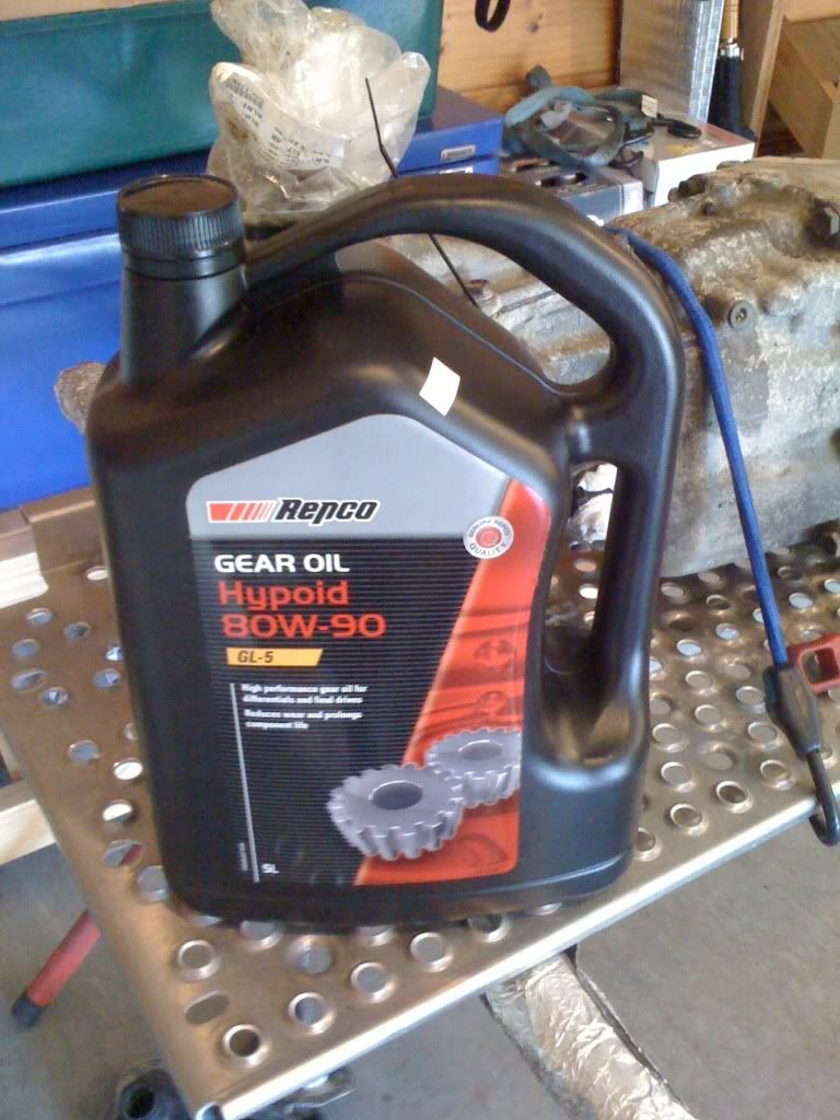

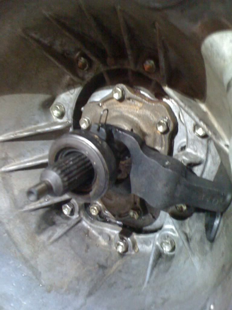

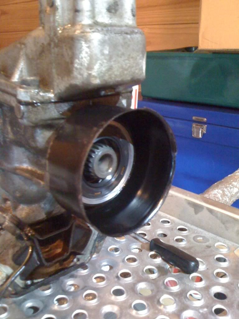

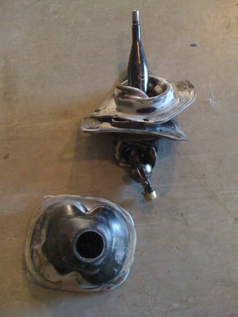

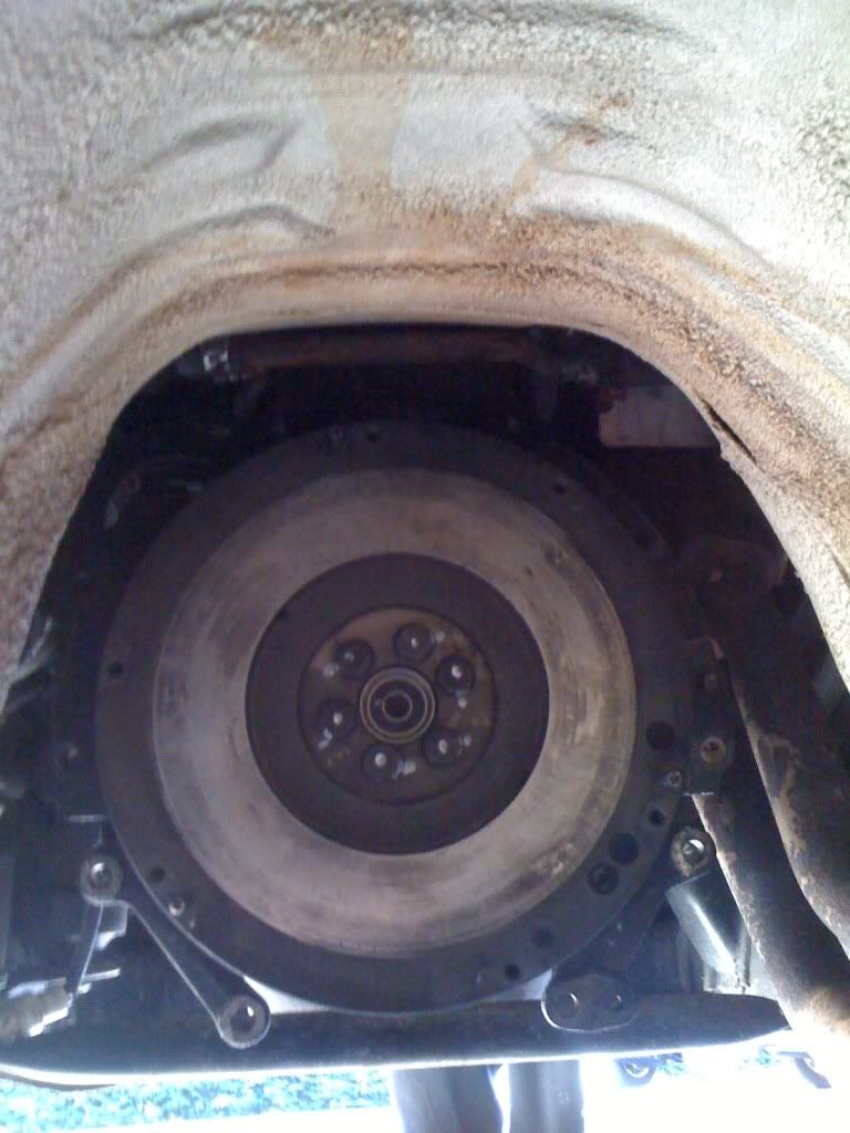

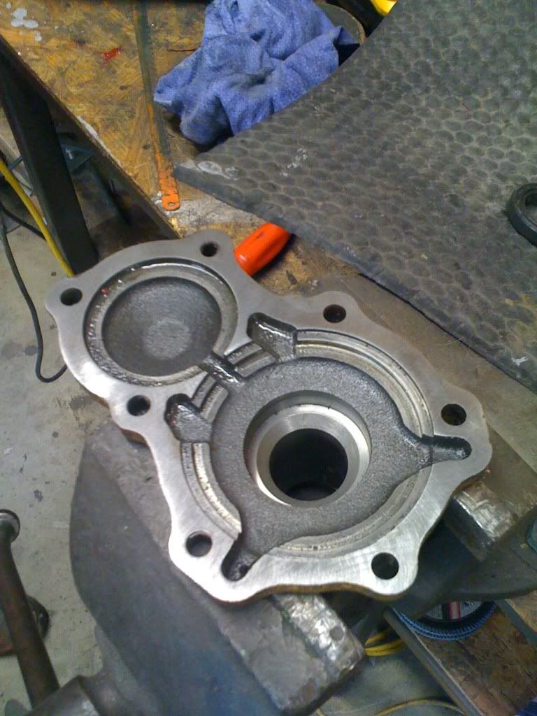

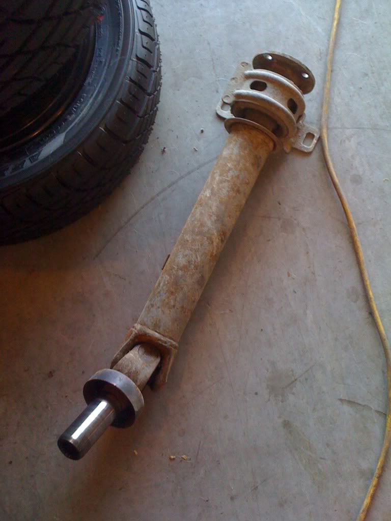

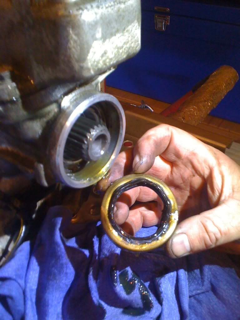

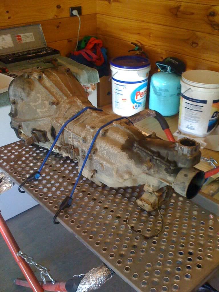

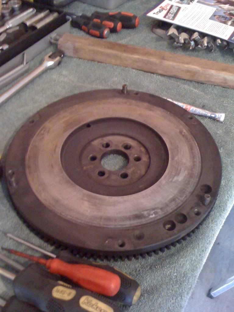

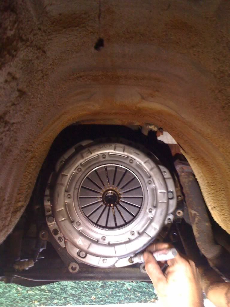

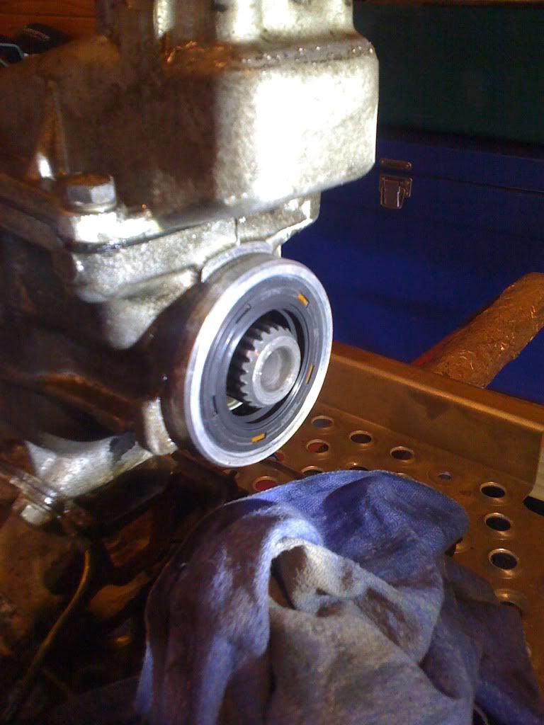

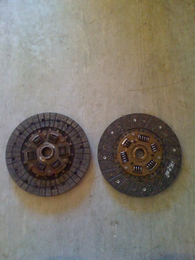

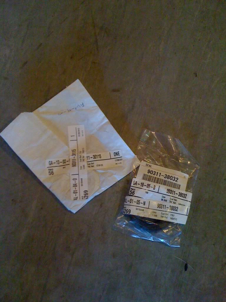

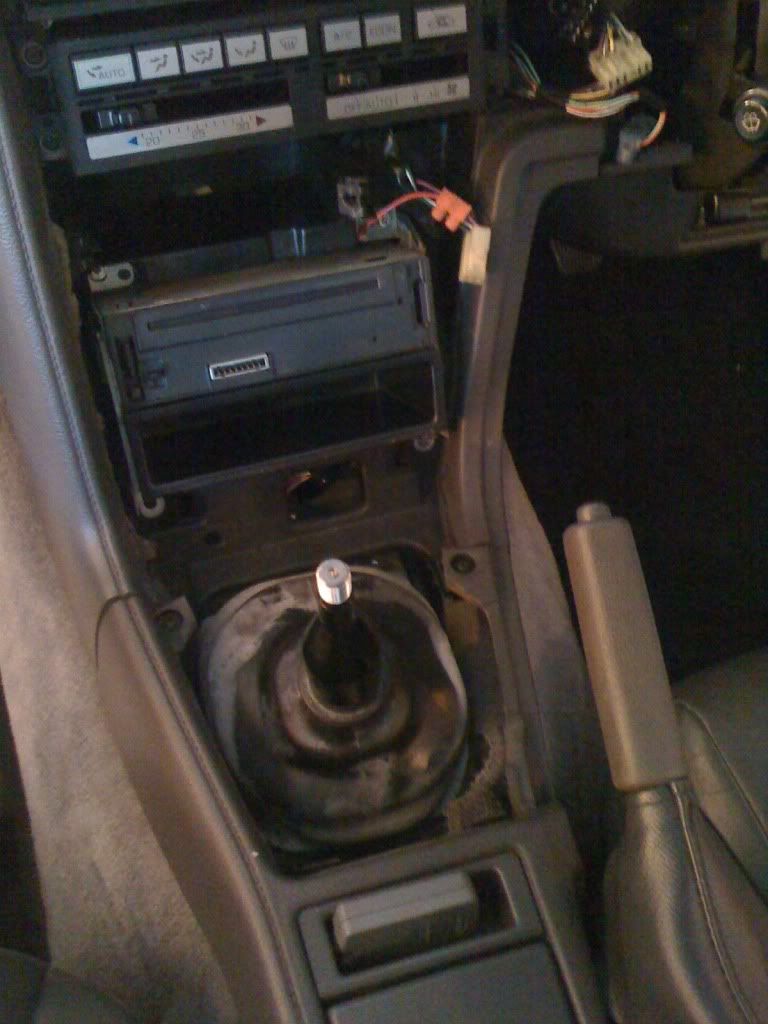

Hi everyone, was a really big day for me today. Replaced the clutch, gear box gaskets/seals/oils I still have a bit to do in the morning thanks to my dad and his mate Dirk for all the help. Here are some pictures
First job was in the inside of the car
Few pictures before Dirk arrived this morning
He arrived and the work got started, gear box work
Clutch work
More to come, need to do the rest tomorrow, thanks

Very nice, is transmission work difficult? Like replacing the clutch and pressure plate compared to a head gasket?
ryansmith
Mar 25, 2012
541
New Zealand
Well in my honest opinion, everyone just says, yeah it's easy - no hassles.
Well i'm just going to be honest and i think this is the reason the forum is here, to help each other. As some people may be ashamed in saying the job is hard. First off, the starter motor needs to be removed before you do anything which isn't the hardest job, pretty straight forward just very tight to get to. the interior components are very easy to take apart and even easier if you have the workshop manual. The hardest part I found was getting the left hand side top (passenger side for me as we are right hand drive) gear box bolt out. Other than that it is just awkward getting the drive shaft out, well was for me as remember this is my first supra, and basicly the first time doing proper maintenance on the car other than servicing.
The seals are VERY easy to come out which I was very happy with, but other than it is is quite straight forward, just take your time and make sure you know what your doing and what you will need prior to starting. That's what I didn't do and ended up driving around trying to find seals and gaskets. But good luck ask me any questions if you get stuck.
And yes, we all knew what we were doing. Just never had any of us done the clutch on a supra.

Cheers, took quite a while I'd say close to 10 hours but I now know what to do if I ever need to do it again. Shifts great the change is unbelievable but for now the supra is off the road as the clutch master needs replacing, noticed it was very slowly leaking onto the foot rest next to the clutch pedal inside of the car.
