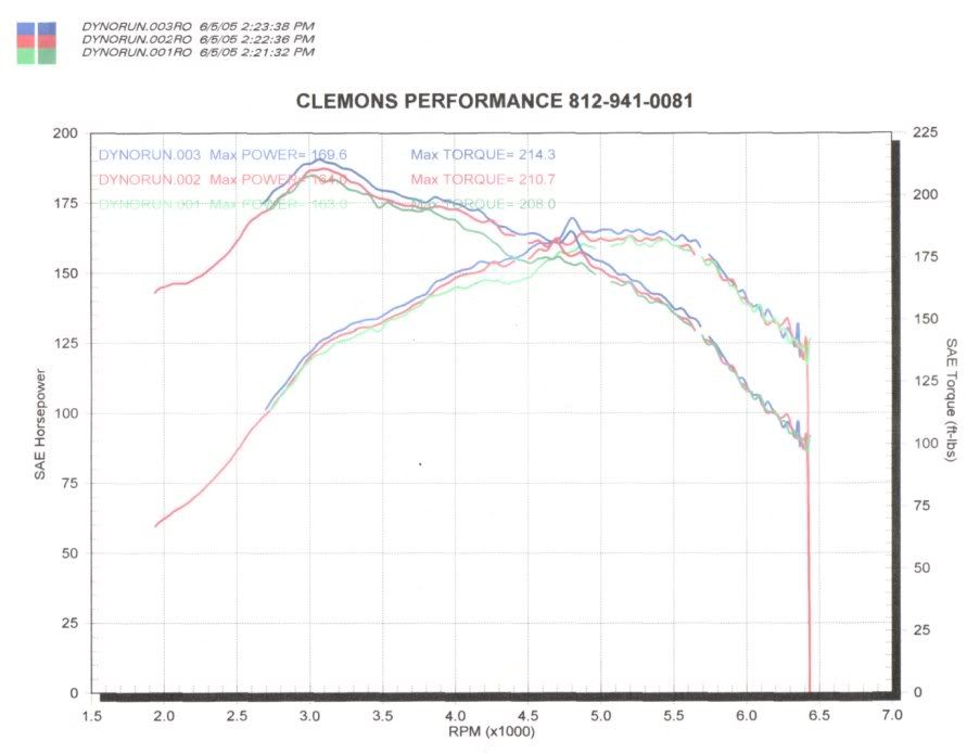

ehh go ahead and post it up someone might be able to help you out...some guy posted a stock mkii dyno sheet once...that was kinda funny.
Yup, stock MKII dyno sheet... that's probably about what mine looks like. :icon_roll
