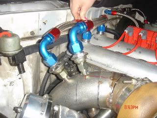

SevenMKIII;964525 said:
No slash-cutting for wesbeech :momaru:
I know a decent amount about venturi action (for water systems anyway). There has to be some sort of a special cut (slash) in the pipe for it to venturi and create suction. Or a combination of a slash cut and the proper angle into the main flow pipe. Those seem to be just welded in at a 90 degree angle to the exhaust, and if there is just a straight cut on the end of the pipe in the exhaust, I really dont see that pulling any vaccuum at all. If anything, I'd bet those check valves just stay shut 100% of the time. Have you ever put a vaccuum gauge on there to see if it actually pulls vac? Not trying to be an arse here, I just don't see that actually working, and I'm curious if there's more than meets the eye.
