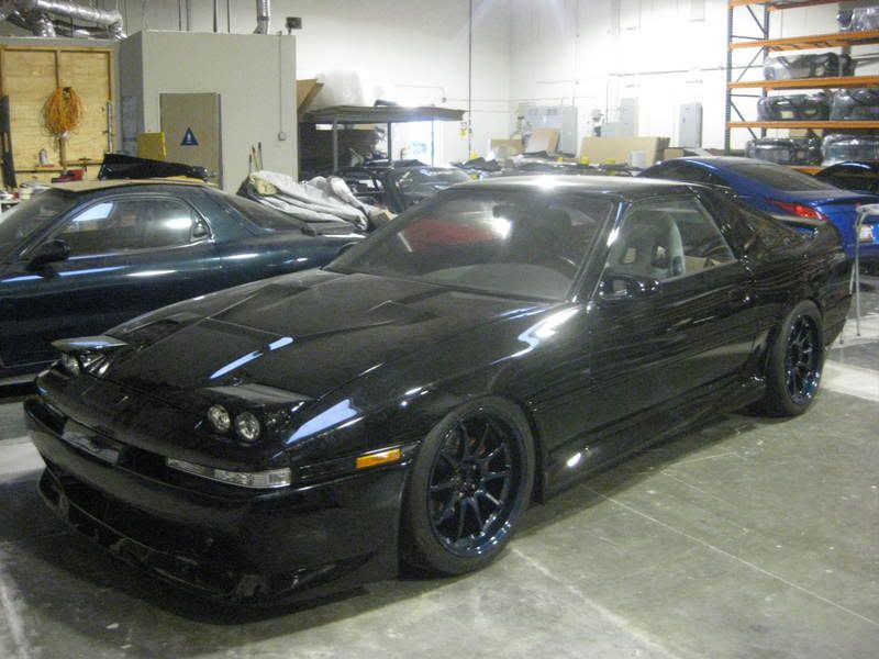

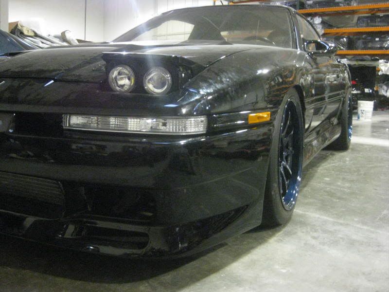

Let's see pics of each of your setup.

Good points, Nerf. The Hella 90mm are the most simple lights to use for a quad projector conversion.
My bezels are not complete. Check this out, people.
http://www.supramania.com/forums/showthread.php?t=100616
