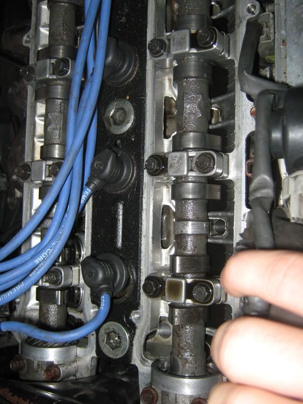

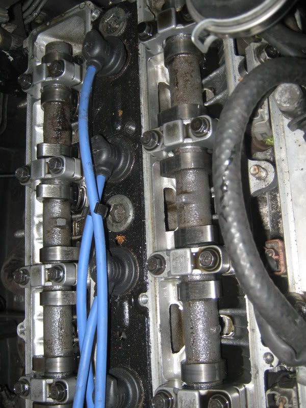

it seems like there's a majority. I have pics of the valve covers off and everything and close up pics, I probably wouldn't be able to spot if it was cam caps. I mean, they looked right.

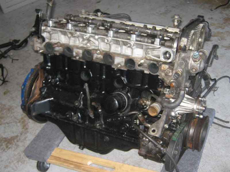

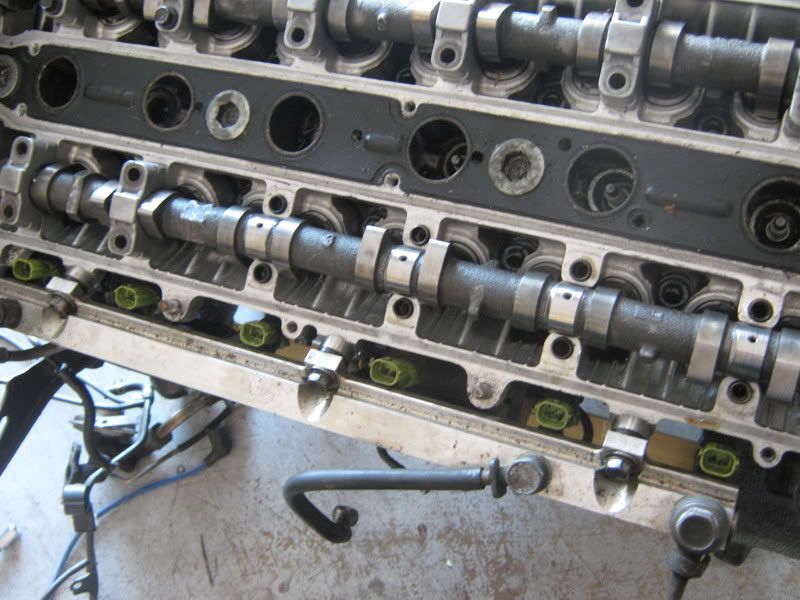

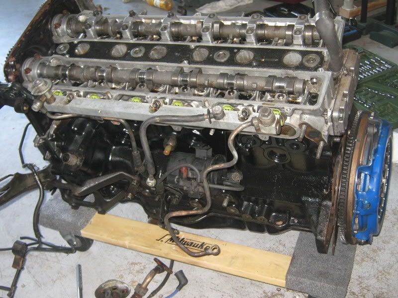

First pulled Very first two pics when first opened
Very most recent pics, that's where I'm at. (bottom 3)

How many miles on that motor? Looks like it had been rebuilt not too long ago due to the shiney paint on the block and clean head on the outside.
