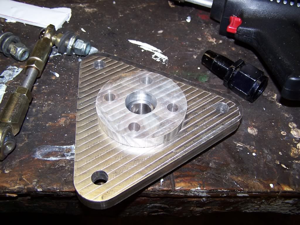

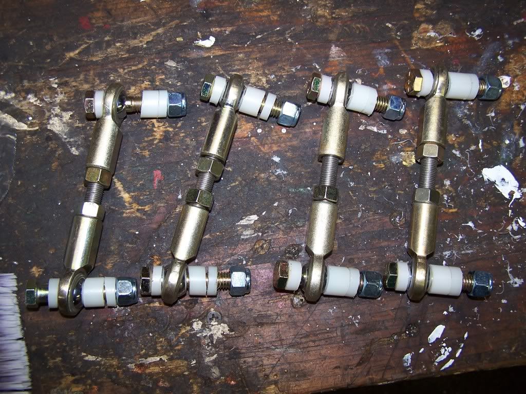

updates. car is being reassembled. i am waiting on some upper mounts im making on a cnc and then the front is ready to go back together. the rear i am waiting on two bushings from toyota. I also have remade my sway bar end links and reinforced the rear sway bar mounts since one was already cracking.

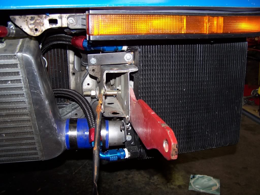

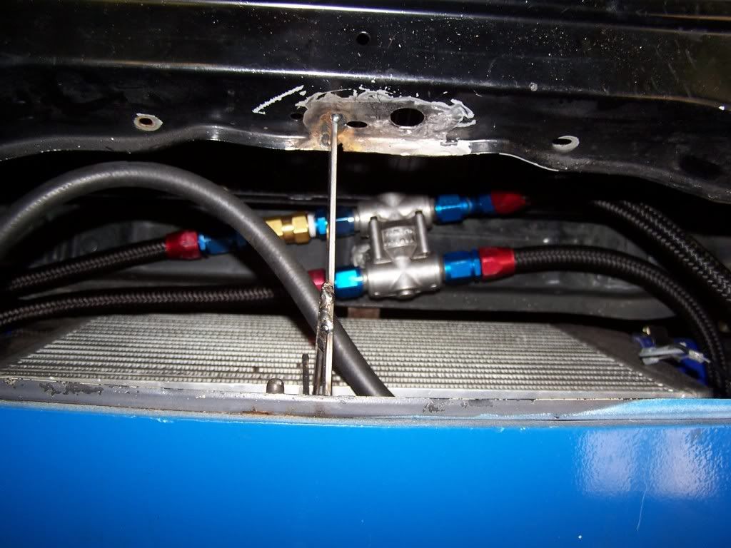

The bushings for the rear uprights came in from Toyota. Rear end will go back together this weekend. The oiling system will also be re-plumbed this weekend. I need to take some pictures so hopefully there will be some good updates next week.

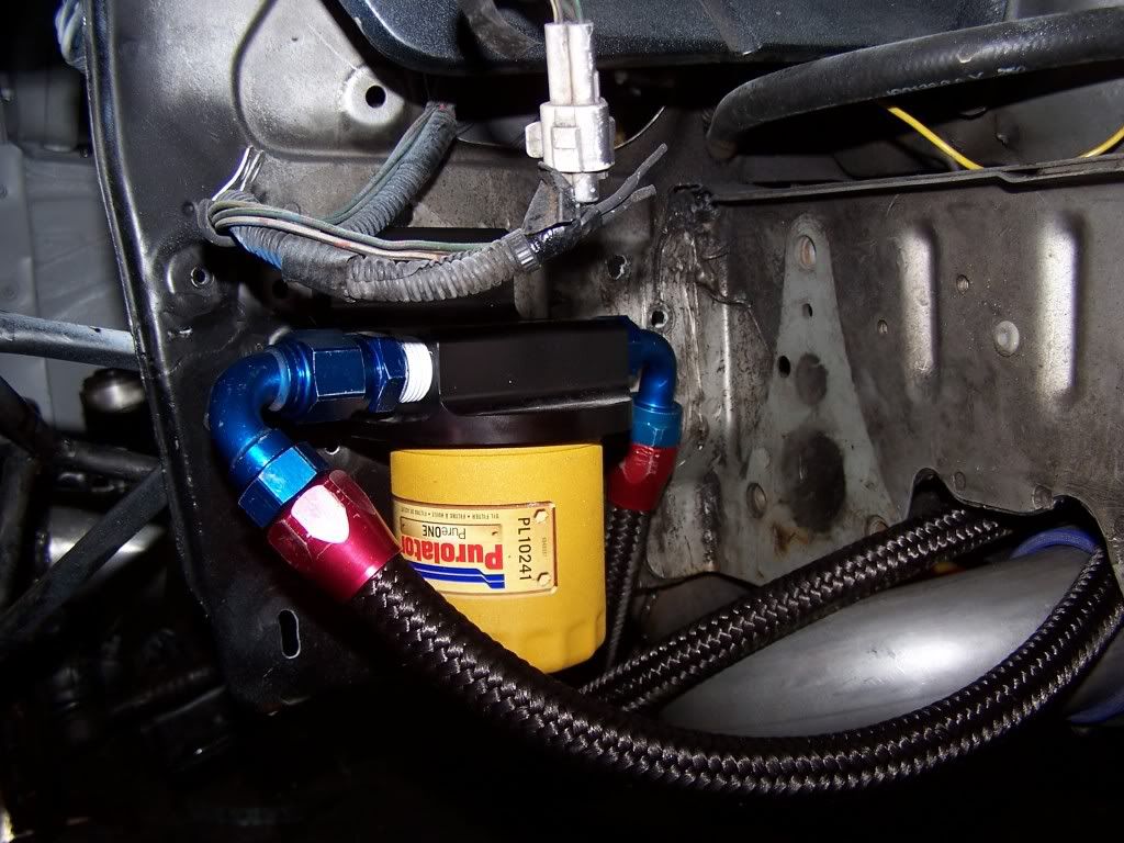

also summit racing now carries canton racing products so no one should ever have issues getting a oil system on their car anymore here is what I am running now.
-10 mocal oil thermostat
http://www.summitracing.com/parts/CTR-22-625/ billet canton filter mount
you don't need this crazy mount but do not run the cast permacool mount it will leak or crack
http://www.summitracing.com/parts/CTR-22-595/
this is the oil filter adapter by canton. I strongly recommend this piece. It gives you the best clearance to the exhaust manifold, and on stock vehicles the best clearance to the lower intercooler pipe.
http://www.summitracing.com/parts/BMM-70274/
this cooler is to big for street cars. however this product line has some really nice coolers at good prices in lots of sizes

UPDATE:

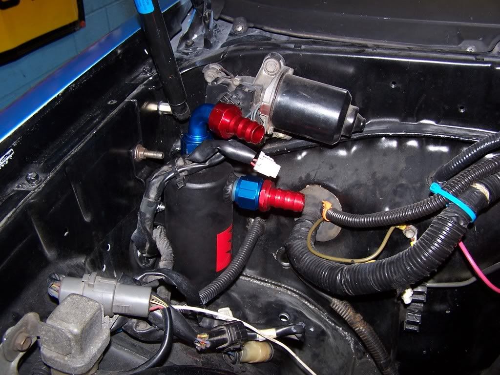

New sway bar end links are finished. see pictures below for the old and new endlinks. My suspension upper mounts are almost finished. I have done a minor redesign and have to remill a couple pieces before they can go on the car. The second oil cooler is removed and the system is re plumbed. A new catch can with more volume and -12 fitting is installed.
