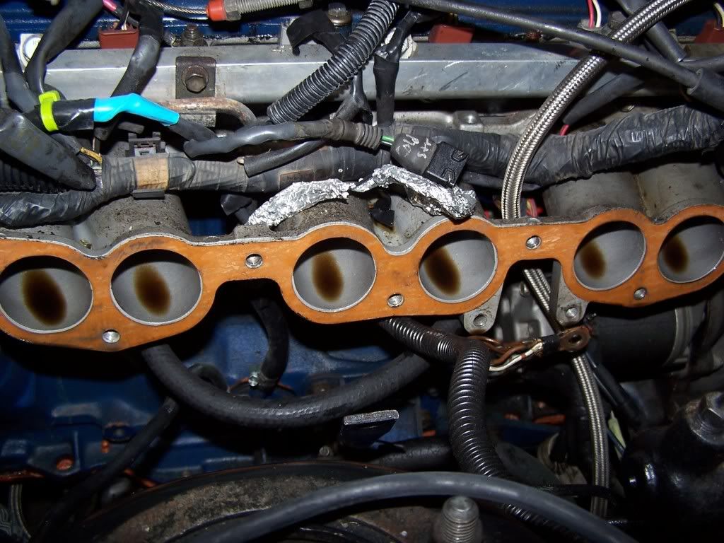

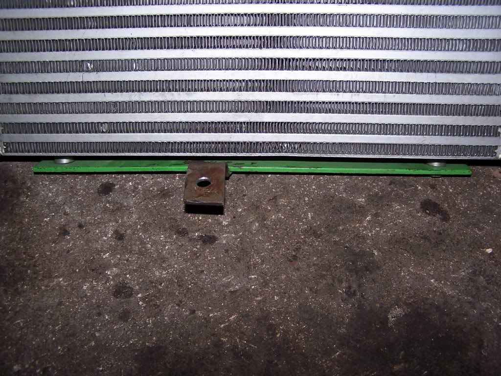

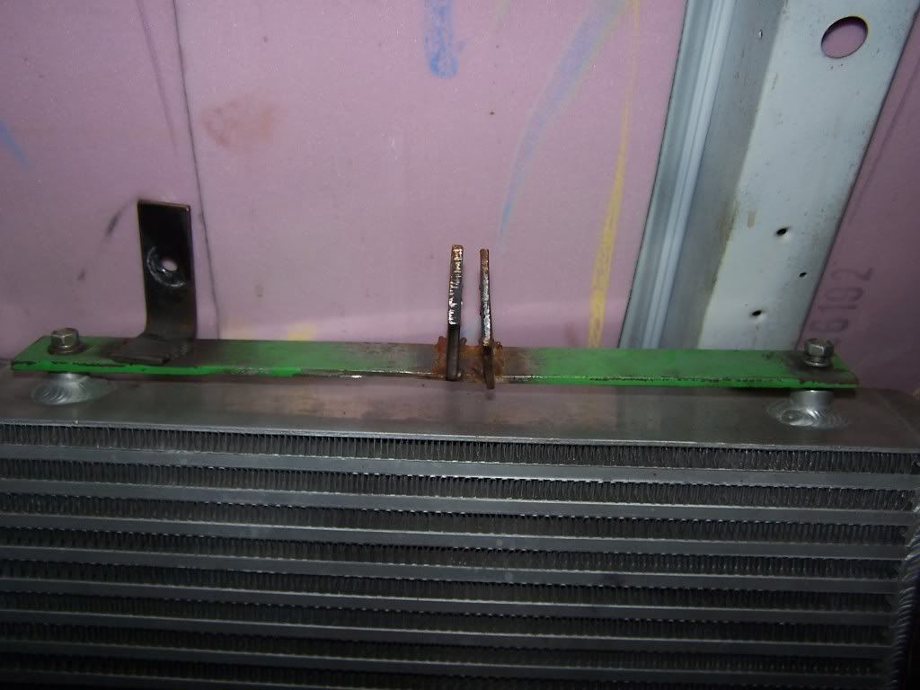

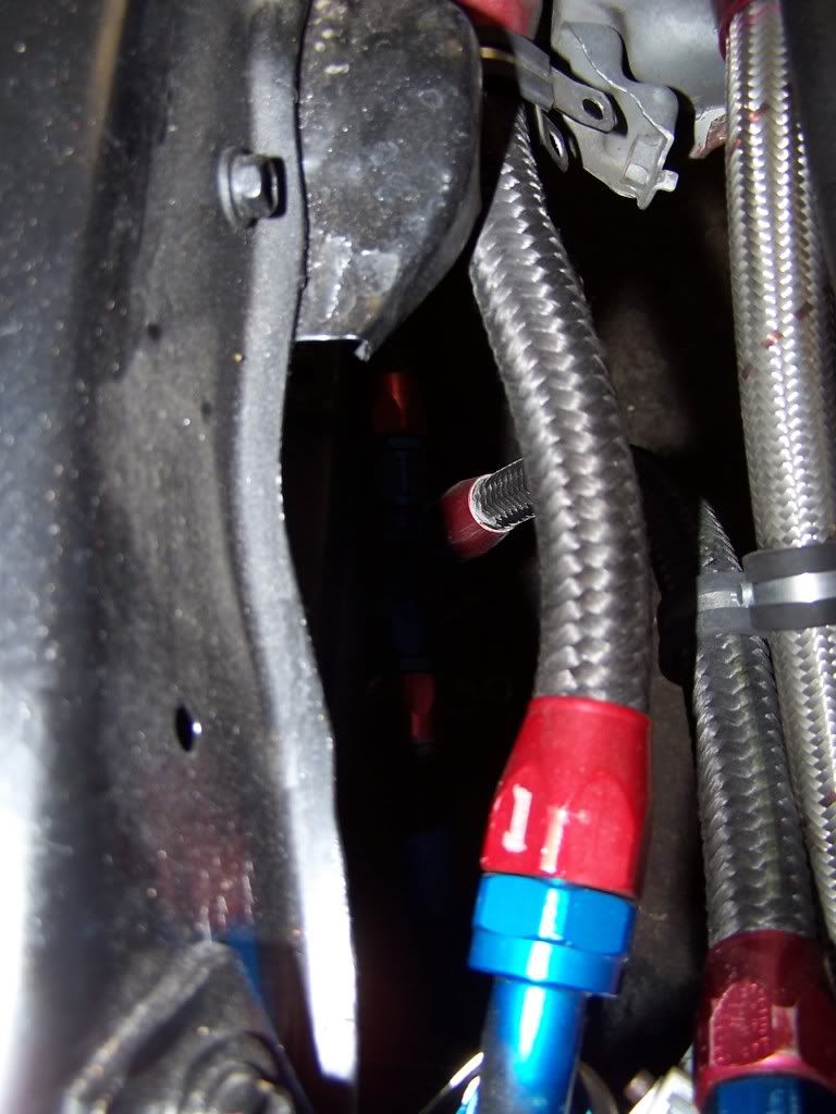

This is just a thread to document some of the changes I am making to my car for the winter to get it classed and to fix some reliability issues and most importantly get the weight down. there is going to be a ton of pictures most without descriptions so if you need something clarified just ask or just try to figure it out. my goals this winter are to remove the FFIM and go back to stock manifold layout. Im also switching the intercooler out with a smaller stock style intercooler. also i am removing the smaller of the two oil coolers. all this is an effort to save weight. also the fiberglass bumper will be removed and a stock one fitted in place. ill update this with more pictures as time goes on.
feel free to ask any questions about the car or about racing mk3s in general. ive been racing supras for over 5 years now so i have run into alot of the common issues.

instead of changing the ic and intake manifold setup, why not just switch over to aluminum piping?

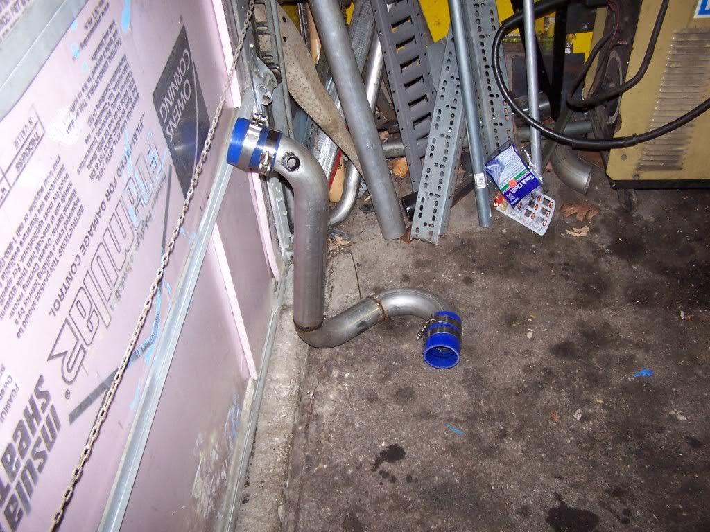

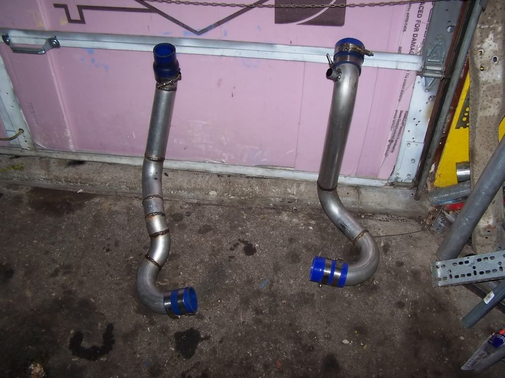

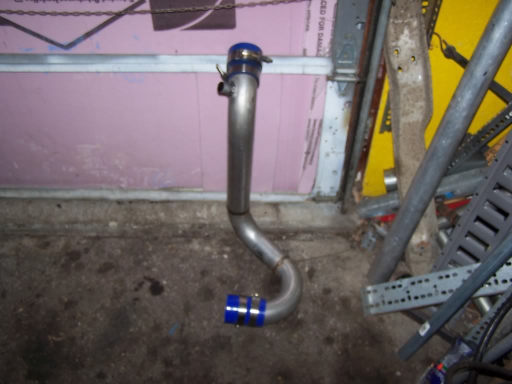

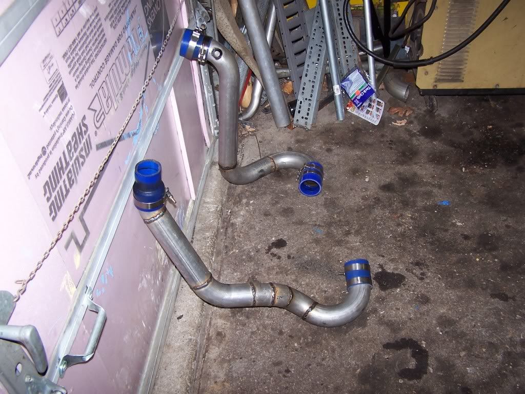

The class i run has a power to weight limit. running a modified intake manigold costs points which increases the minimum weight of my car. therefore anything on the car that does not give me significant weight gains is coming off. naturally switching ICs comes with switching the manifolds. i dont have a tig welder yet and done trust any shops to touch my car so i made my ics pipes out of U bend steel because it was the easiest.
Also one thing to note is any one building a race car, have as few couplers as possible. my setup only had 4. i am considering running V bands next year. I should have a tig welder as soon as a graduate next may so my pipes will start steel next year and switch to aluminum part way through

Looks like a modified 7m intake mani blown in from one end.
wouldn't that create uneven flow to cylinders?:1zhelp: you might be better
off going stock.

pretty common mod a couple of years ago i belive sethtron was the first to do it and he did a flow test and it didnt flow horribly. i put a large radius on the bottom of the pipe to manifold area before it as finished welded so the flow has a nice smooth gradual path to cylinder one. regarless like i said a stock one is going back on.
I will be scoping the motor this week in hopes to find why I have so much blow by. Hopefully ill be able to video the scope so everyone can see

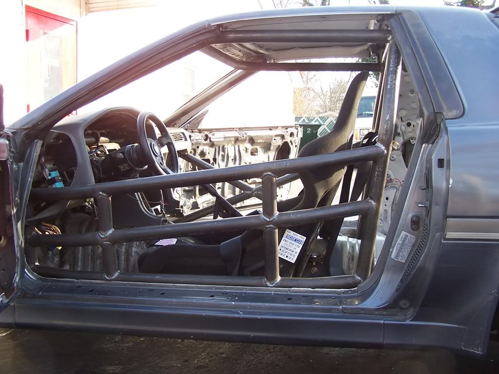

yes of course. however i didnt have a hard top shell laying around. however the targa will be welded in and all the excess metal stripped so its not a huge deal at this point. but yes you should always start with a hard top car

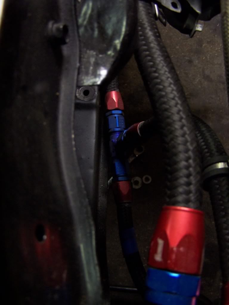

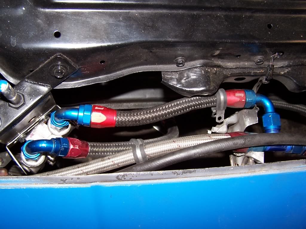

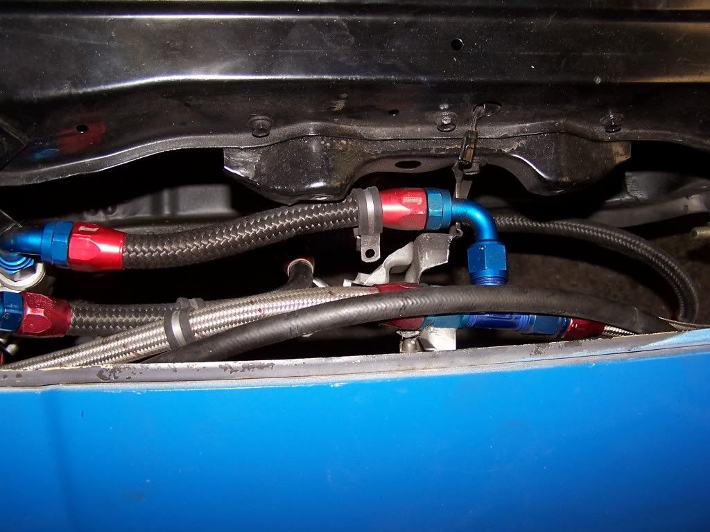

alright long time no updates. heres what happened ended up building two supras for some friends and my car just sat outside getting snowed on. its back inside now and work has begun. due to time constraints i will not be switching back to factory manifolds and such.
here is my current list of work
install front and rear poly bushings
re install manifold and intercooler
remove right side cooler re plumb oil system with new filter mount
order custom catch can from http://www.saikoumichi.com/
I am ditching the side exit exhaust setup and sending it out the back to make work under the car easier.
