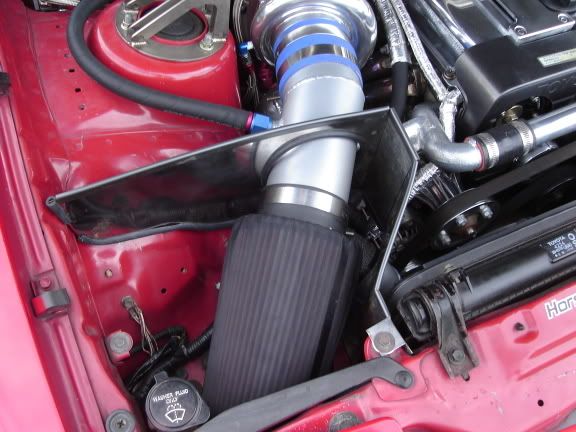

Ive got to buy a new filter too, my K&N is cracking apart at the rubber piece that clamps to the intake pipe. Dunno if anyones had that happen before?.
been there done that.one day i opened the hood to find the K&N had fallen off.it was all melted and falling appart.i felt the intake pipe, the thing was nice and warm.my e-fan's were blowing heat off the radiator onto the filter and intake.i ended up making a little shroud for the intake and filter.i never had any problem's after that and could feel the intake was cool.

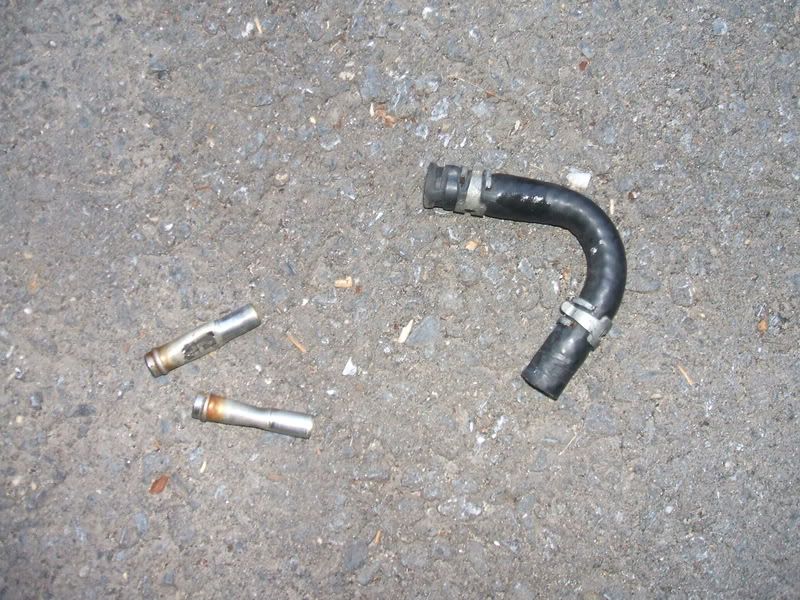

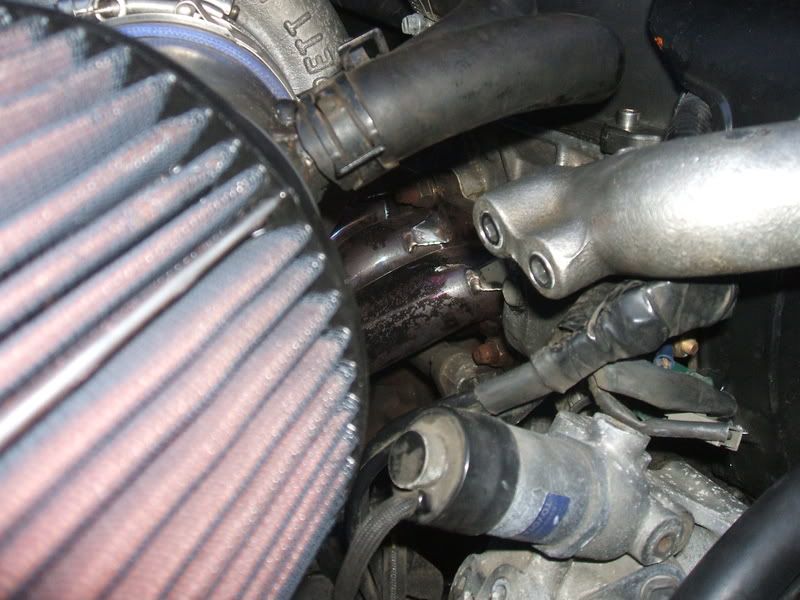

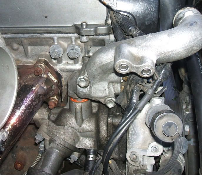

Well I finally decided to get rid of those stupid barbs on the water neck for the twins coolant. West Marine only had standard set screws so I had to buy two 1/2-20NF setscrews and the right tap. (All I have is a Metric tap and die set).
The barbs are just press fit in so I pulled them out with some vice grips and then drilled the holes out with a 29/64" drill bit. Tapped the threads, put some Teflon tape on the threads and sealed them up. It look a whole lot cleaner and most importantly doesn't leak a drop.
And all done:
