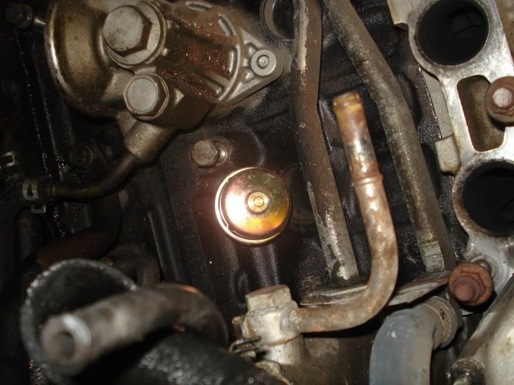

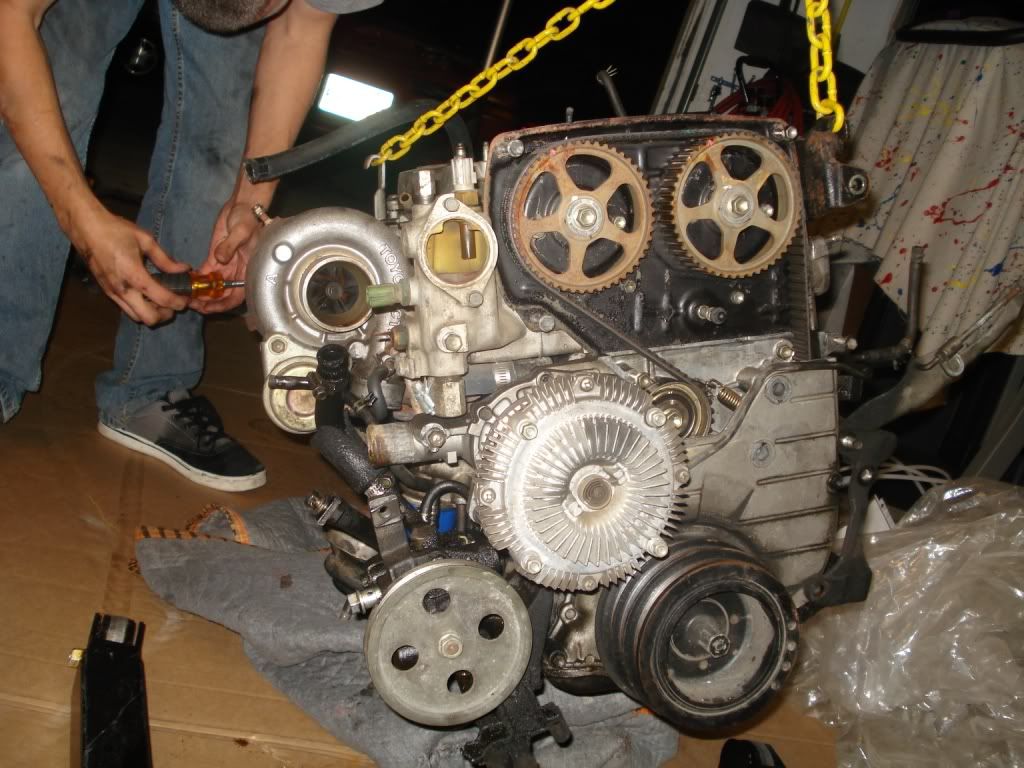

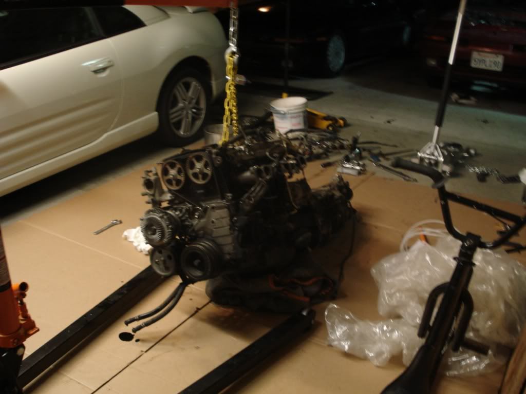

So im rebuilding my 1990 Supra turbo that i bought for $700. You probably saw my other thread... but in case you didnt, here are the pictures again!
Parts List

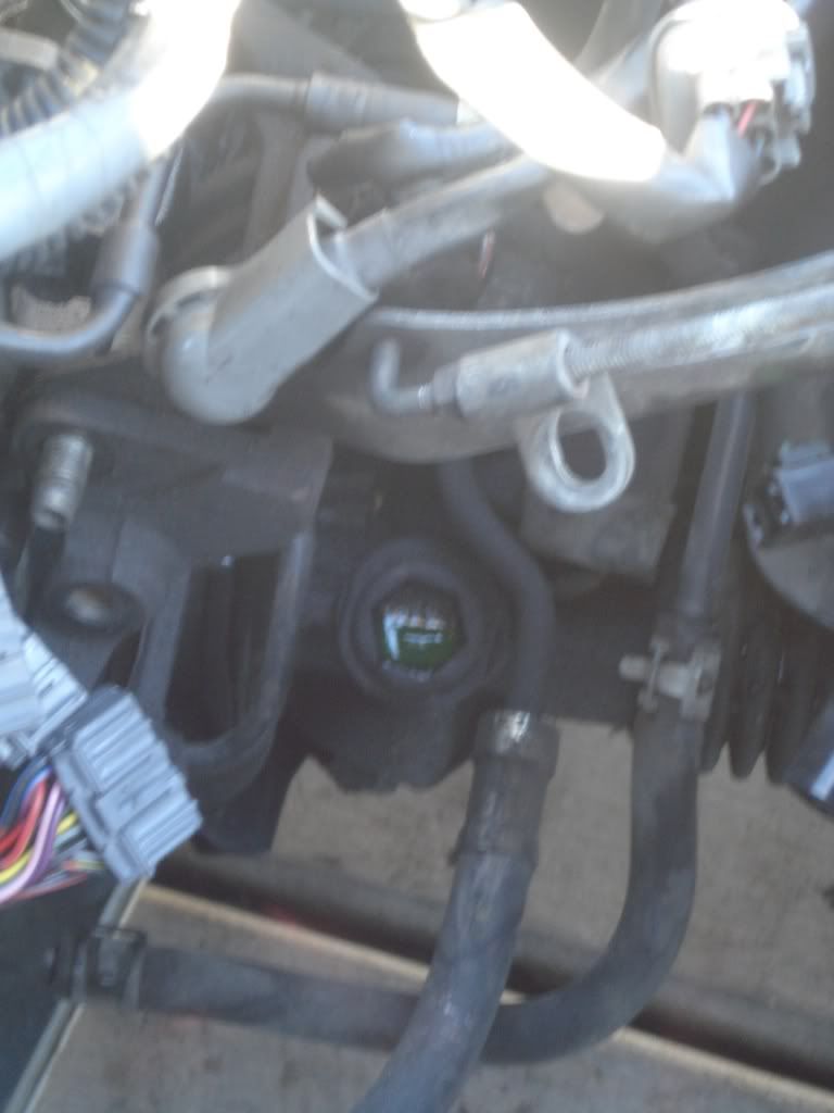

Parts that came with the car - New Starter. New Oil Pressure Sender. The engine may have been rebuilt... but i have no idea. im 90% sure its a JDM engine. Brand new OEM Fan shroud. New hoses everywhere, except for the one that was on the back of the engine that i snapped removing the engine... Newer clutch kit(if your looking for a super cheap clutch setup pm me) The rear main seal was covered in gasket maker which just means that the people who did the swap sucked at engine work...

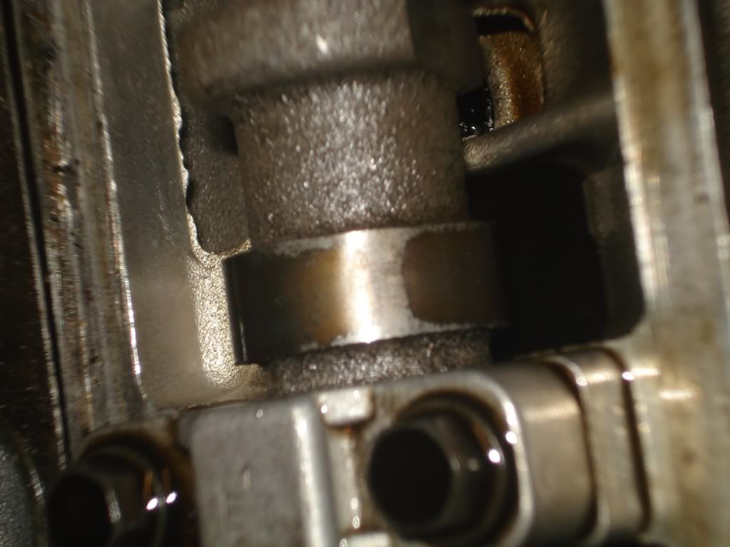

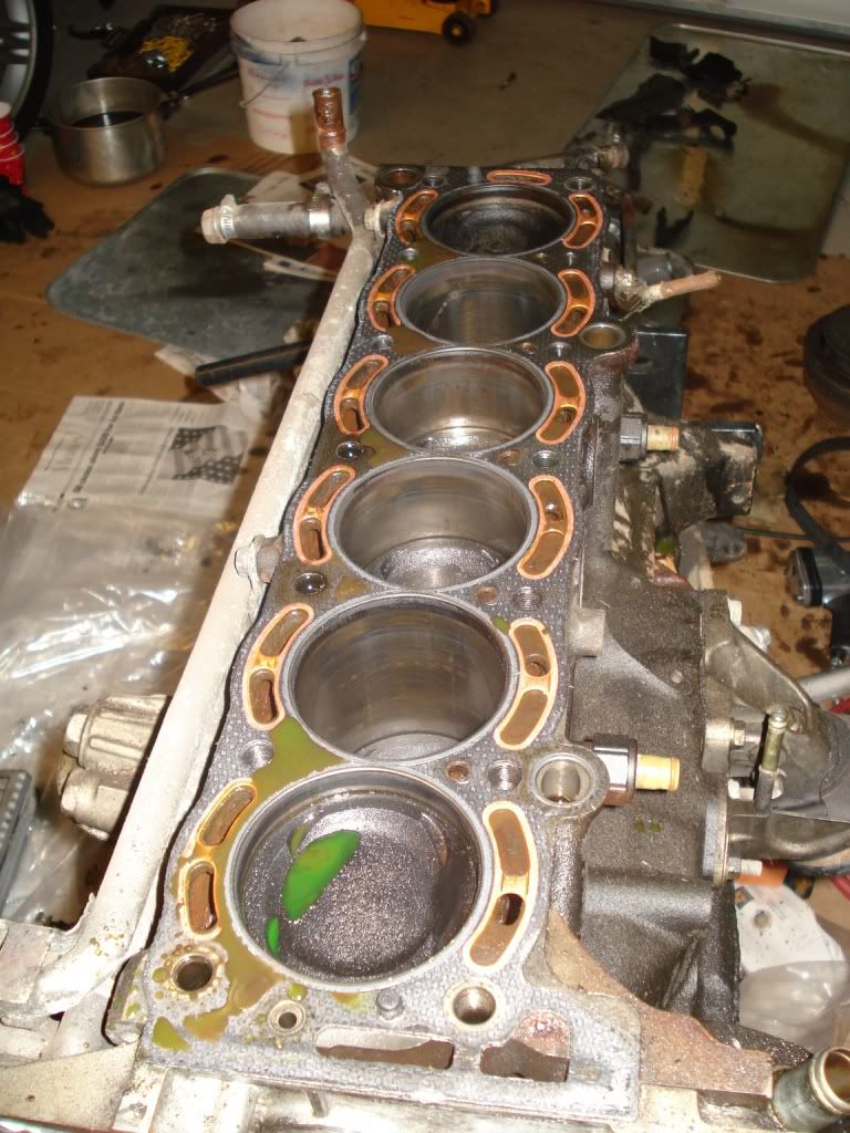

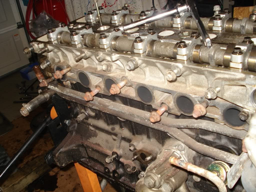

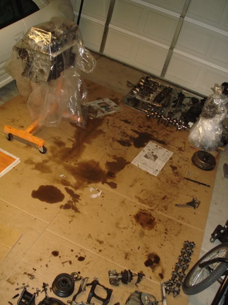

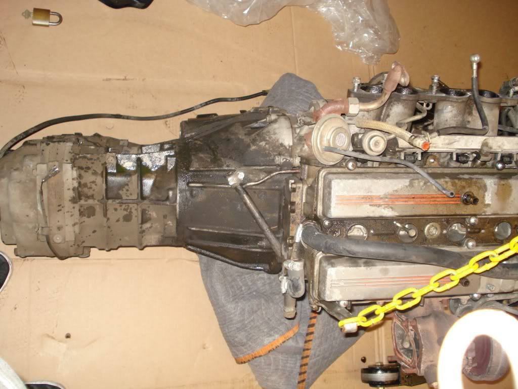

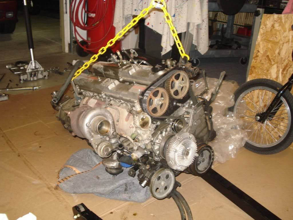

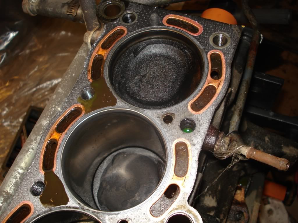

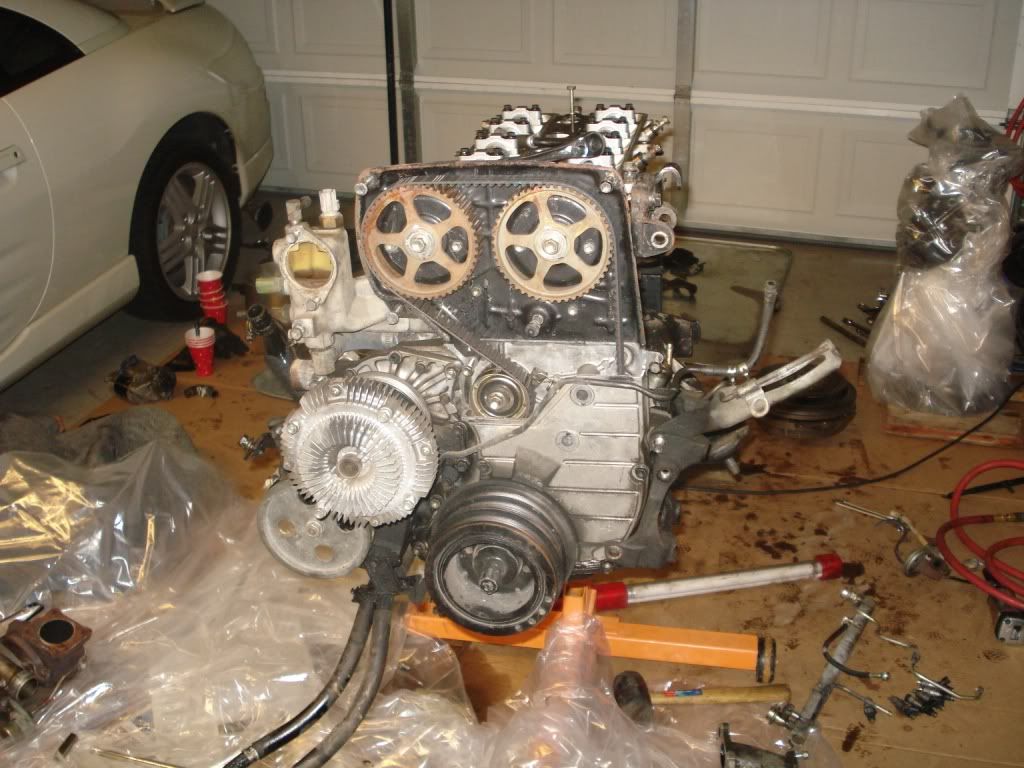

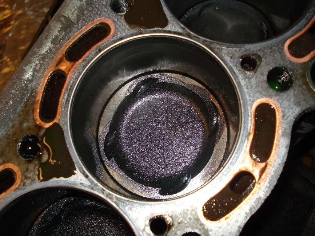

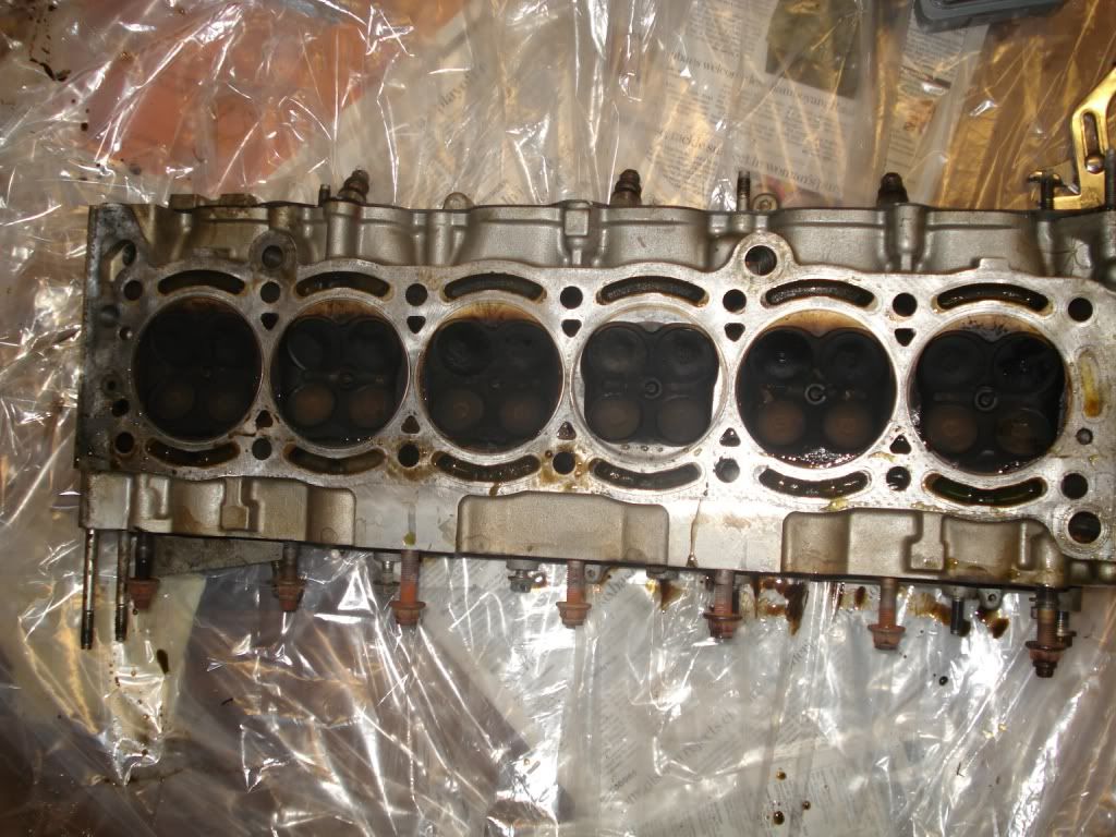

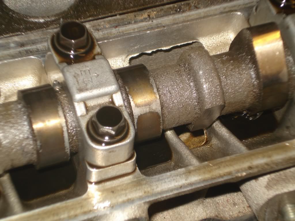

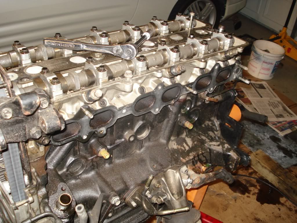

Got the head off, NO BHG what so ever... who ever did the HG job didnt use the toyota torque specs either. haha. But i do think it was rebuilt, as one of the pistons still has the area where carbon hasnt taken over....
Pictures after i get home from class.

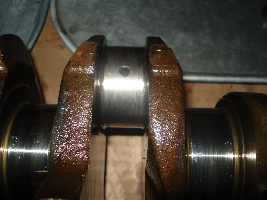

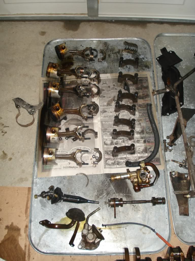

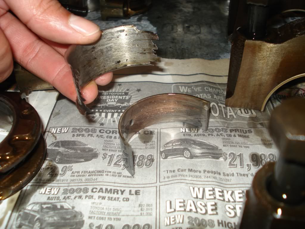

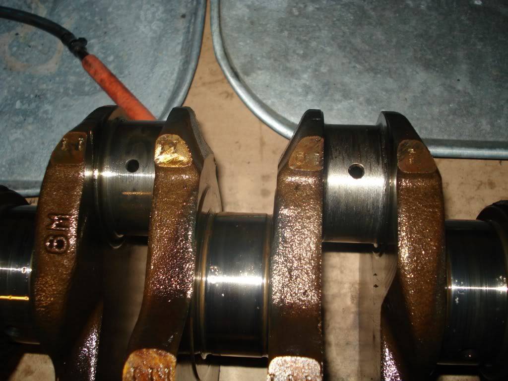

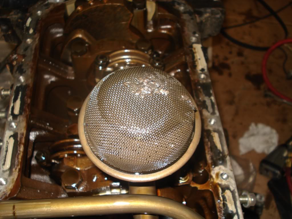

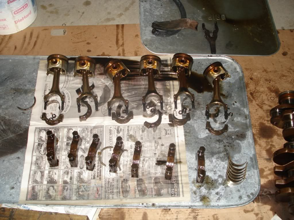

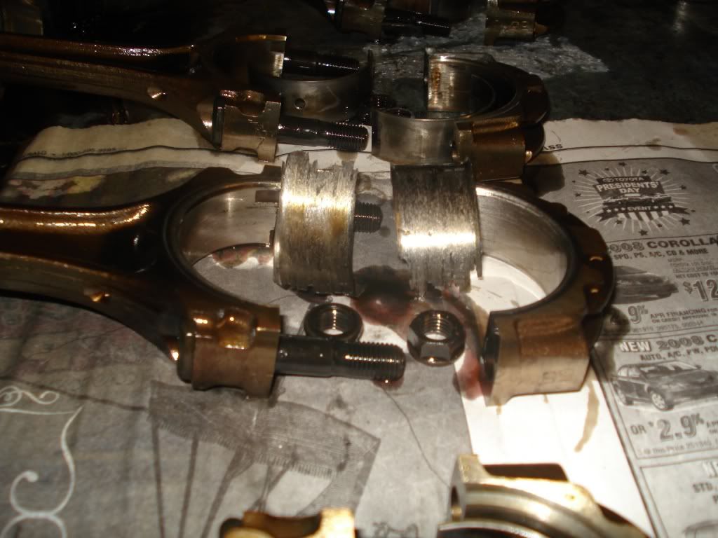

#4 was the lucky rod... and my god did it eat it... not much left, pictures of that will be up soon, and i also need a 7m crank now since mine has a fuckin 6m...
and probably an oil pump too... but yeah.

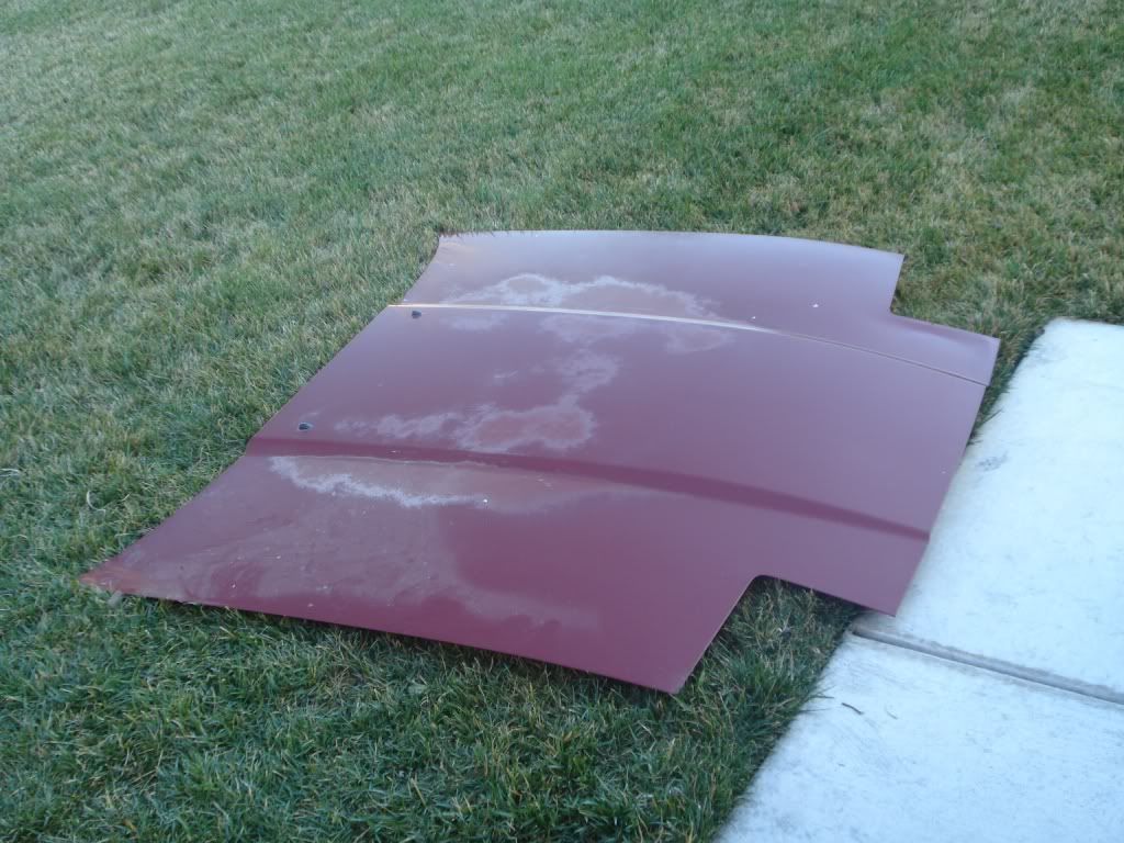

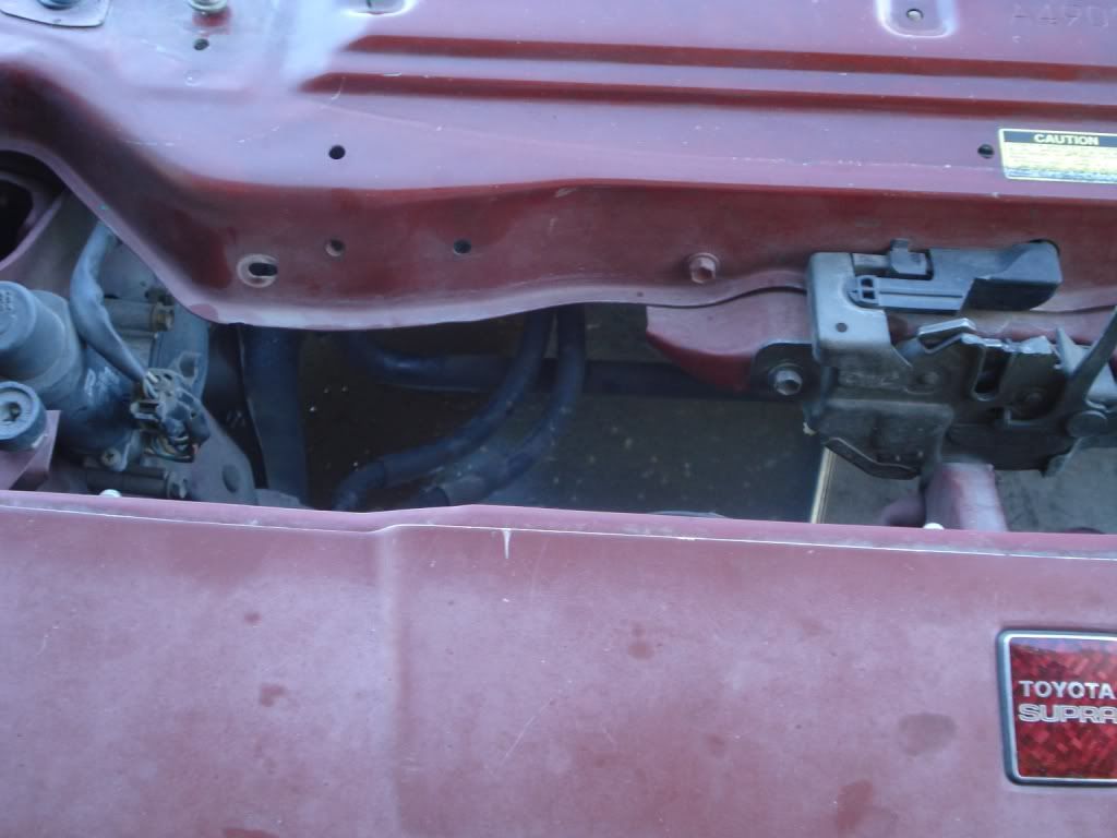

I bought it less than 24hours after i saw it on craigslist!
and the burgandy is starting to grow on me... i found a set of tenzo rims that i think would match nicely... but rims are a long way away...

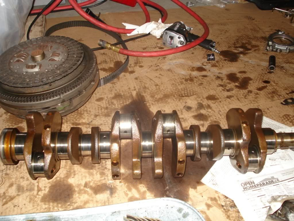

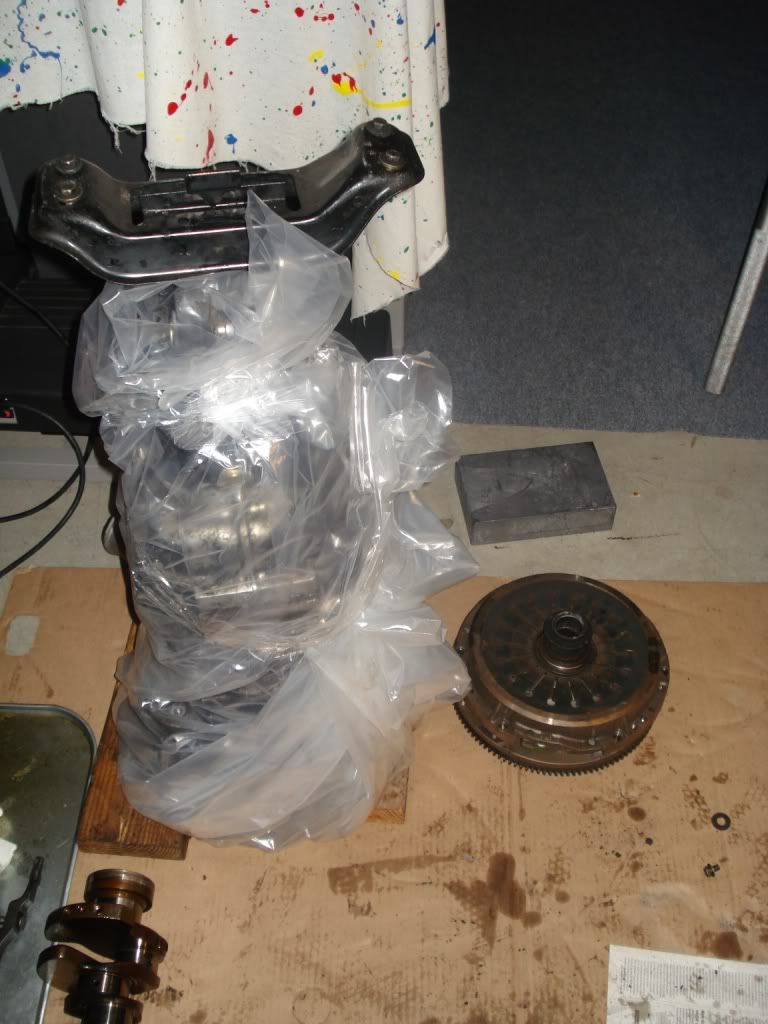

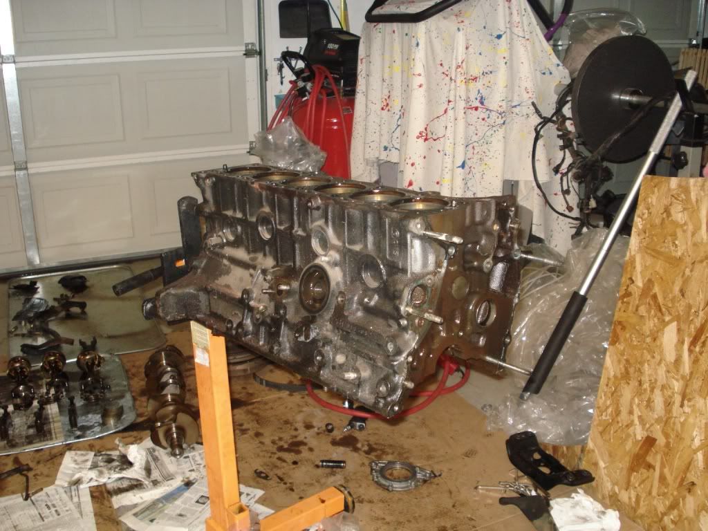

BIG Thanks go ilikecaryesido hes donating a 7M Crank to the cause! and an un-knocked one too!!! Pick it up saturday!
So now i just have to find a machinst with a torque plate for the 7M-GTE... shit....
labrat469
Aug 1, 2007
174
Alabama
At least your bearing was still there. Piston number 5 bearing was nowhere to be found on my motor. Well I did find shards of it but that was about it.
Good luck on the rebuild.

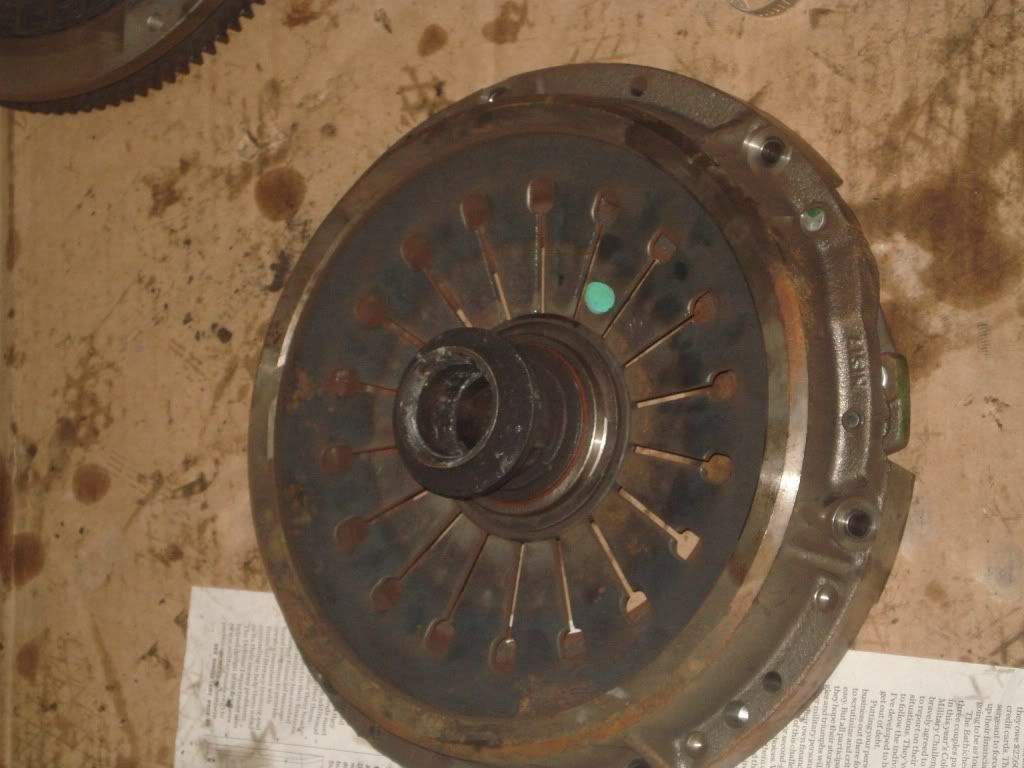

Rennat;931855 said:

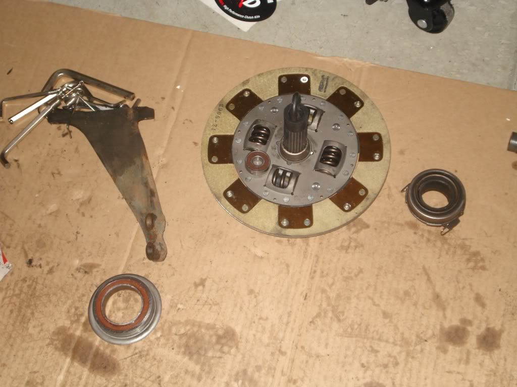

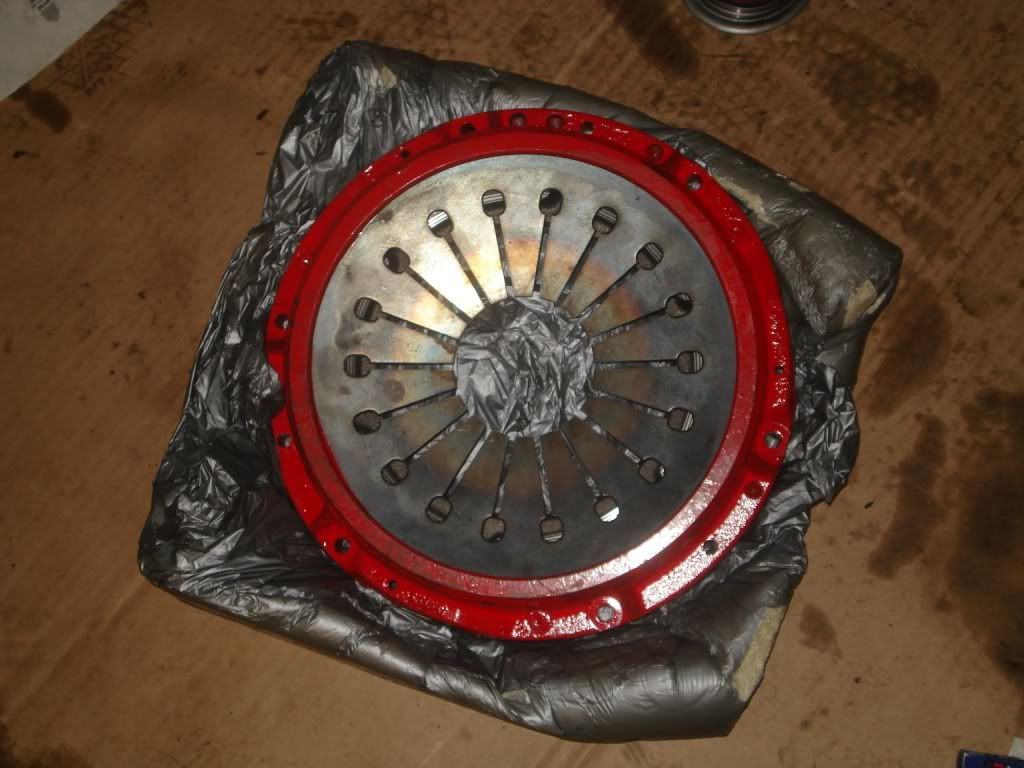

Got my clutch. And you cant tell the difference between the dxd one and the OEM one, but the dxd one has "beefier" stuff "guts" underneath...
What stage did you get? I just got my OFE STGIII, very impressed with the quality. Can't beat their prices for the holding power they provide either. Build is coming along well, keep up the good work!

This is from suprasport.com
Street Series
The Street Series kits are intended for cars that are mainly
driven on the street and occasionally at the track. All Street Series clutch kits are
are designed with full face clutch linings bonded to a Marcel type disc to give you a
smoother engagement than any puck style clutch .
Full face clutches are available with the same friction materials as the Puck style
clutches and will not sacrifice torque.
Stage 2
TZ kits contain a modified high performance pressure plate with a heavy duty Kevlar® lined disc. The metal backed Kevlar® linings provide a smooth engagement and have the torque capacity to handle high horse power, high revving engines . These clutch kits maintain a stock feel at the pedal and have unmatched durability. Also included in the kit are a throw out bearing, pilot bearing, and alignment tool.
Torque Rating: 460 FT-lbs
AND
After my research, i found out that southbend heat treats the pressure plate, and upgrades the little side tabs with bigger ones, and thats what gives it a "stock like feel" but yet is still considered an "upgrade"... so for me, it sound PERFECT. And it should hold whatever i throw at it, as im still on stock fuel, Intercooler, turbo, exhaust... ect... just my engine will be "upgraded"
Also got my crank from ilikecarsyesido and i also got a water pipe as i bent mine to SHIT. hahahaha. Thanks again! Pictures up later to compare the 7m to 6m, and i'll weigh them too.

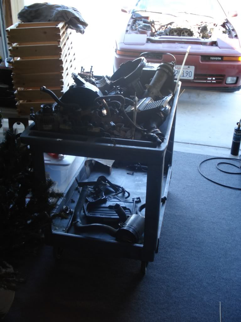

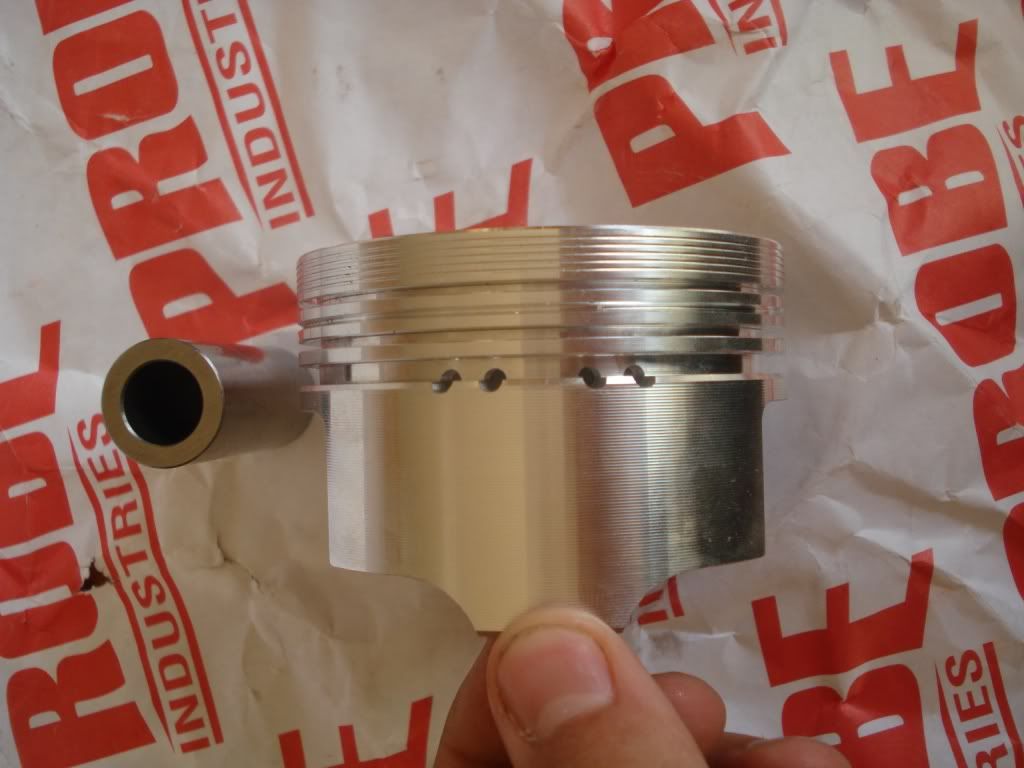

UPDATE TIME!!!!

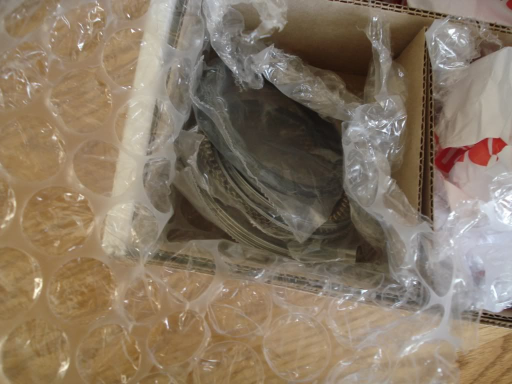

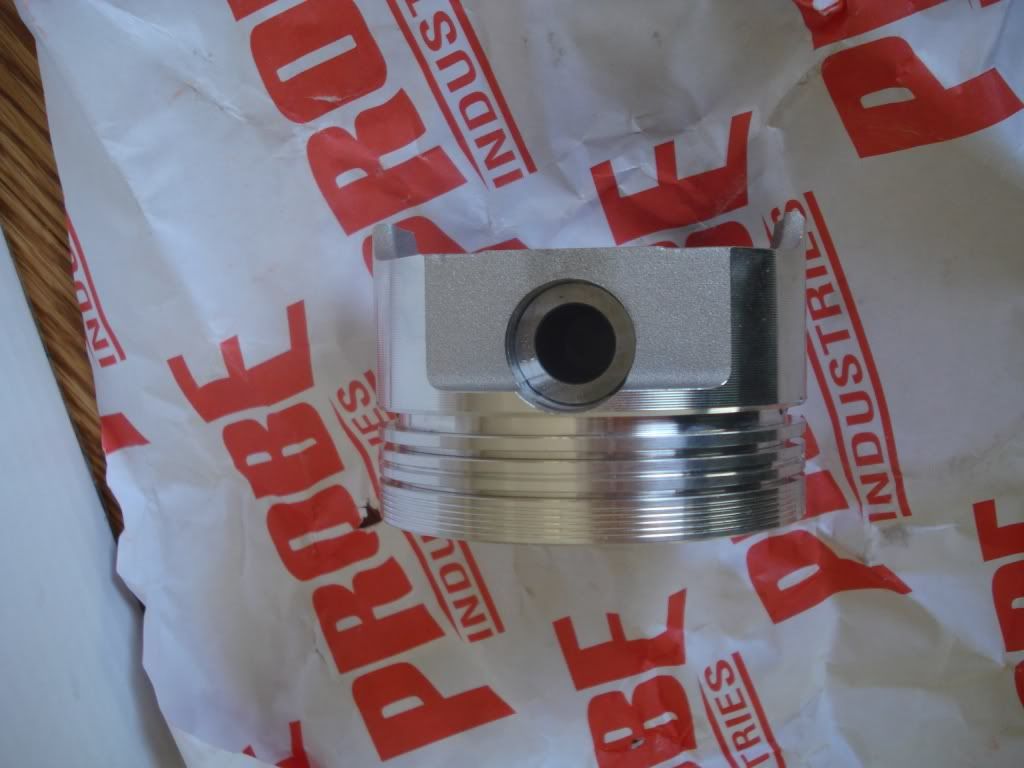

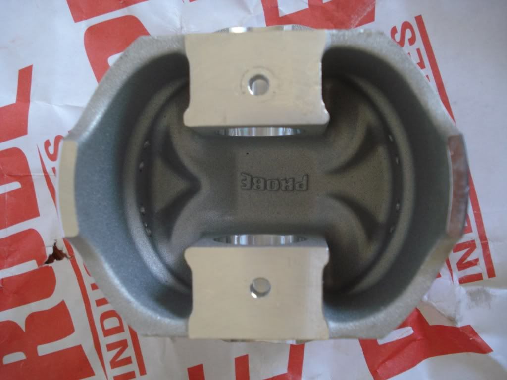

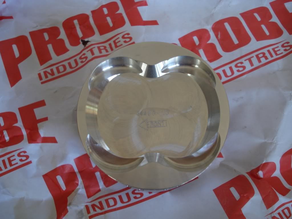

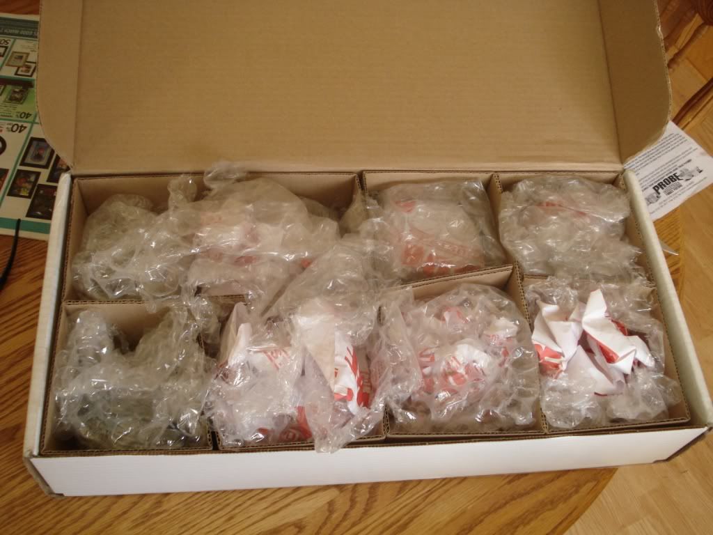

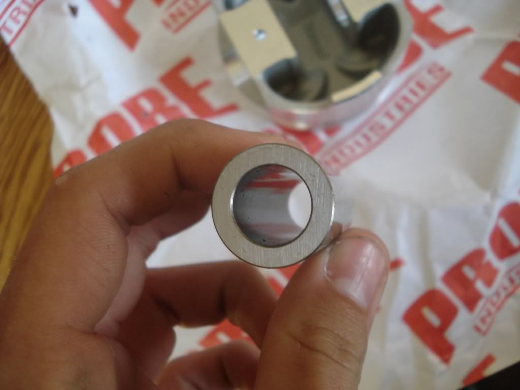

Received my gasket kit, plastigage, and my beautiful probe pistons!!!!!!!!
Just waiting for my eagle rods, arp hardware, and bearings...
Cleaned the transmission, water pipe, i've started to shave the valve covers, but didnt get very far, hopefully all of my parts are here by friday and then everything goes to the machine shop.
Also got a torque plate from nosman4!!

holy shit you got them already?that was quick!sorry for the stains on the spec sheet, i threw it on the ground soon as i found out my block was oversized :3d_frown:
i shouldnt of sold them, but it looks like they are gonna have fun in your motor :icon_razz
