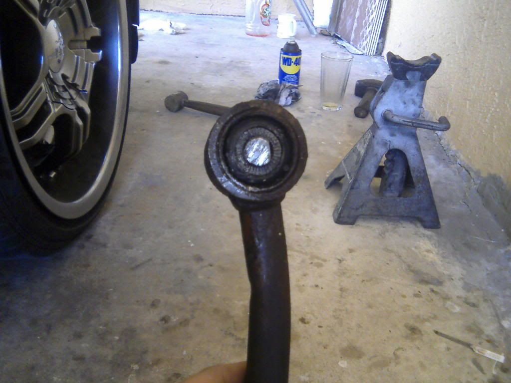

Another side benefit I have noticed from beefing up mine, although a number of other changes were also made......I no longer have wheel hop of any type at all ever. I run 285's out back too.
Here's my DIY arm mod, they are not the prettiest or anything, but they are definitely strong then they were originally.
I welded a small length of flatbar to either side of each arm to make flexing and bending very unlikely.
They work good for me.

Flateric: Thats another know thing. Your arms are the trailing arms which are known to be bent which causes wheel hop. This problem have been addressed by LIPP for example who made an cast version. But it's still nice to see what you have done. I will do something similar when I have a new garage for my supra.
The thread is about the toe arms which have broke right next to the weld on the camber bolt side which can cause some serious damage.
