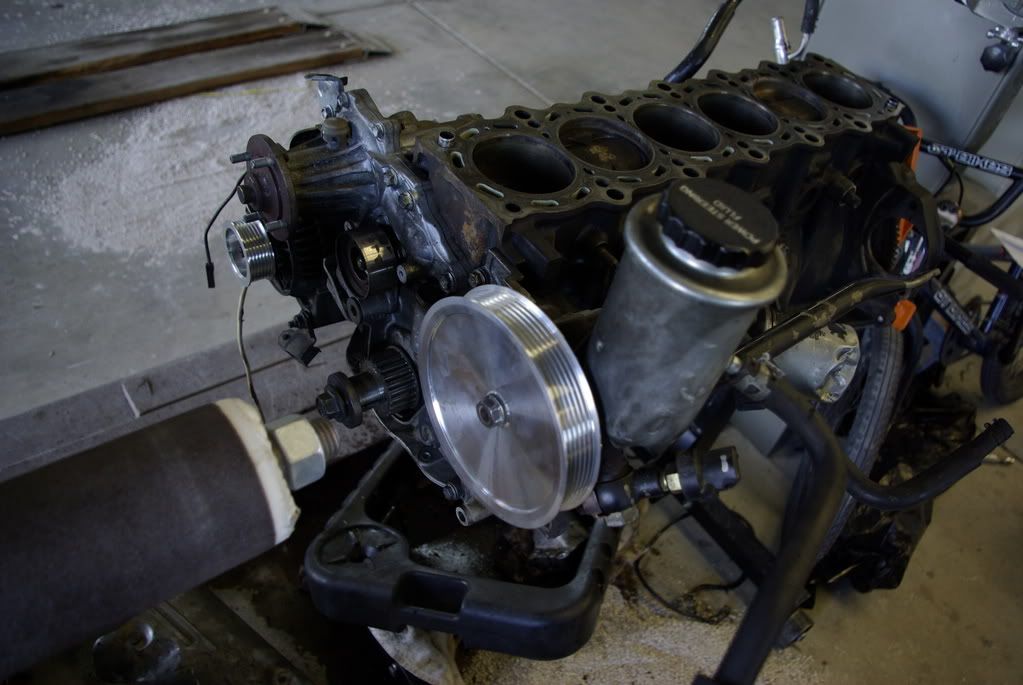

Over the past few days i've slowly taken the 2jz apart to put a twin turbo headgasket on and check a few things.

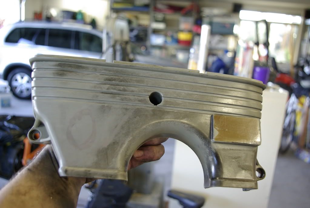

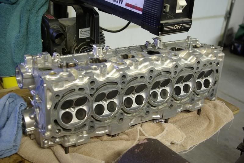

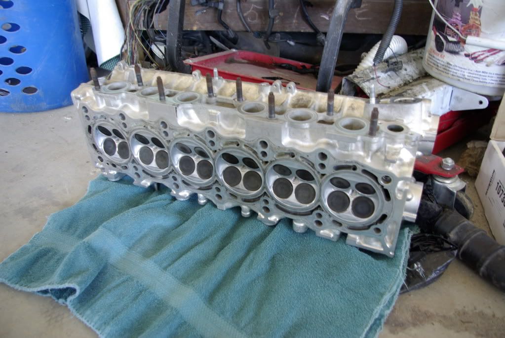

My bestfriend works for a machine shop here in Reno so he hooked me up on welding the EGR hole shut in the head and cleaning a bunch of stuff for me.
All nice and clean!

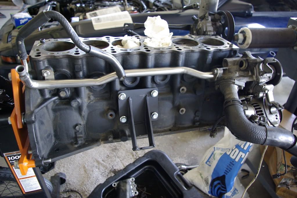

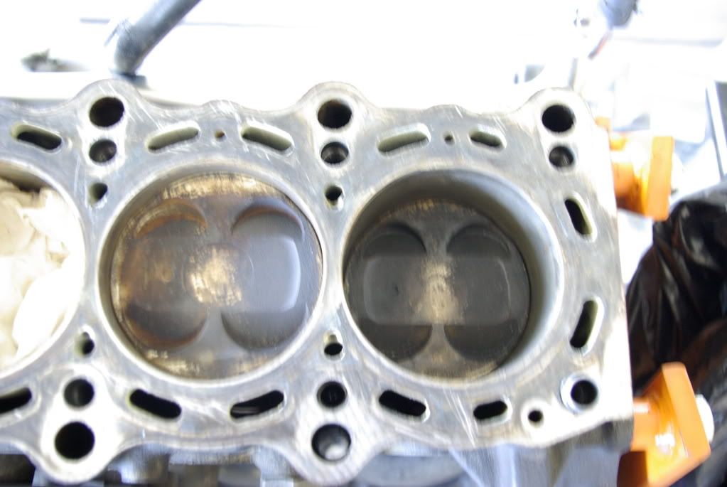

Today I cleaned up the block getting all the old gasket off the head, and oil pan surfaces.

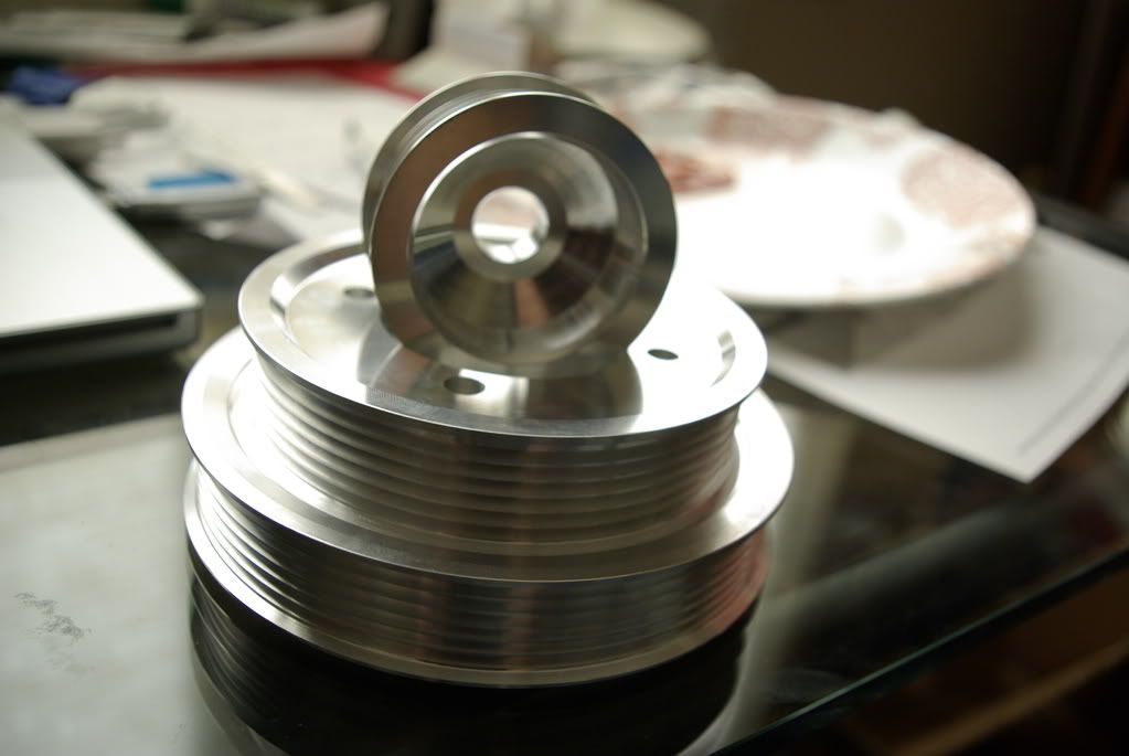

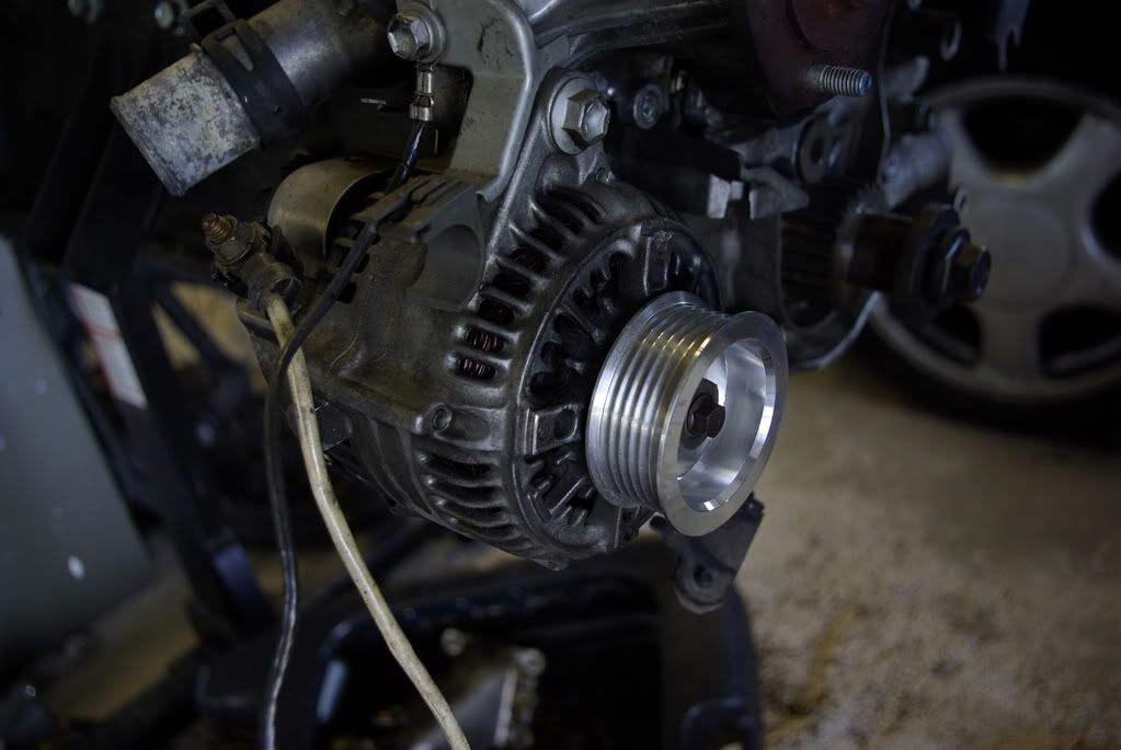

Also installed some of the shiney go fast parts I got from Aaron at DM.
These pictures dont give justice to these parts!

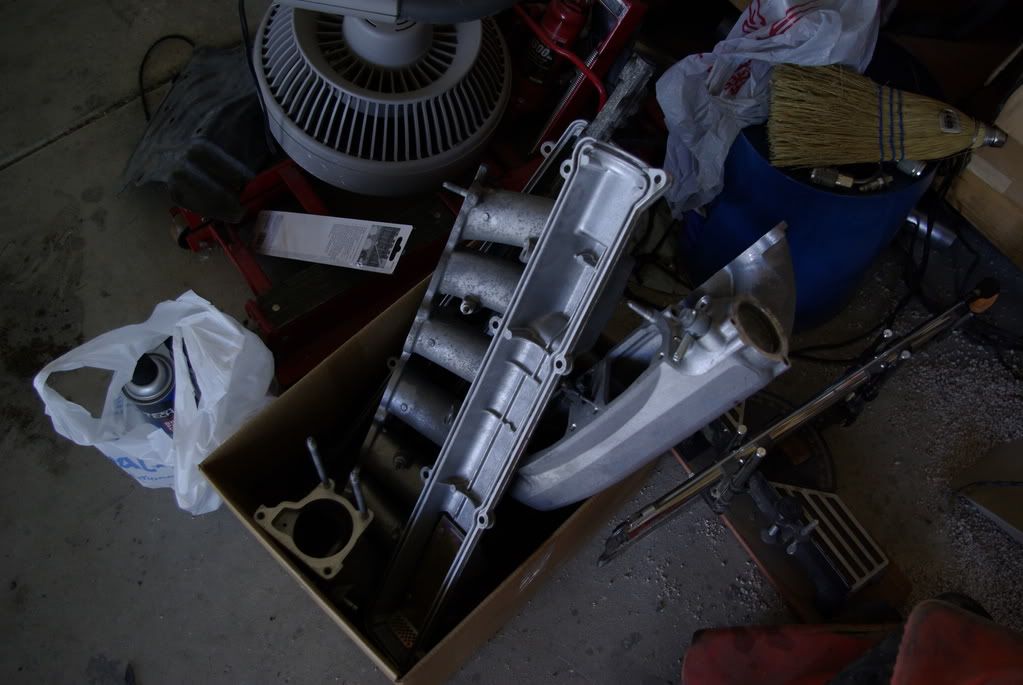

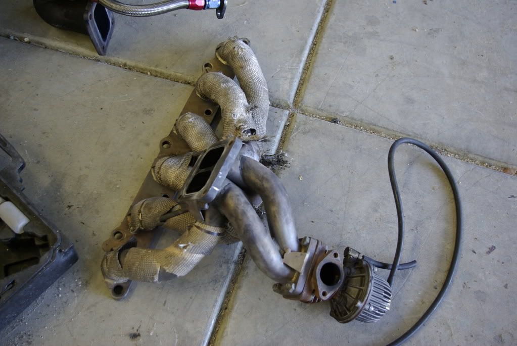

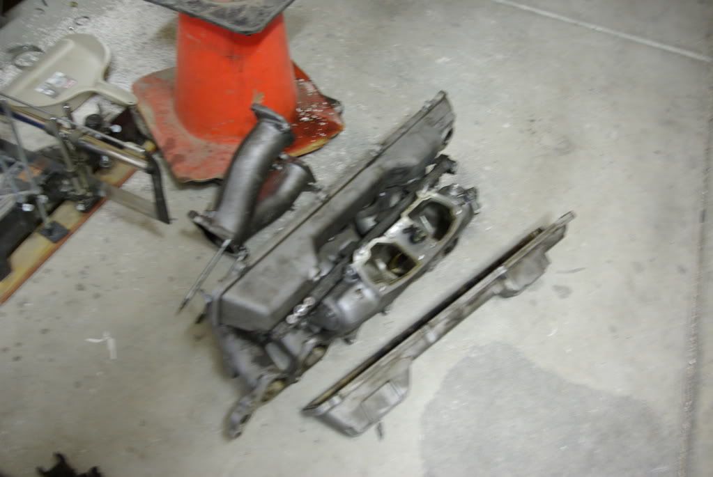

Also decided since I was bored that I would take my Masterpower T-70 and SSAC manifold off the 7m to maybe make the 7m removal a little bit easier.

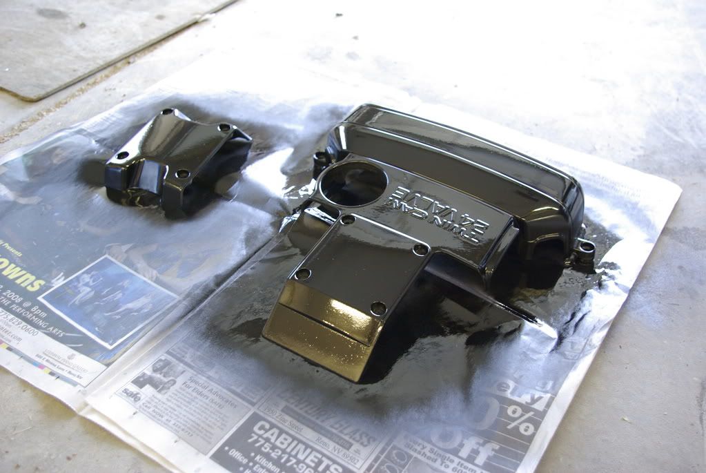

Also started to make the 2jz look better by painting a few things.

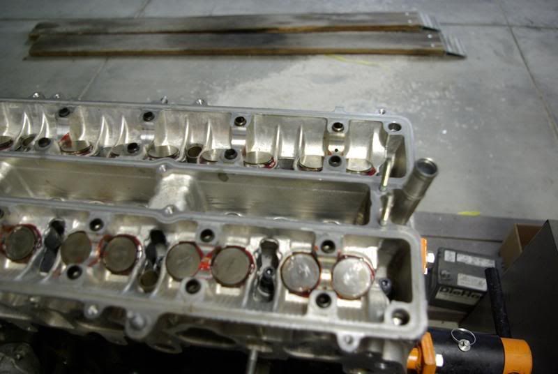

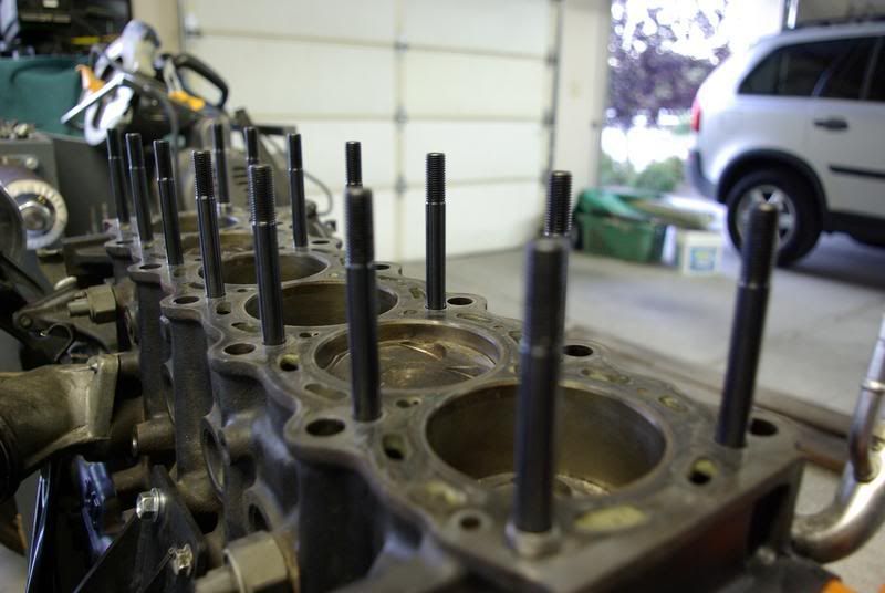

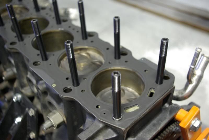

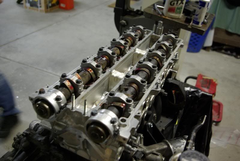

Made some good progress today. Started putting the motor back together. :)
Using ARP head studs torqued to 85ft. lbs. and a TT headgasket.

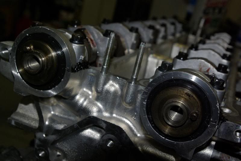

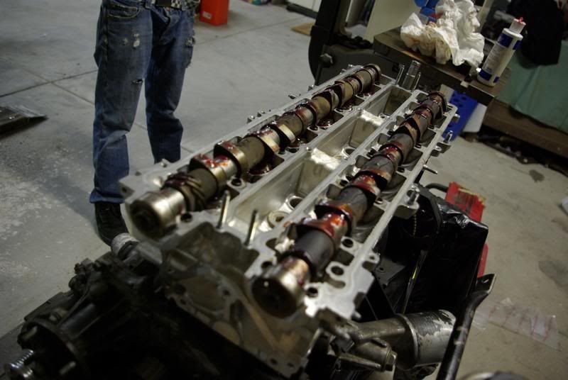

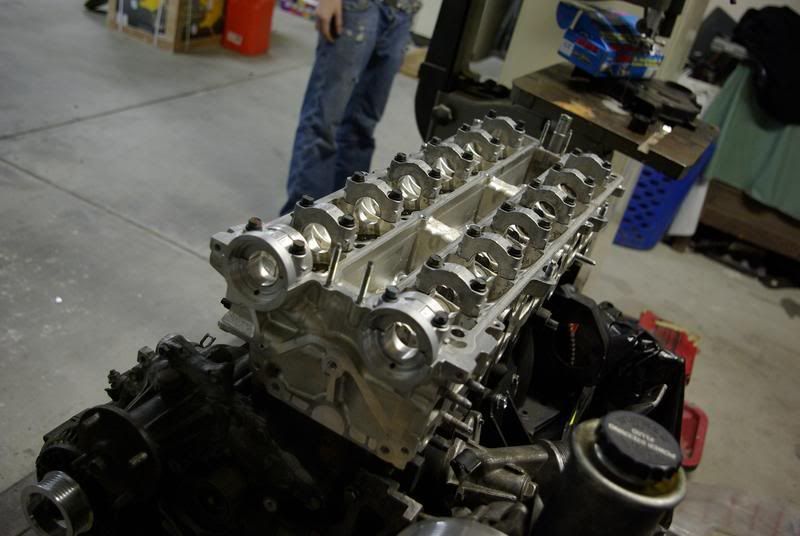

Also put my valve train back together :)
New cam seals!

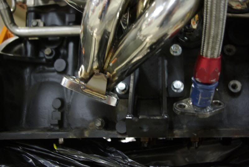

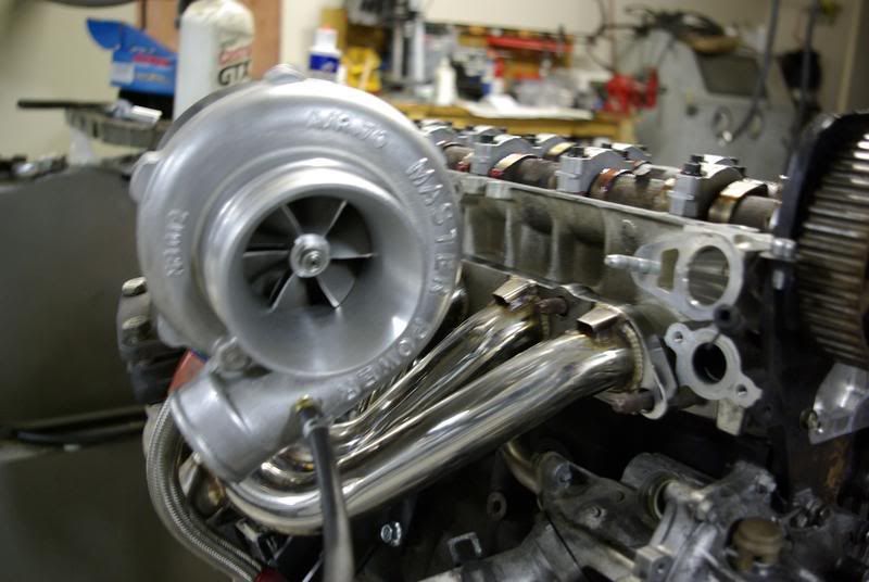

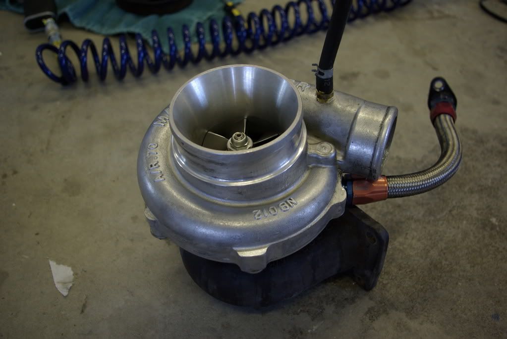

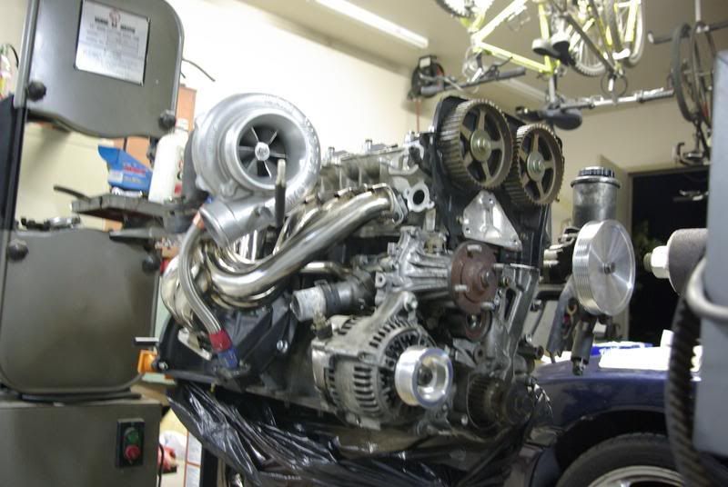

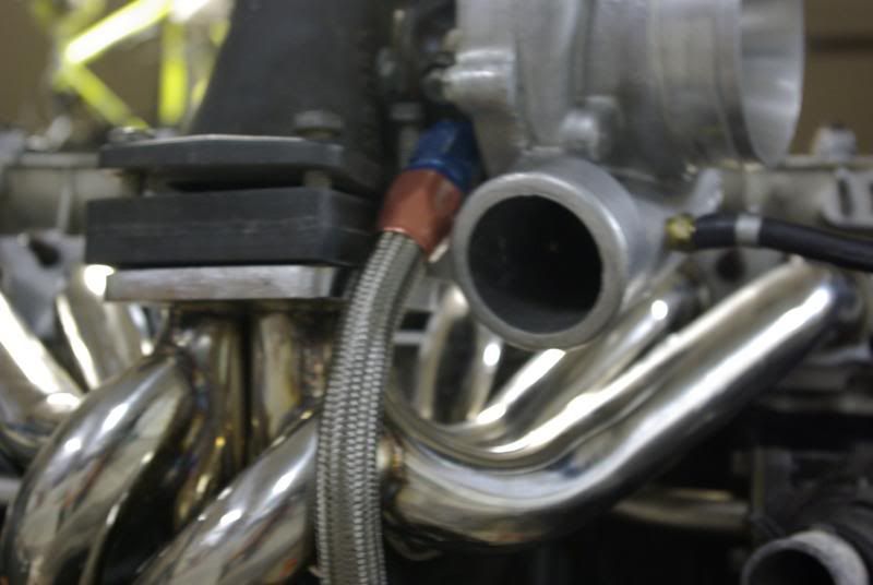

Got my manifold from fedex today so I mocked up my turbo. I have a 1" spacer that Jon@MDC made me right before he called it quits. Looks pretty pissed off I must say. But with the spacer I think ill have some problems with my IC pipe hitting the compressor housing.

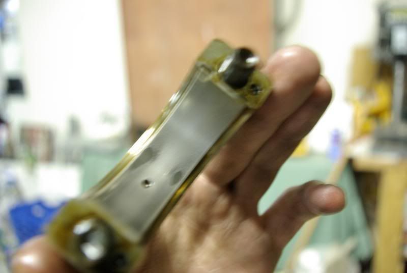

When my buddy from the machine shop was over hanging out we pulled a rod cap off. Didnt have a torque wrench at the time to put it back on so I left it loose til now.
