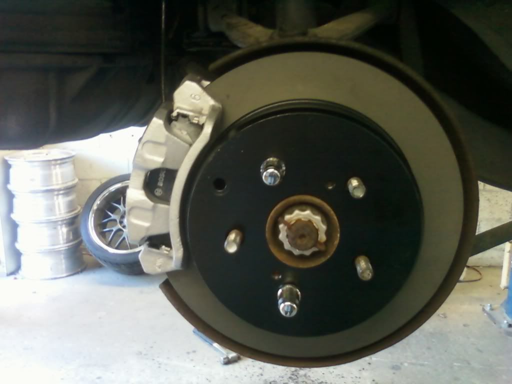

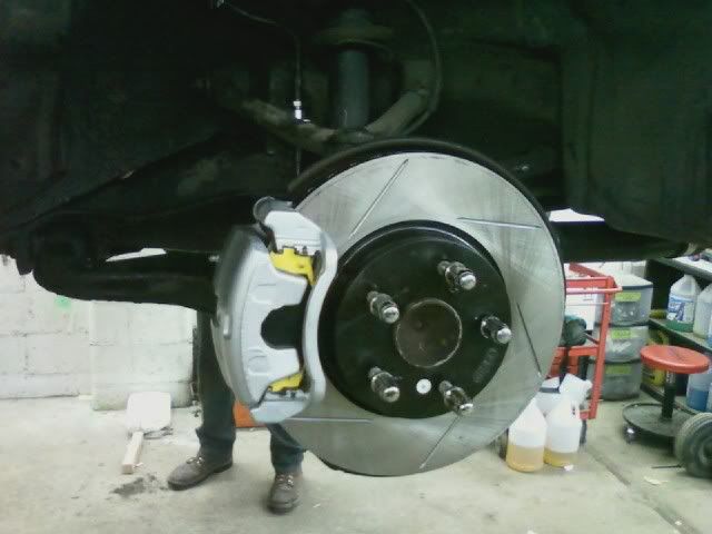

I just fitted my brakes, they are alil on the pricey side an most would say way over kill but I don't care what others think. I did the driftmotion cobra bracket kit and ordered a new 2000 cobra r brembo front package. All that is required is grinding down the back of the caliper alil bit no big deal, the rears are 2006 evo 9 mr calipers and 2008+ subie sti power slots with center bore machined out approx 2 millimeters. Overall it cost me about $1800, including new rear stoptech pads an fluid, machining, shipping and some paint. Pics can be seen in my build process album. Let me know whatcha think.
Front kit
Rear kit

Ah, I see that now.. Was kinda wondering too when I put the fronts on today, cuz the bleeders are towards the top. Makes sence now though cuz the fluid filling the caliper an having to bleed both sides. Thanks though for pointing that out, looks like the rears are coming back off..
