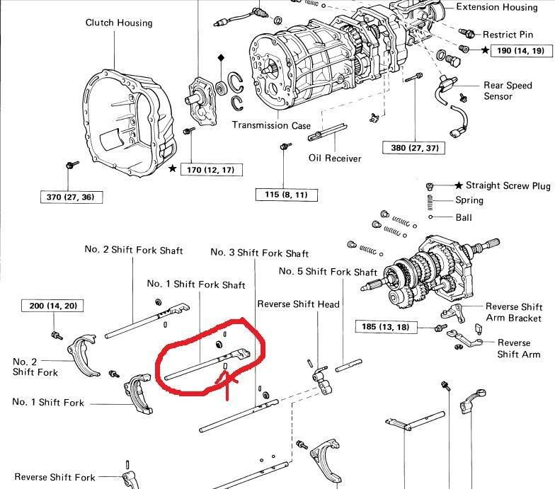

its actually coming along quite well. but i ran into a small problem. i have alittle leftover part...
does it belong between these two shafts?
and if you could tell me the purpose, that would be cool too.

Im almost positive its an interlock pin that goes in the #1 shift fork shaft. The 3 T40 bolts on the main bearing plate you see in your picture. I think each of those 3 T40 bolts has a ball bearing at the end there should be 1 of those interlock pins between each of the 3 ball bearings. So 2 total, looks like you only have one in there and one in your hand.
on the T40 bolts you're talking about, there are 4 total ball bearings. those are perfectly round AND installed. the space i have circled has alittle intention for it, but i don't see a real purpose since all the shafts are pretty securely in place

werewolves182;961950 said:
That pin is what im talking about. Its not in the spot your looking at. It should end up between those T40 bolts when the shaft is installed.
no i know what you're talking about. those are the round ones. this one is almost like an egg shape

Justin727;961951 said:
yes sir you would need that sir it is infact the one circled in the picture.
you seem pretty sure of yourself. i do think that's where it goes. i'm at school, so i'm gonna see if i can get that to fit in there. thanks!
yes sir, what i used to keep those and the balls in place during assembly was one of those small extending pen type magnets. Everything went together really smoothly.

well, after alittle more concentration. i got it all right and put together. i even painted it =0). i'm gonna be installing it tomorrow. i haven't updated my build thread in a while, so all the pics will up sometime soon. thanks everyone for your input!

they(both, as in 2) went in place of the upper shafts. the ball that i took out went the place that i circled and the other one went with the reverse lever in the extension housing. i'm glad i figured that out =0)
