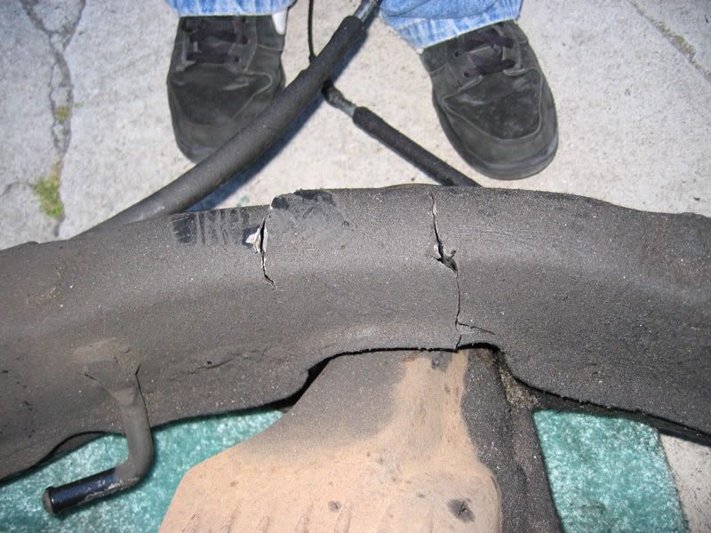

I can't help but think this is the result of rust more than the result of driveline stress:
I don't think this would have happened if your car would have been from Cali or Arizona etc...

and honestly, you can't tell from the pics, but the rust you see on there is all surface rust. i can't even scrape it off with anything. a bit of sand paper makes it disappear!
however, i honestly don't care how it happened, so long as it NEVER happens again! ;)

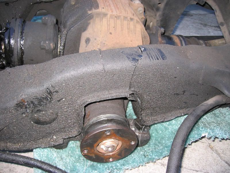

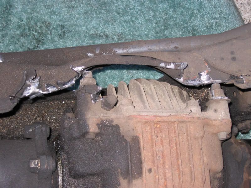

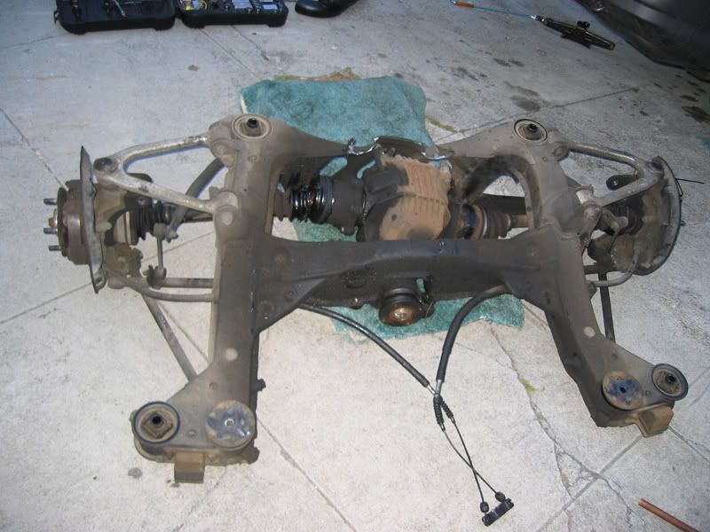

in all honesty, i would THOROUGHLY inspect the rear subframe before pushing any major power through it. my car lived it's life as an N/A until about 3 years ago when i swapped. at it's peak, the car made 289rwhp, 295rwtq @15psi on a blown stock turbo. - and i only had the car on the road for a total of about a year. i personally think that the crack was there all along!
here's what my subframe looked like when i dropped it to get it reinforced (because i wanted to be safe) please note the GIANT crack right through the front section above where the differential sits:

Good grief Evolution, you sure showed that subframe who's boss.
I'm going to measure and see if the 240SX bushing inserts will fit, so I'm definitely going to check out my subframe while the car is on the lift. Too many horror stories floating around.

evolution: DAMN! you ripped that thing apart! what was your power level (i was still around 300rwhp, and have concluded (and others have, too) that the crack was there for years- probably even before i got the car!
