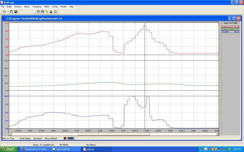

Well yesterday funky_monkey58 and I braved our way to MAP Performance to see if we could get over 600 rwhp. It rained on the way down and even though we tried and tried to get the manual boost controller to give us over 21 lbs of boost it would not. A ton of Evo's and Eclipse. I was the only Toyota that I know of that dyno'd. I pulled 507 rwhp at 21 lbs. There were some amazing cars there and I felt glad to be among the top and also that we didn't break anything. We did have a slow coolant leak though.
Today we reconfigured the wastegate and took her out on the back roads to dial her in. At first we had too much boost. I hit 31 lbs during a 50% pull. Actually hit fuel cut, first time ever on the 2JZ. So instead of having too much boost and slowly dialing her down, we opened up the boost controller and then slowly increased her up to 26 lbs. Damn, she pulls like a raped ape! I know we must be over 600 now. With all the 3rd and 4th gear pulls, I had her up to 140 a bunch of times. I am glad I was able to score the Wilwood BBK today!

I had forgot what fuel cut felt like. Damn good spike at 4700 rpm's. The AEM must sense that there is way to much boost. If we would have kept going it would have been damn near 40! Much better approach is to start with boost controller open, and slowly dial it up.
