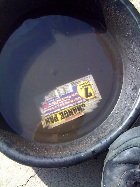

Now that im not spraying water around like its the shamoo show i can proceed to Flush my radiator as i was planning. Ran the engine for about 12 min " not to mention the flush solution with the water was sitting in there for about 2 1/2 days" I undid the bottem hose and let it run into a pan. This is what i found.
Thats basically what i found the first time i emptied the radiator. So i ran the water though the radiator to see if it was any better now that it loosened up all that crap and this is what was left
Much much much cleaner. i hadnt even rinsed out the oilpan before i dumped the running water from the radiator in there so it came out cleaner than it really is in the oilpan.
