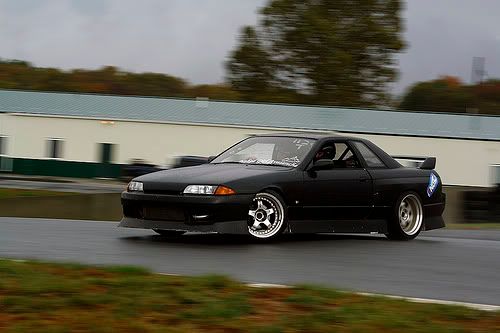

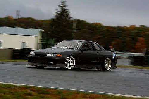

Some pics from an event I did in the rain this weekend. They are the first pics that show the rear over fenders on the car. I just cut the qtrs and slapped em on in the black gel-coat or whatever they came in. Looks like apretty good match, even up close.

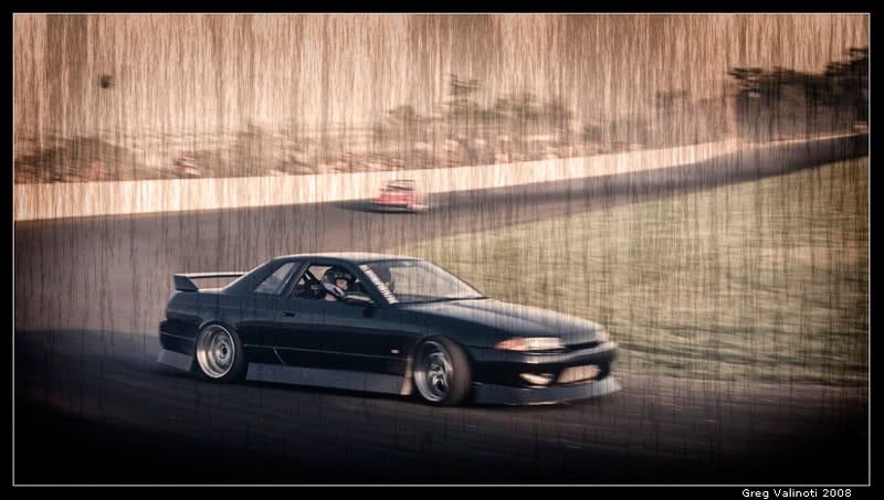

There is this other weird/neat pic of my steez that some guy messed with on another forum.
^kinda neat, I guess.
I know my car looks REALLY high off the ground in these pics, but it isn't too bad in person. The toe of an average sneaker will not go under I swear...
It will be getting a smaller diameter front tire and some slamming during the winter re-do.
