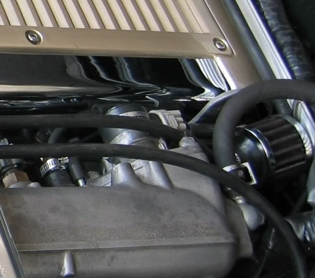

Rich
tunin' tha beast
Jun 2, 2007
319
the netherlands
I've put one of those little breather filters on it.
