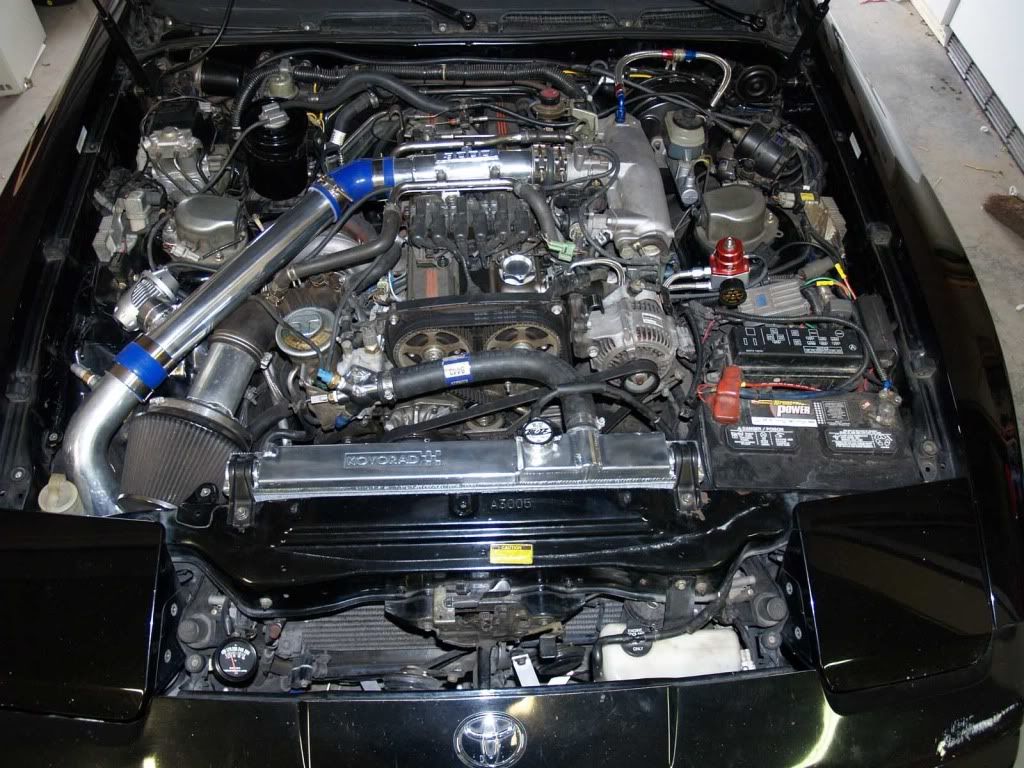

I mount mine just behind the fuse block. There was an empty threaded hole there. I routed all my wires in front of the battery.

Here's a pic. Lower left is my gauge. You can also see the FAL controller on the right, behind the fuse block.

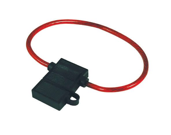

Here's the fuse holder I upgraded to. Except mine is all black.

As for the fuse thing... give me a break. That is COMPLETELY unacceptable, unless you lot are all putting in the wrong fuse and running more than the rated current through them... which I don't necessarily discount either.
