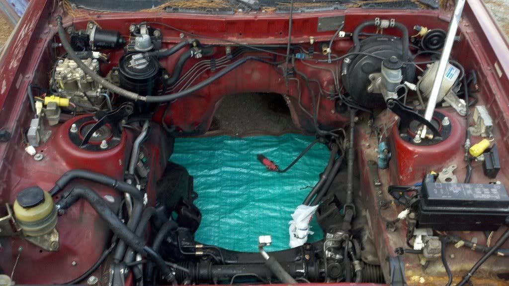

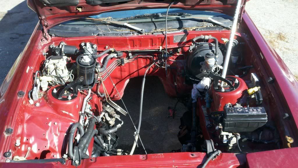

I've used purple power and it's more expensive brother (castrol superclean) for years to wash engine bays, dirtbikes, quads, and even really grimy vinyl and plastic interior parts with no problems. The important thing is to only leave it on there for a minute or two MAX, and rinse it VERY well. If you do that you won't have any problems with it. Also don't use it on cloth or foam parts or anything that you can't rinse well.
Here's the before and after from my engine bay that I washed with purple power and a cold water pressure washer to spray the loose stuff off first and then to rinse.
I still need to paint the TEMS covers and a few other things.
The purple power only needed 2 applications (one would have done it, but it was so dirty that I missed spots cause I couldn't tell where I had already scrubbed cause of all the stuff running off).
This pretty much changed my whole attitude toward this project... before cleaning the engine bay I kept asking myself why I was trying to resurrect this scrap heap.
