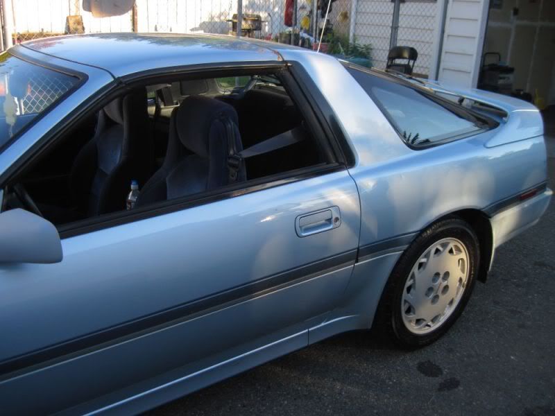

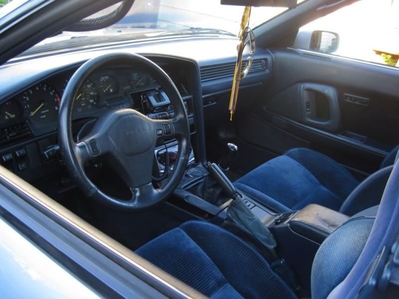

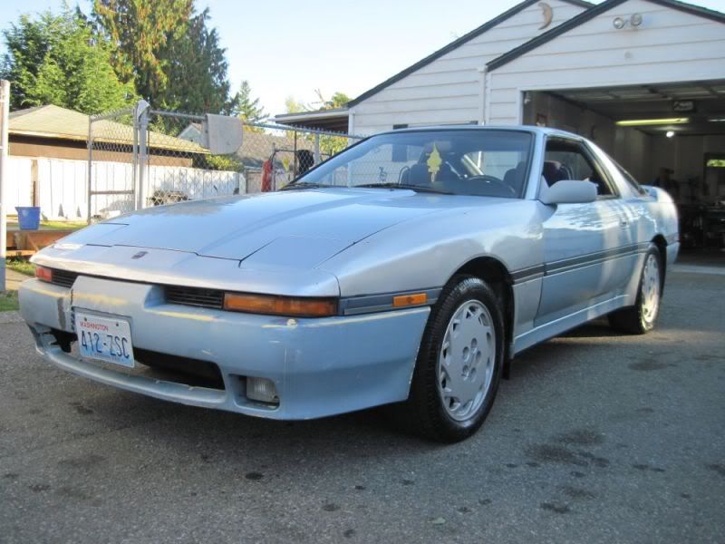

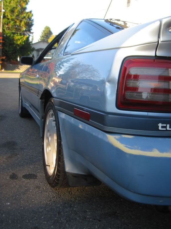

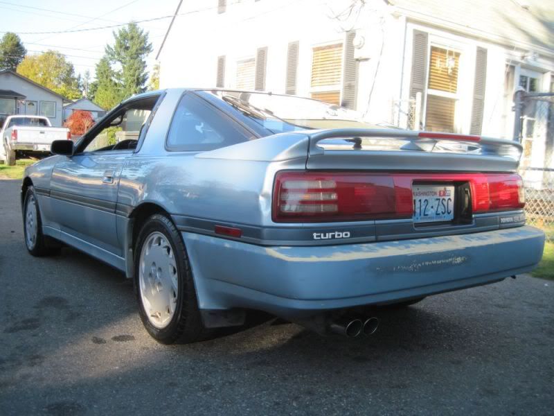

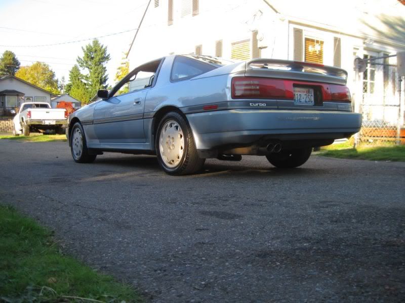

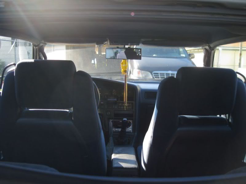

Hi guys, as most of you know, I had a 1988 Toyota Supra n/a a couple months back that I have sold :( And acquired a 89 Supra turbo targa :evil2: Well to make long story short, heres a couple pictures of my progress, it originally had torn leather seats so i traded em out with blue seats,the guy just threw in the back seats for free (they are black yes, but ill use them for now till i find some OEM blue rear seats). Enjoy!

^ Thanks for the tip. as for now i have a source for HELLA e-codes(?) but that is not the most important thing to me right now. What would you best recommend for housings? Im trying to go HID's sometime in the near future

Clean car
I had those headlights on my supra...
Sucked real bad
Drove around with my high beams on
In the rain at night your better off to just turn your headlights off lol

Hellas are a good headlight, but they don't convert to HID well. If you are sure you want HID in the future, cut up the housings you have and put proper projectors inside of them. It's been done a few times by now.

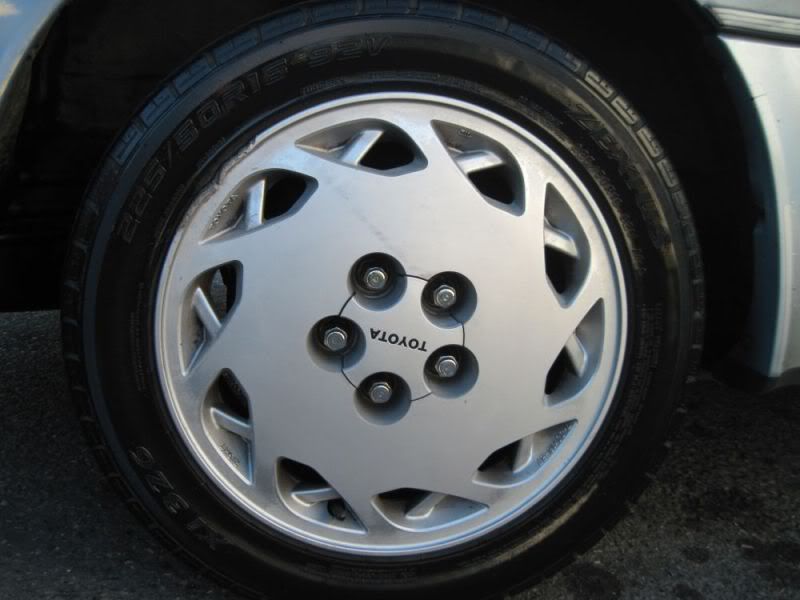

Thanks, i will definitely consider doing that. As for updates, i got a free 86.5 Grey interior. Im not really feeling the seats and inserts, but those will be replaced with the proper 89+ Stuff later on, and a picture of my new front tires, theyre Toyo Proxes FZ4

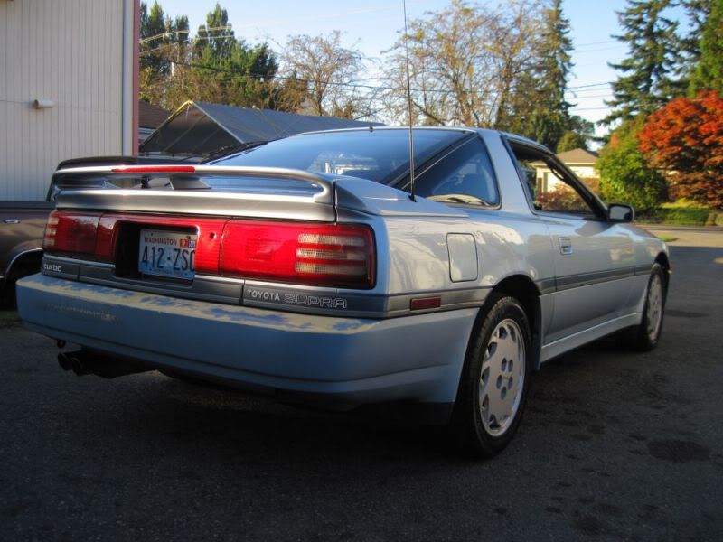

Currently trying to configure out a exhaust setup. Im thinking a 3" downpipe with the first cat deleted, and the rest is just 3" piping with a cat for emissions and a test pipe for the rest, and some aftermarket muffler at the end. I already have a K&N intake just trying to match that up with a proper exhaust as I have a shimmed wastegate at the moment, turbo upgrades will be later, oh, and new rear shocks come in the mail tomorrow :D

Looks good so far, remember not to shim the WG too far or it could go bad. Have you done a leak test on the IC piping? It's a cheap/easy check to make sure you're not losing power from the turbo to the intake other than pressure loss in the stock IC.
