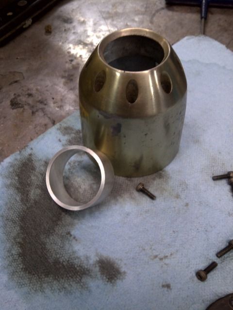

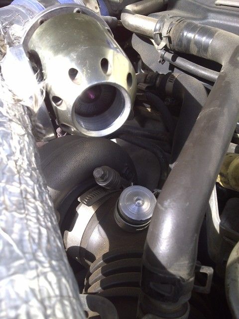

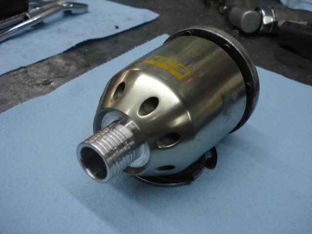

Decided to mod up the recirulation fitting for the bov since I wasnt a fan of how it sounded through the tiny hole. Put it on the lathe and cut it out. Sounds MUCH better now.

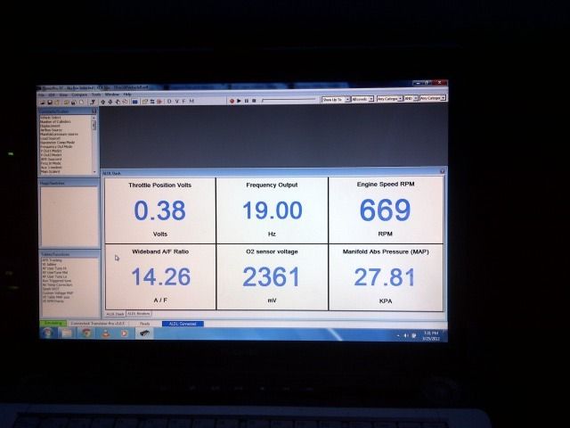

Little snap shot of tuner pro running realtime
