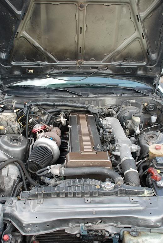

I Decided that i am going to Combine my multiple build threads and keep this one going only. which is why im bringing it back from the dead.

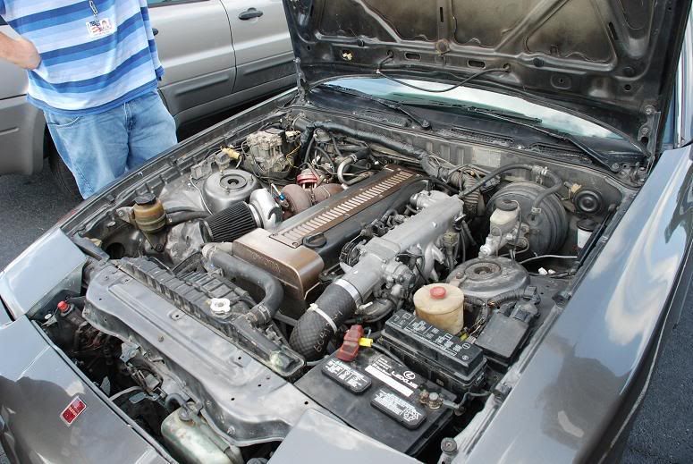

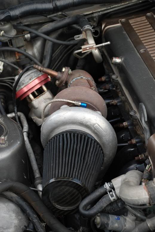

Well this past weekend Tissimo and i installed the single on my 1J
took awhile but finally got it.
Garrett T04S 60-1
Drego Manifold
Turbonetics 42mm Racegate
Ebay SSQV
Everything else is stock down to the IC PIPING!

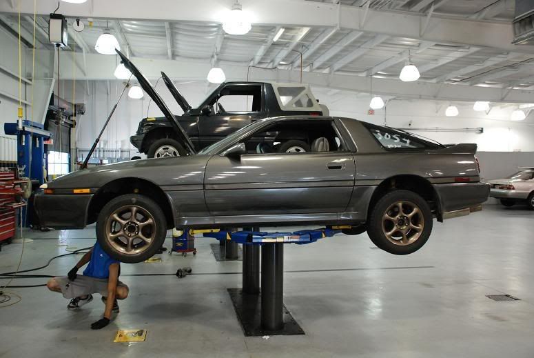

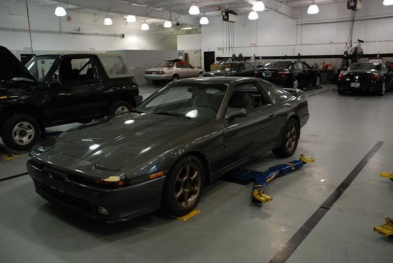

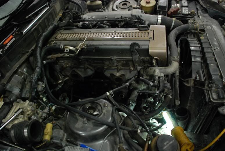

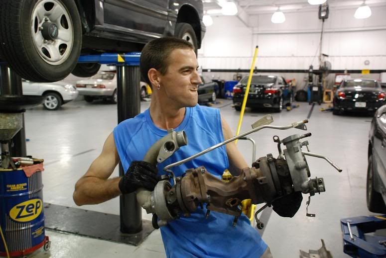

Arriving at the lexus Dealership

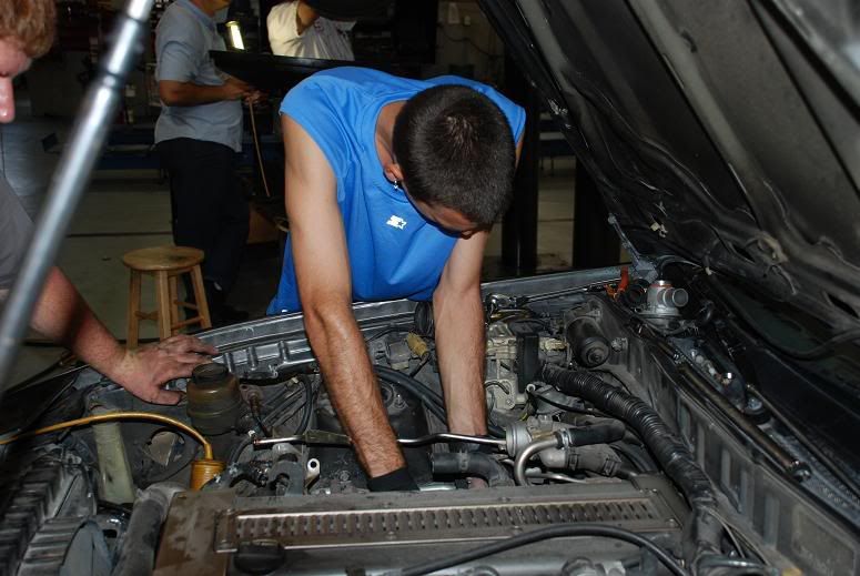

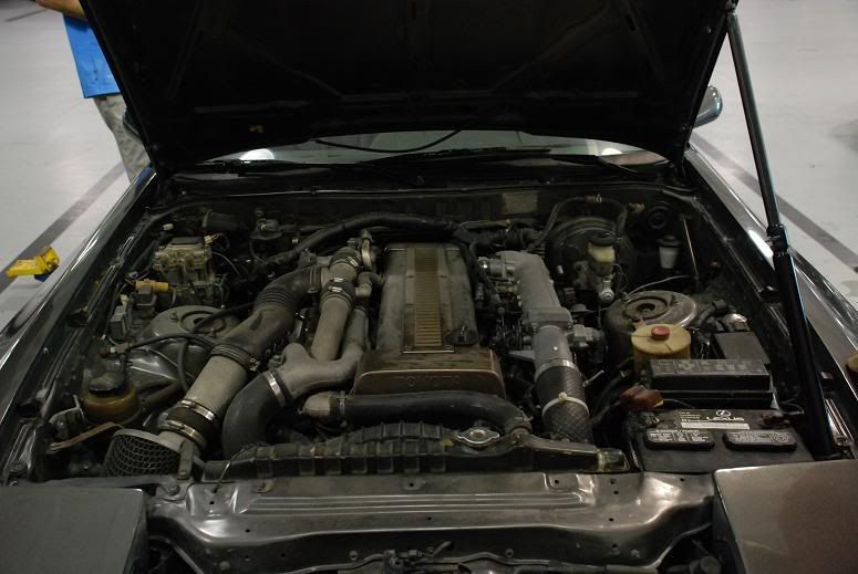

Getting it up on the lift to remove custom exhaust to remove the twins
last shot of the gay twins on my 1J
Getting closer
Getting frustrated :aigo:

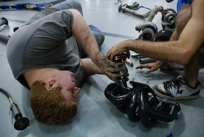

Removing the twins was GAY. such a PITA

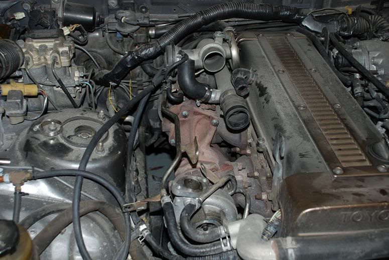

Twins removed BYE BYE! :naughty:

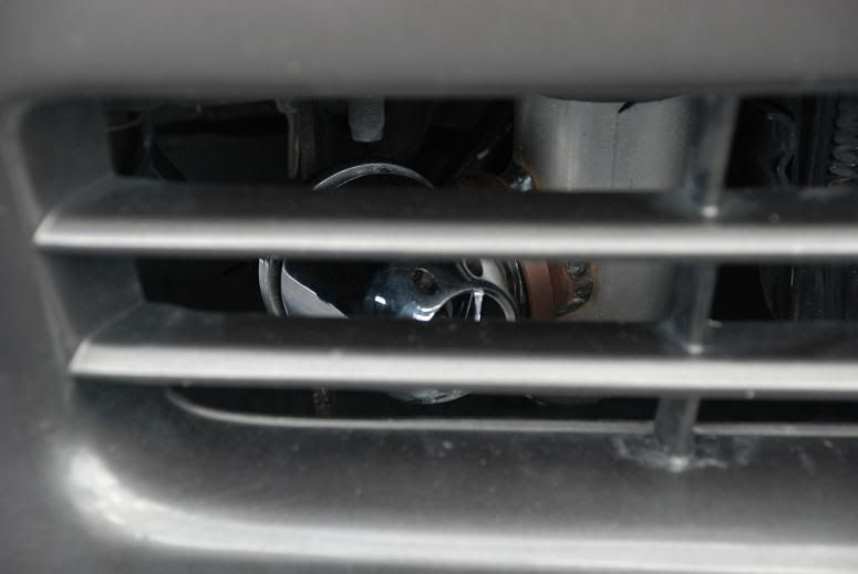

Just for fun got a shot of my new twin Photon Blaster :biglaugh:

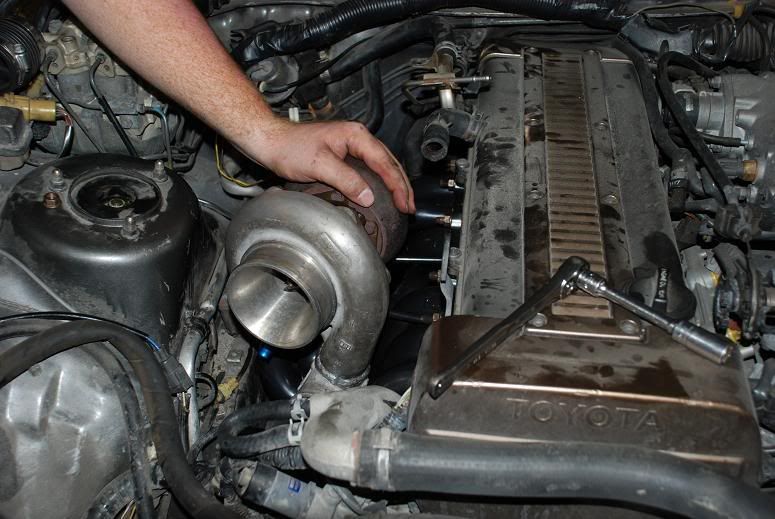

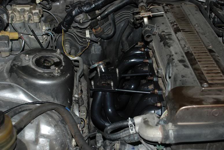

Test Fitting Drewgo's Manifold

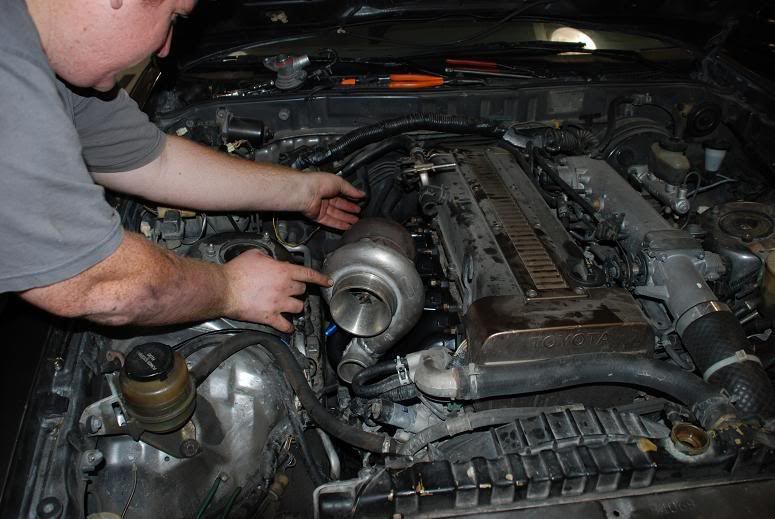

Test Fitting the WG

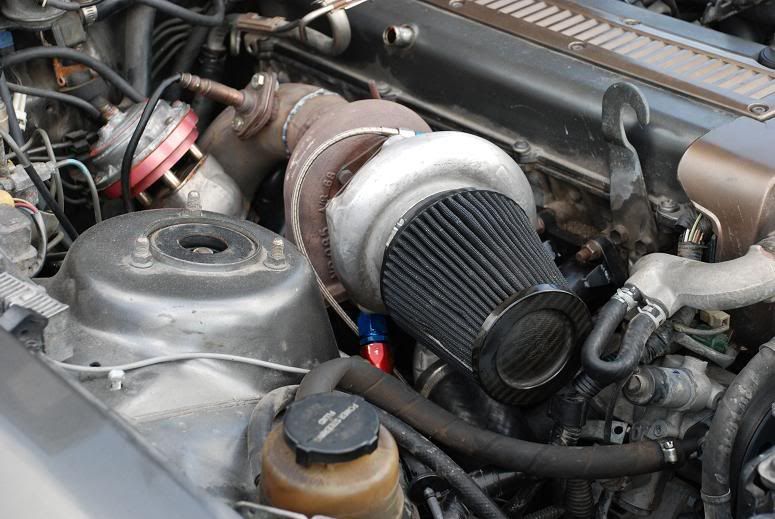

Test Fitting the Turbo
A little more Test Fitting to figure out the path of the DP and Dump tube

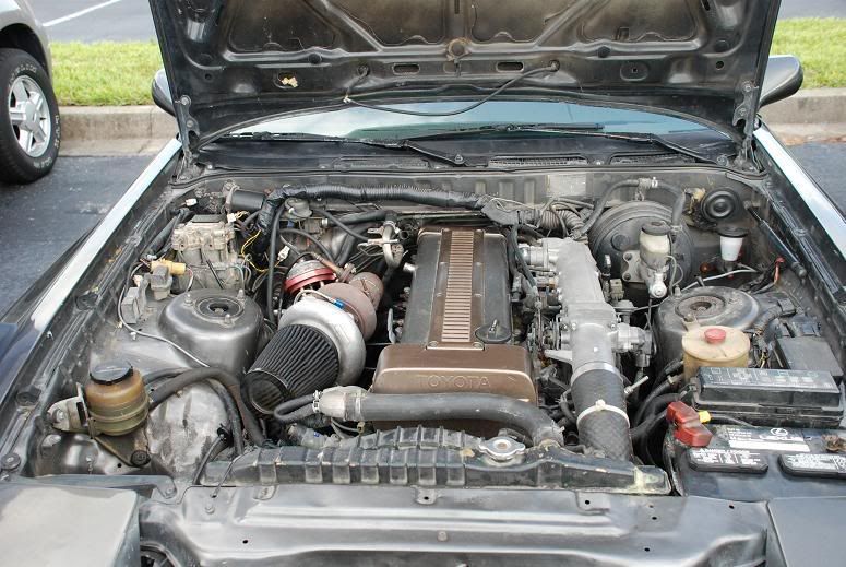

More pics to come. a friend of mine who took these pics left at 9 on Saturday night. so no finished pics yet. just took the finished pics like an hour ago during a smoke break at work. will post em tomorrow!!
man the sound is awesome. 3 inch turbo back on Drewgo's manifold is NUTS!!!
man im glad i didn't sell this thing HAHAHAHAHA :aigo: :aigo: :aigo:

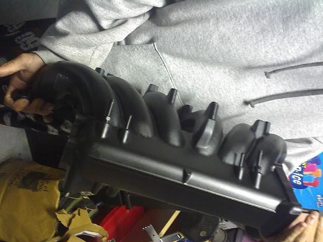

As many of you know i fried out 2 ECU's on my 1J. I'm over the 1J ECU's and have decided to go with an Aristo ECU and Aristo Harness. I got 440cc Injectors while i was at it and a New TiAL 38mm WG as well.

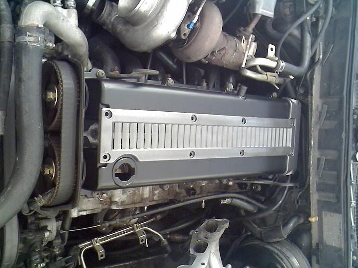

While i had the car apart for pulling the harness and removing the injectors i decided to paint a few things
Cam Cover and Plug Cover
and here is the Intake Manifold
Still need to paint the Lower runners and throttle body and then i will be done with that part.
i will post more pics as i get them with the harness installed and all that good stuff.
Looking so awesome now. How does it feel compared to the twins? Isn't your turbo about the same size as my gt35r?
That Photon Blaster looks more deadly than an SKS.
The Reaper
Single, and lovin' it!!
Jan 10, 2006
1,909
Florida
LMAO hell yea i blast lotsa hondas with it while crusin' in the supra
it feels WAY different than the twins my turbo is a 60-1 so its a 58mm
