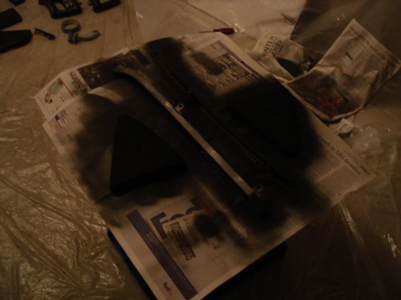

Well I finally got a steppin and started painting parts of my interior. I am still trying to source some pieces because what I have just won't cut it. I am using all SEM products for this project. Satin Black is the paint.
This is actually taking alot longer than I expected since there are so many steps involved. This is the process I go through with every piece.

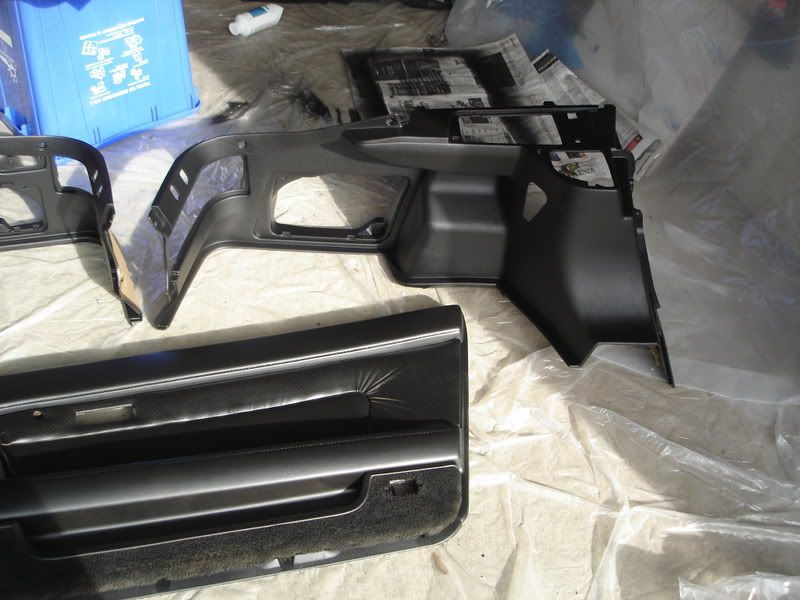

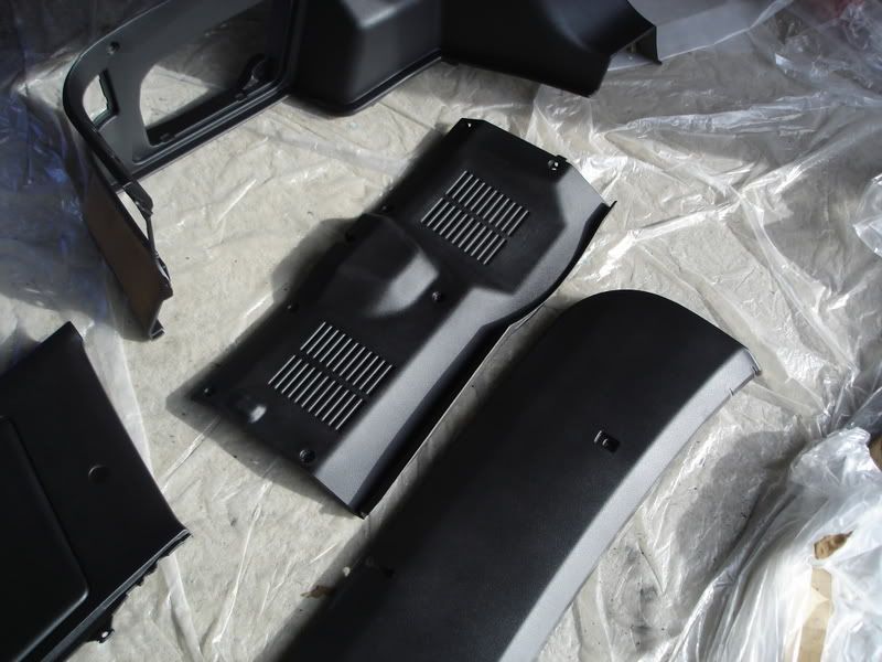

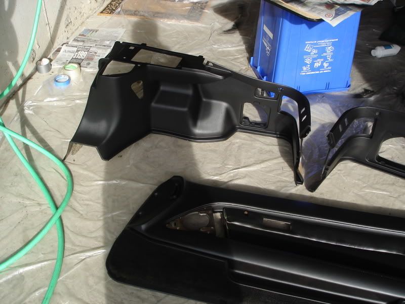

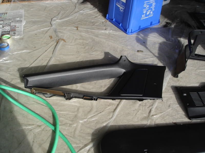

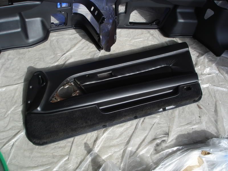

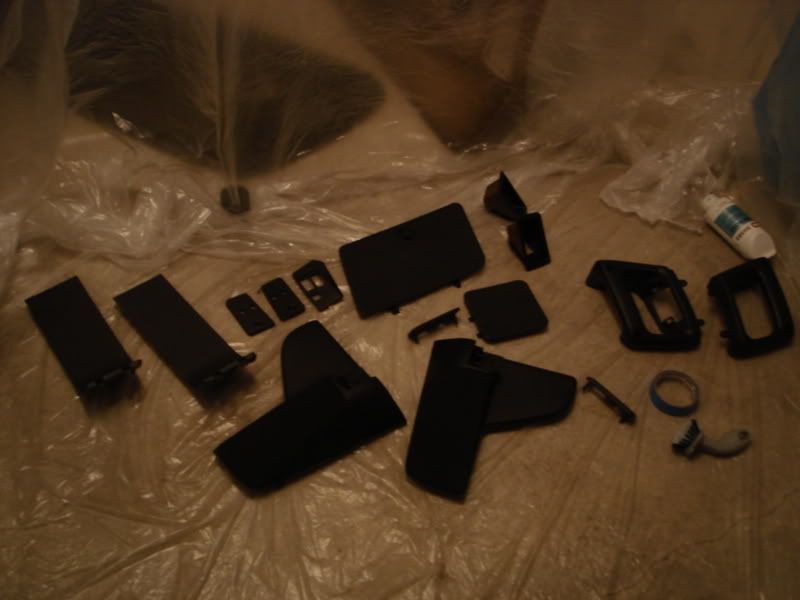

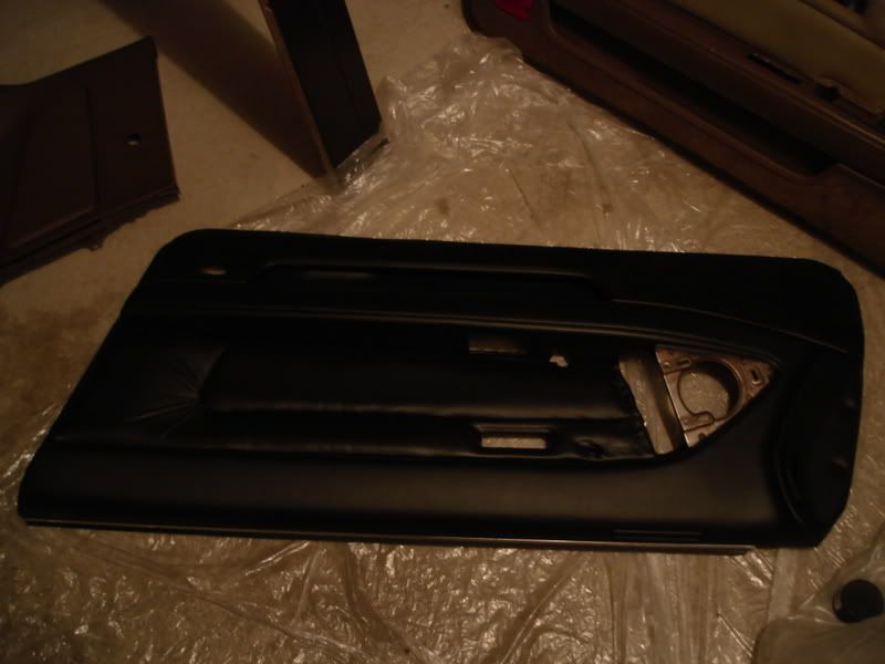

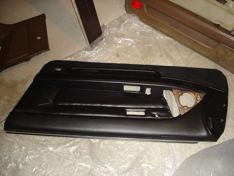

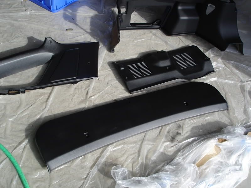

Here are a few pictures of what I have done so far. I am extremely happy with the way everything has turned out. It all looks brand new and is exactly the sheen I wanted. Just like an OEM black interior.
