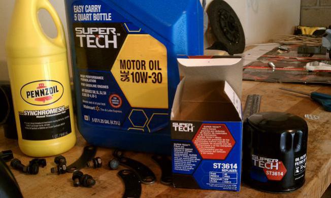

Have you used Syncromesh before? Tons of guys swear by it and it's really popular in the Honda crowd, but I had a bad experience with it. My experience with Redline, on the other hand, I could say good things about that all day.

I used it once a very long time ago. Wasn't anything special in my experience. I pretty much always run a Redline MTL / MT-90 "cocktail". But I just grabbed some off the shelf stuff for this time, since I will hopefully be going with a different tranny in a year or so.
