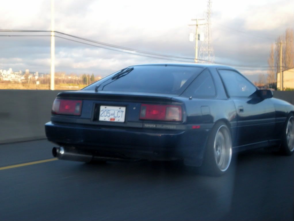

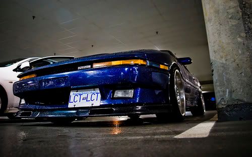

I cut springs on my MKIII back in the day and honestly it was great. $0 mod.
