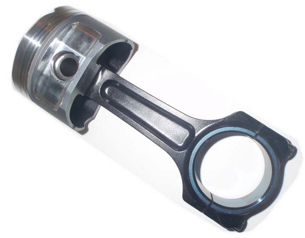

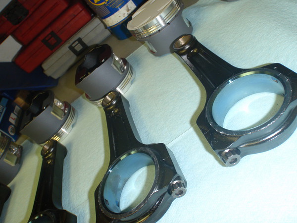

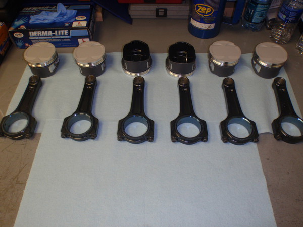

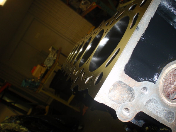

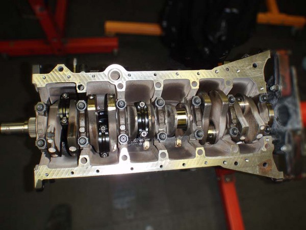

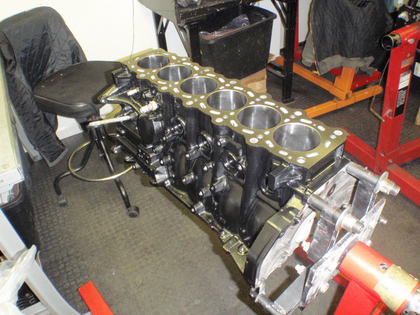

Well the short block is assembled and now I will be moving onto the process of building the head. The block consists of the following
-stock block
-stock crank
-ARP main studs
-ACL race main and rod bearings
-Custom 9.5:1 .020 over CP pistons with ceramic and oil shed coating
-Manley Turbo-tough rods oil shed coated
Photos to come.
2jzFUN
Nov 23, 2010
Twin Cities
Here are more photos of the engine assembly. Will upload more later.

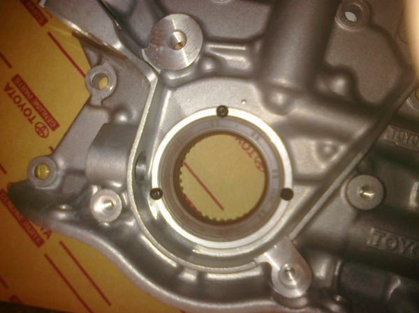

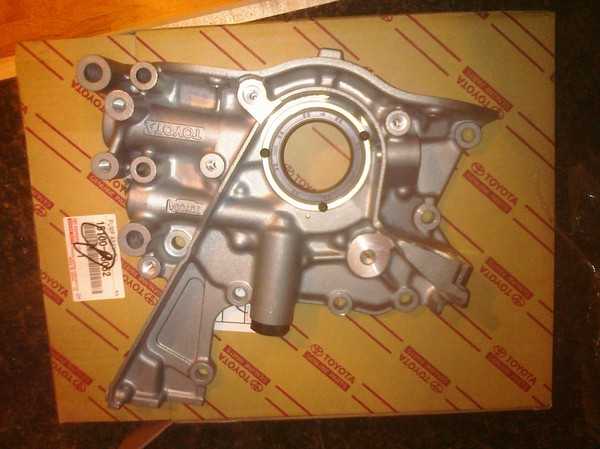

Got my modded oil pump by Sound Performance thanks to MAP!
It starts as an OEM Toyota oil pump. This is from SP's website.
This includes a new Toyota oil pump. We then take that and modify to increase pressure and prevent the front main seal from blowing out.
What is done to it?
We shim the main pressure spring
Drill a larger return hole
Drill and tap 3 set screws to hold front main seal in
Shorten (tighten) main seal spring
I guess there are problems blowing off the main seal under high HP. Not no more :)
