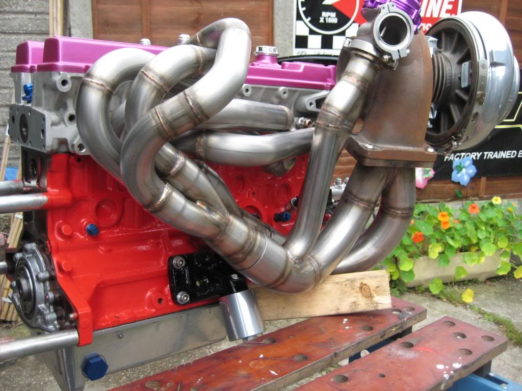

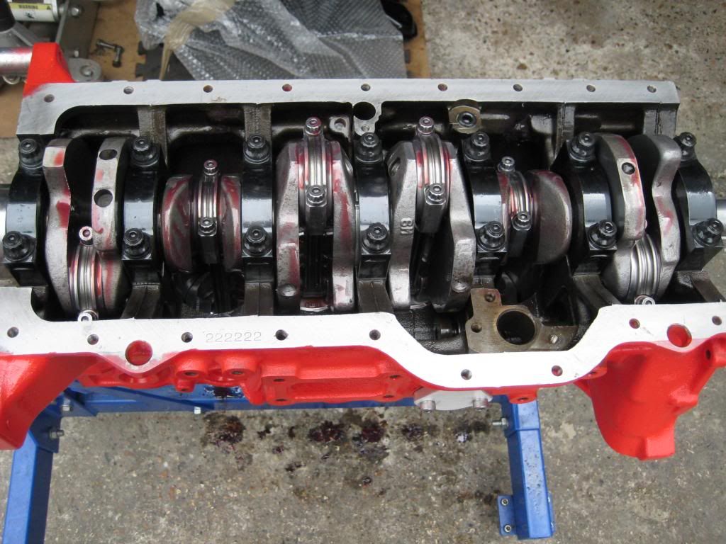

thanks mate,all the parts and pics are on the build thread on mkiiisupra.net.

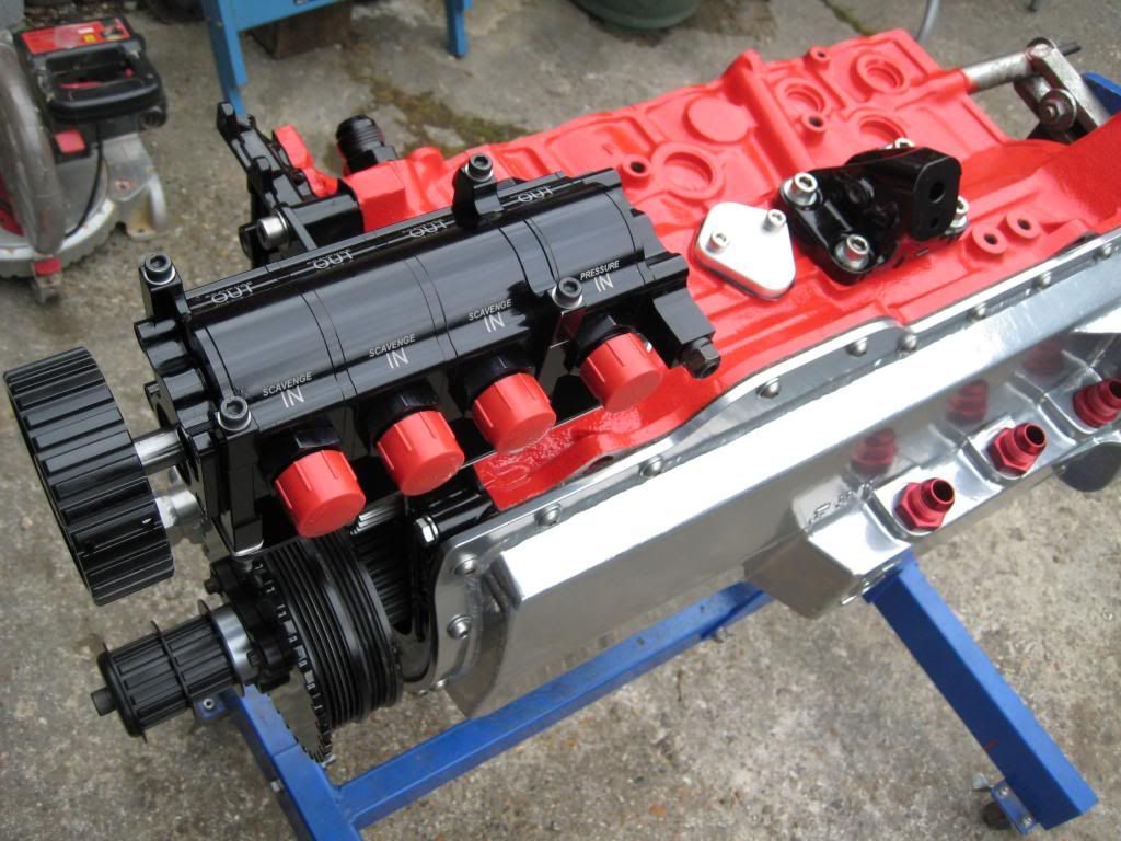

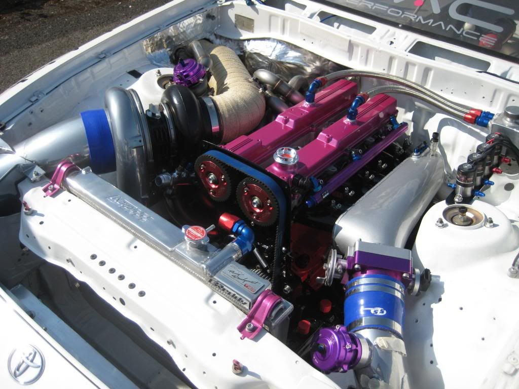

engine current spec is,
cement filled 7m block with oil mods,line bored with billet main caps,arp's,acl bearings.
6m crank,je pistons,race rings,h beam rods,hks 2mm hg,higher compression,
drag spec head with trd 272 with 11.5mm lift cams,custon valve inserts,1mm over size valves,custom dule springs,custom solid lifters,lots and lots of head work,everythings been done. oil pump drive shaft mods (even tho there is no oil pump in the engine the shaft has to be modded for the high rpm) billet oil pump drive pulley,billet cam belt ten, 2jz a.r.e dry sump system modded to fit 7m engine,electric water pump with custom water system,to name but a few. many thanks

Yeah we were very lucky with the cams they came from japan,we got them a long time ago,had to do alot of work to the head to just make the cams fit because of the really high lift. If we couldnt get the cams with the lift we wanted then we would of had some custom items made. many thanks

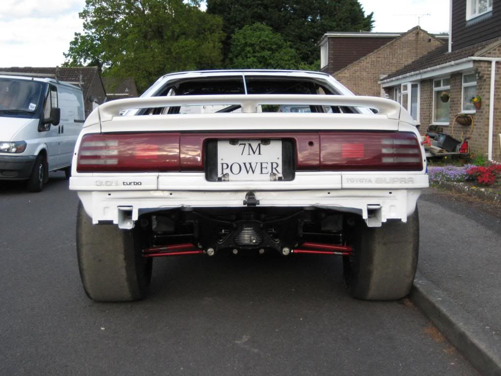

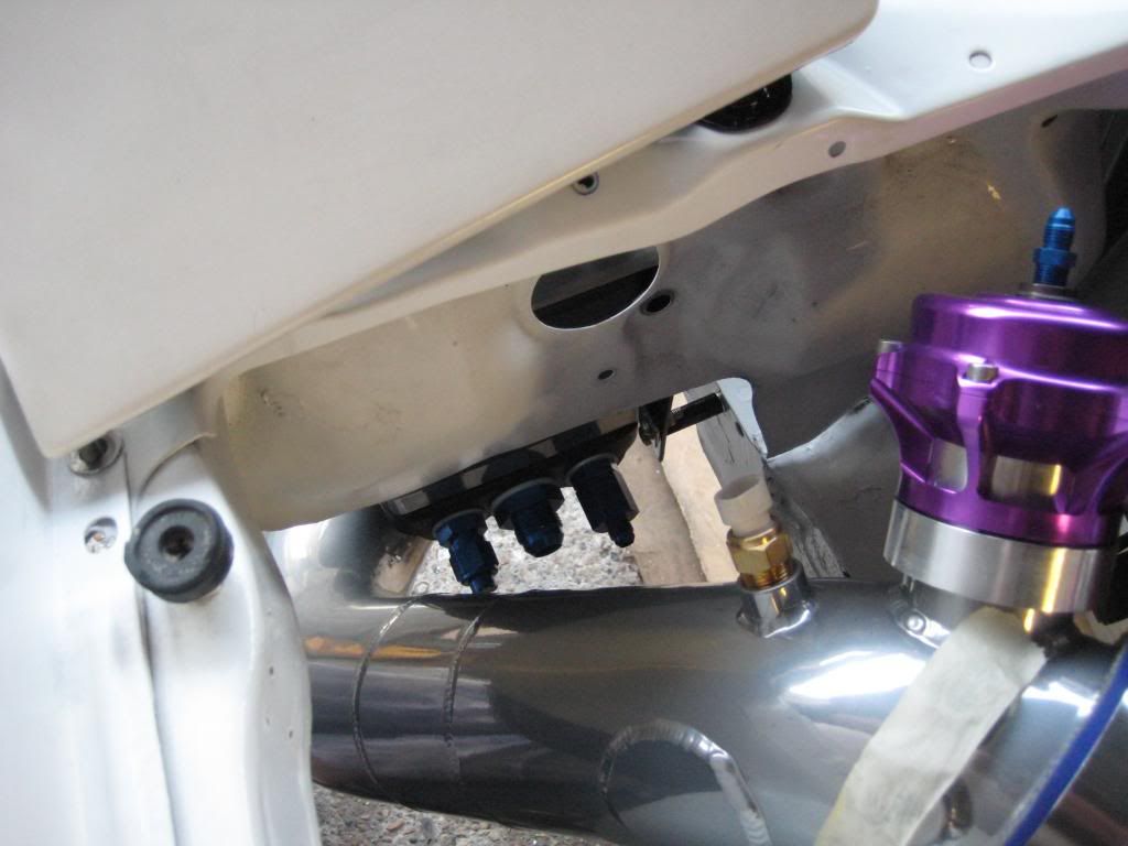

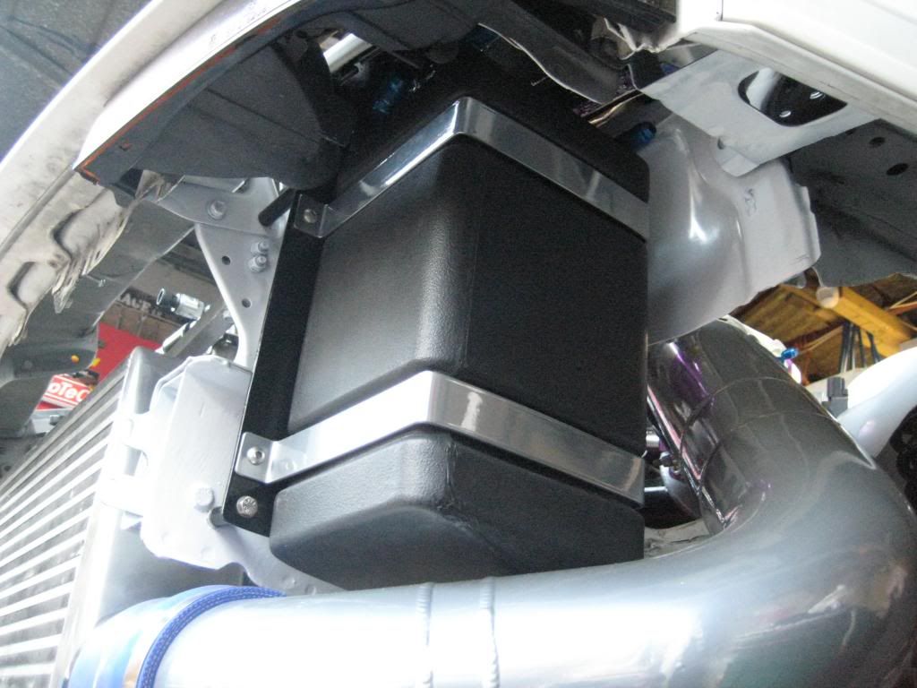

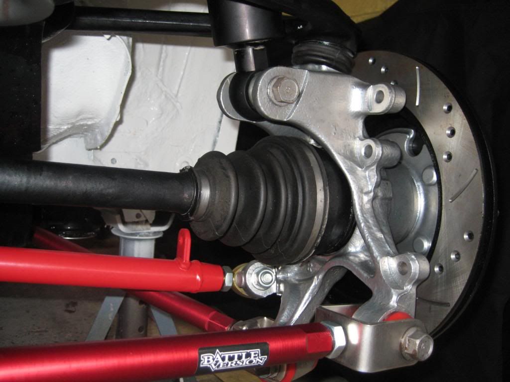

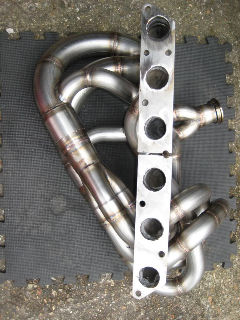

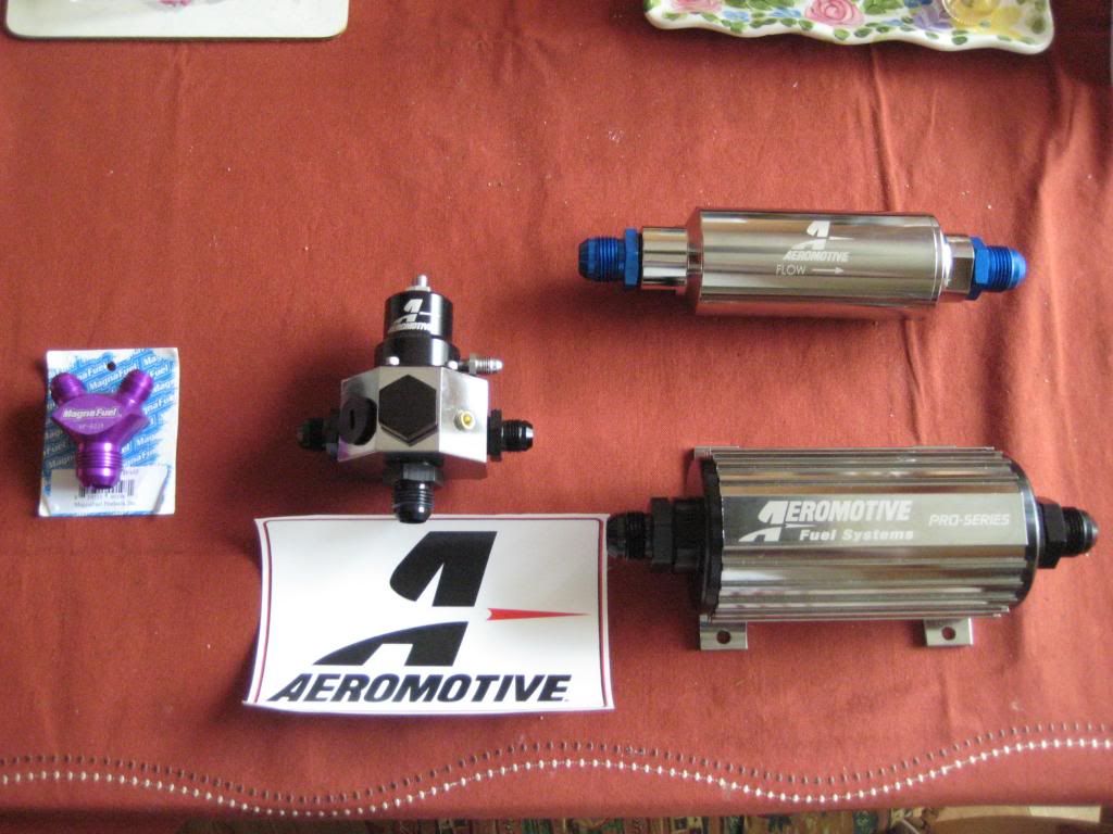

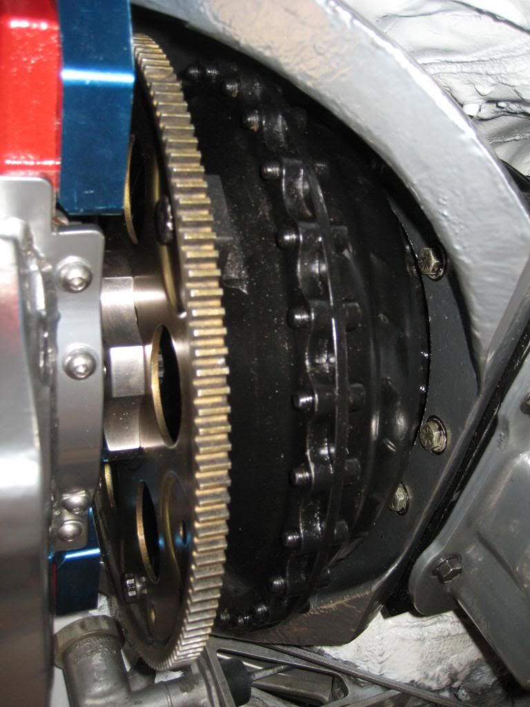

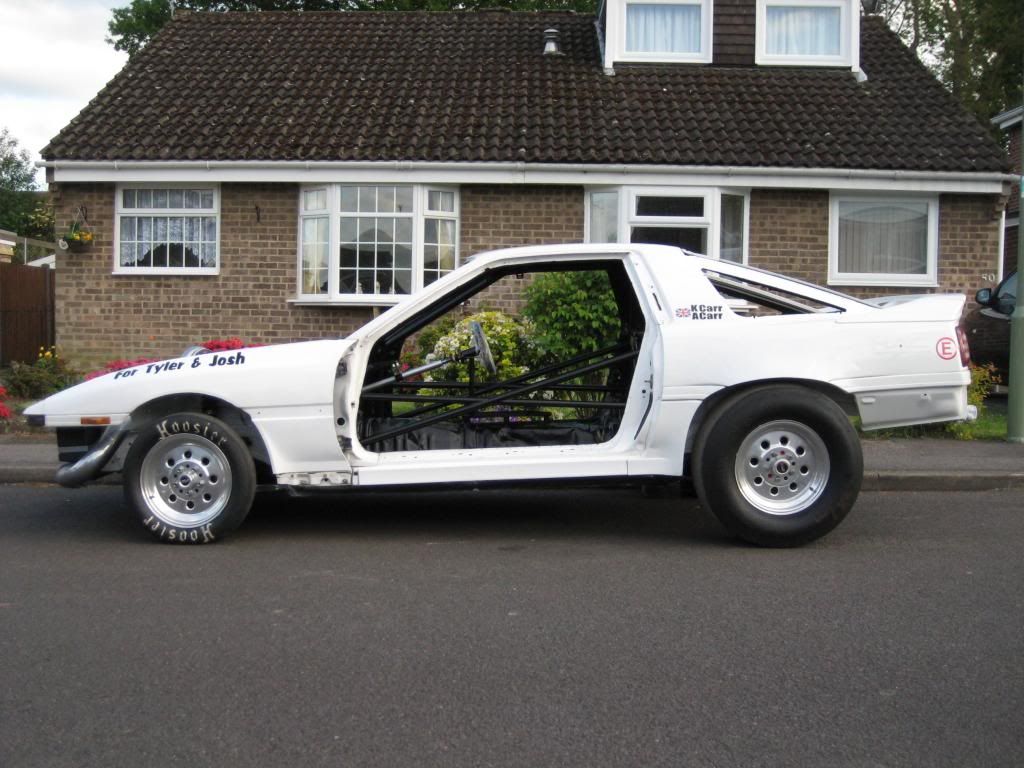

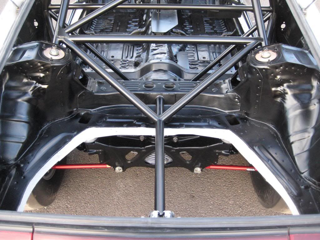

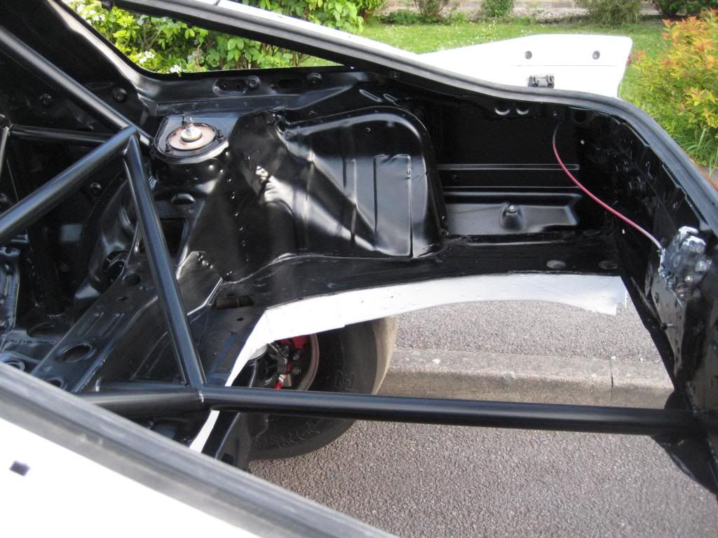

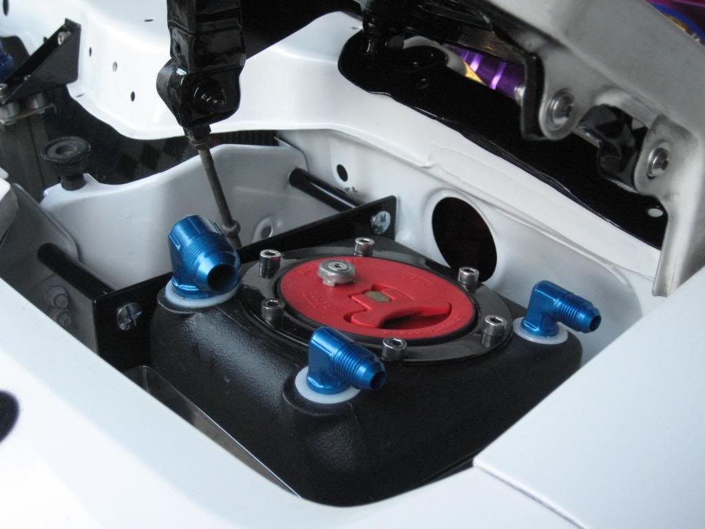

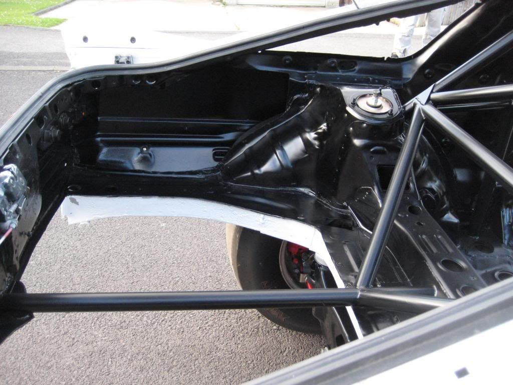

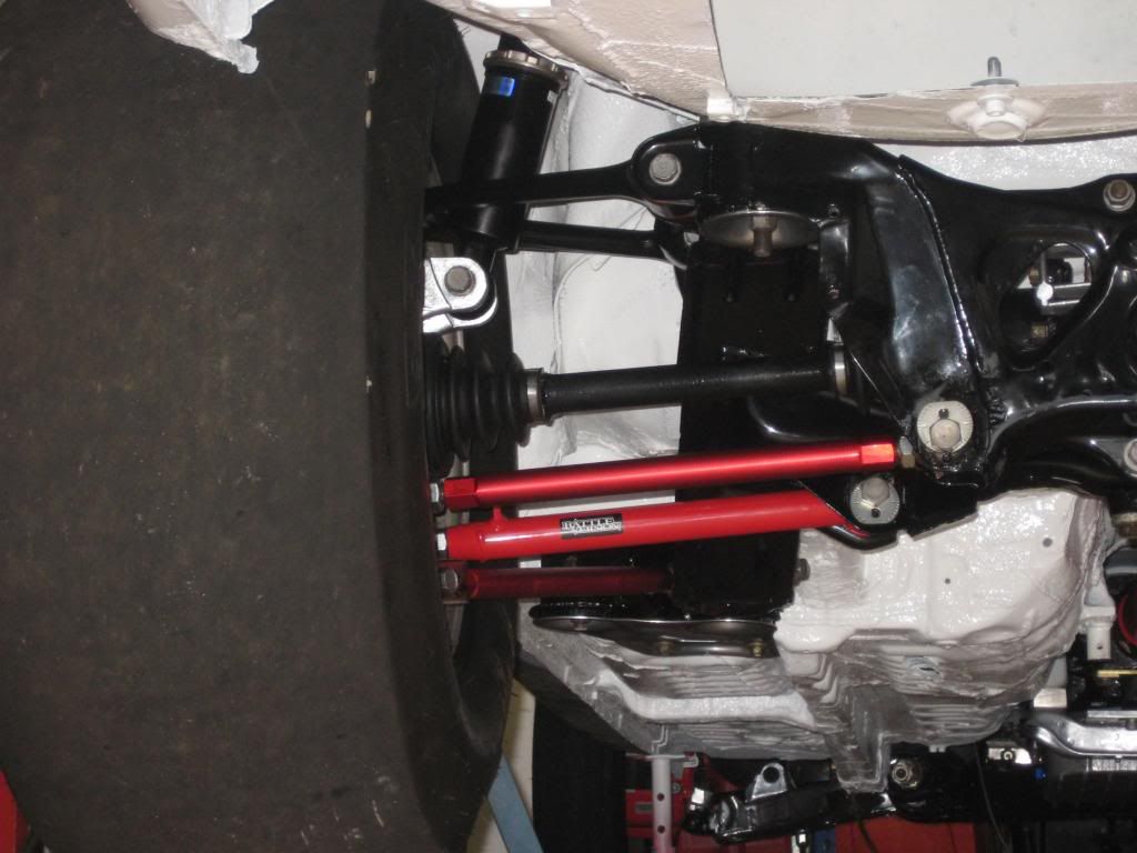

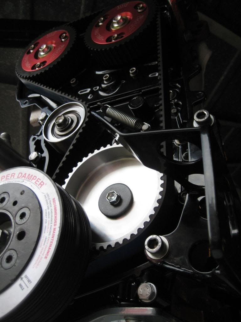

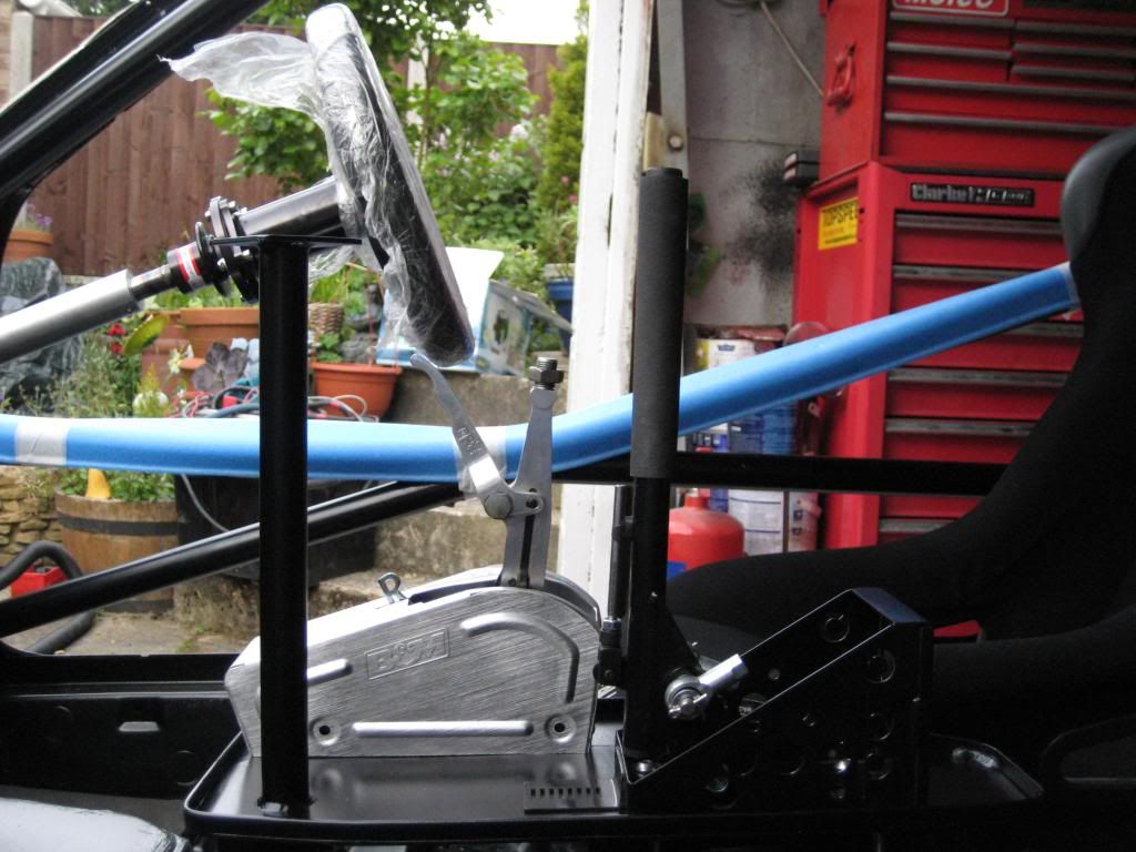

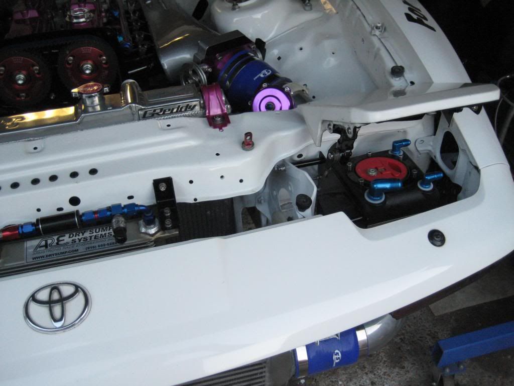

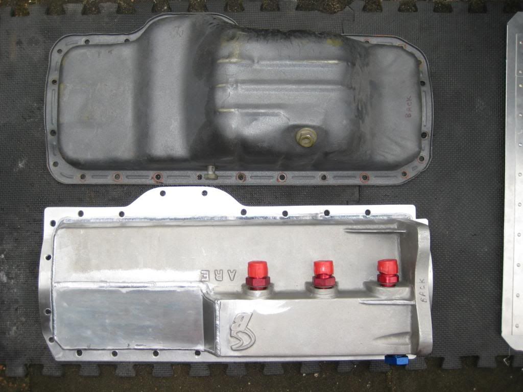

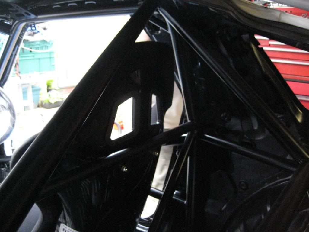

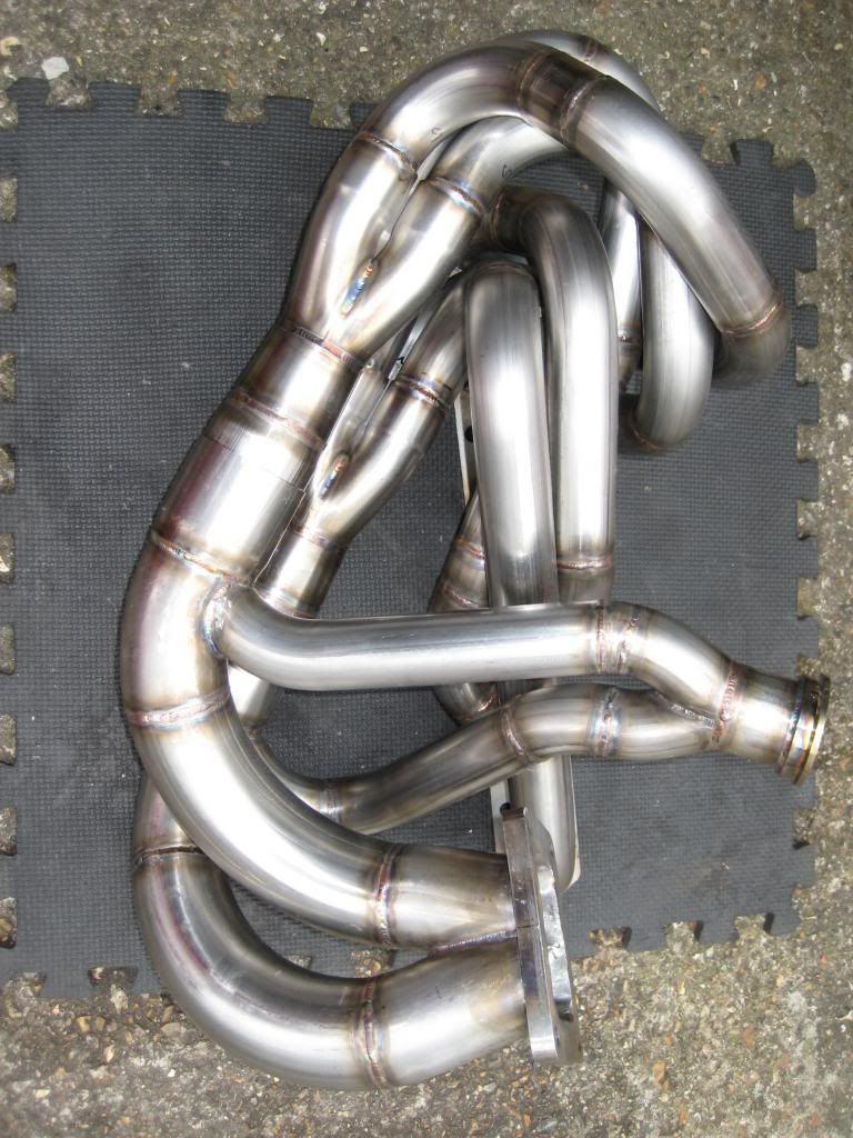

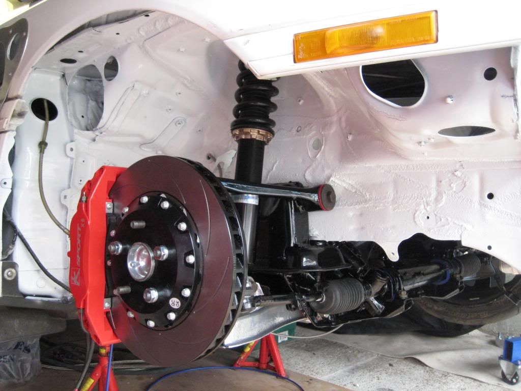

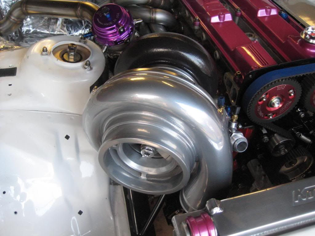

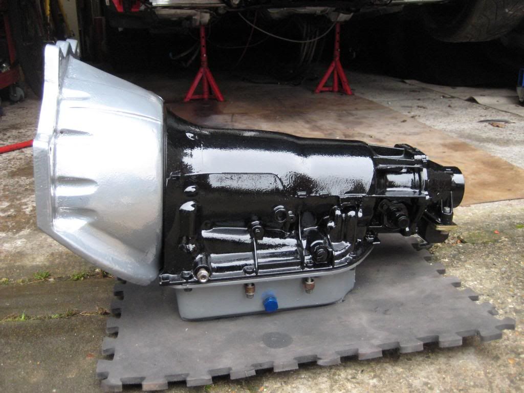

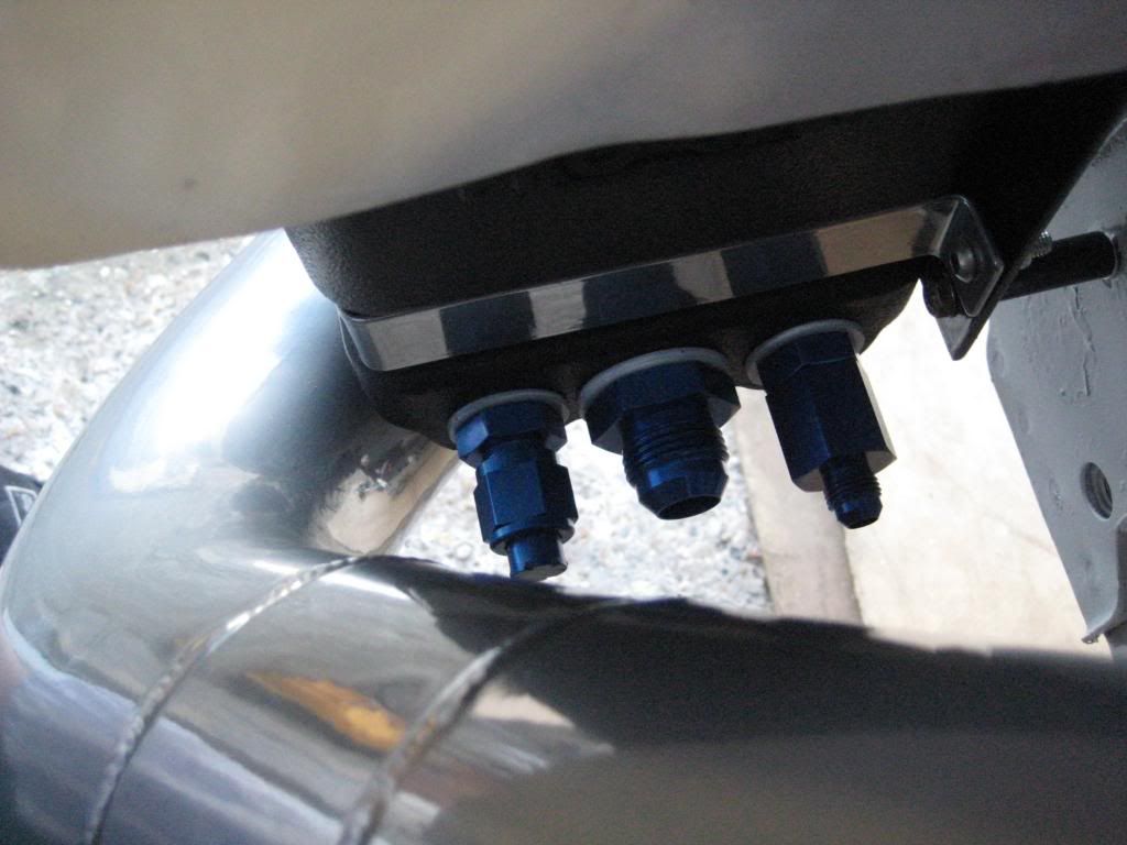

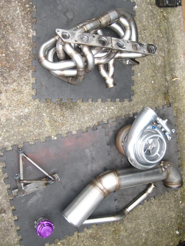

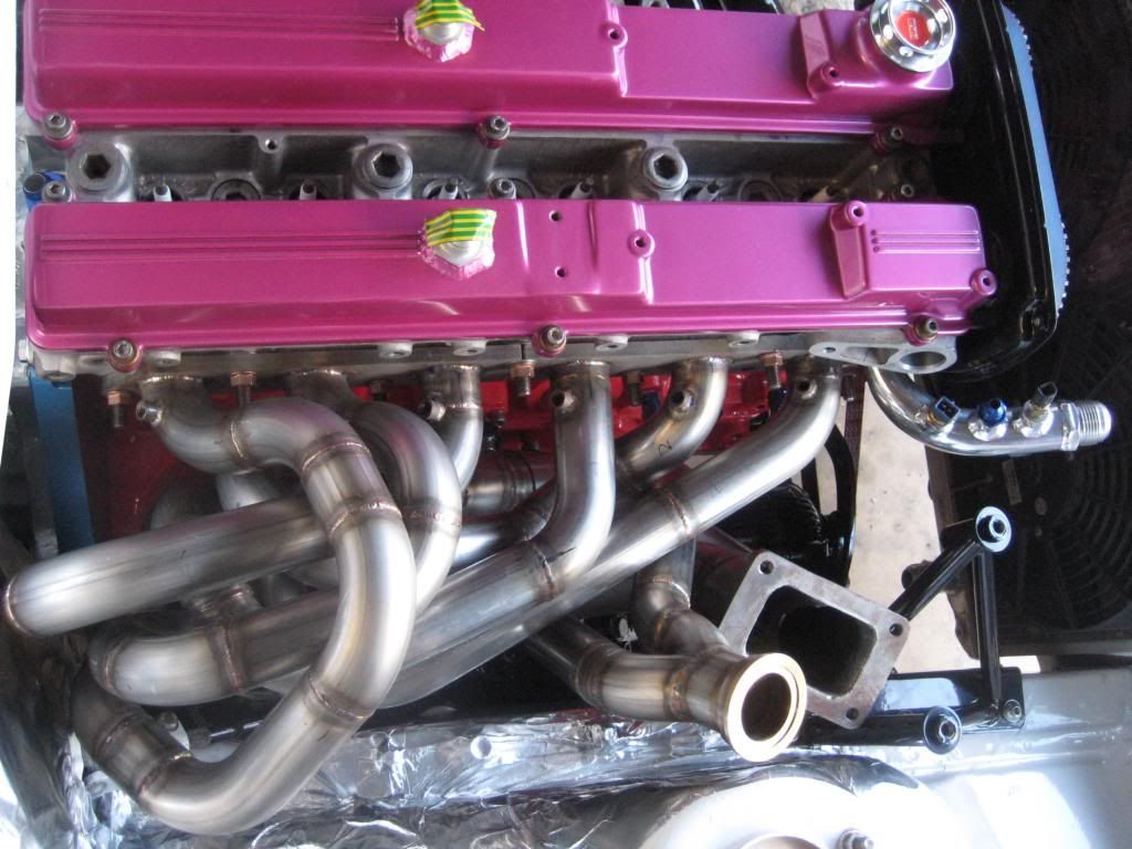

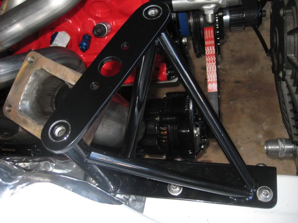

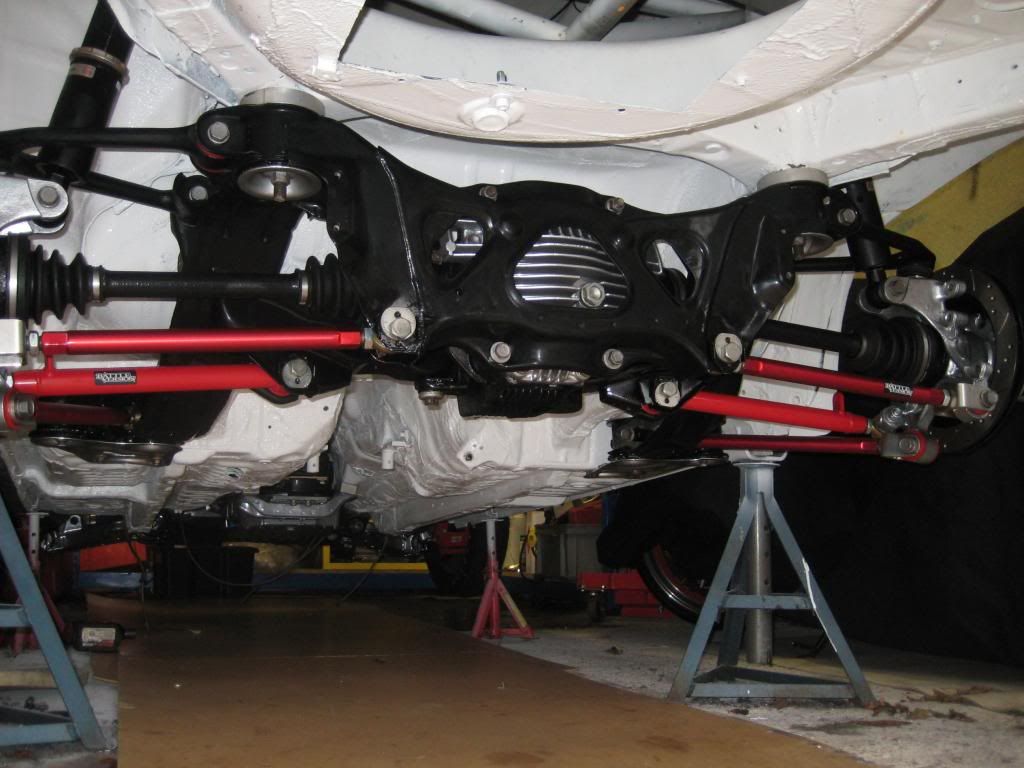

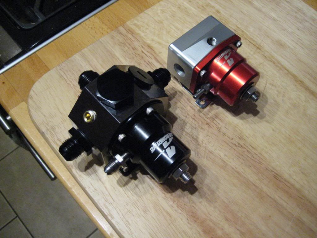

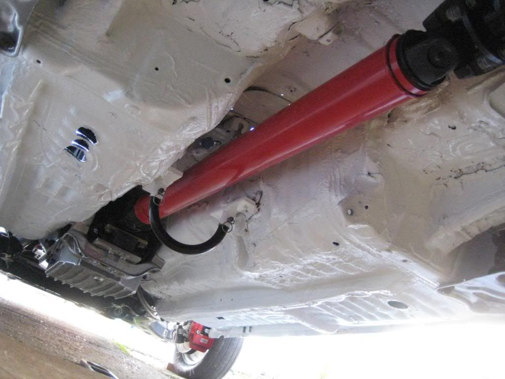

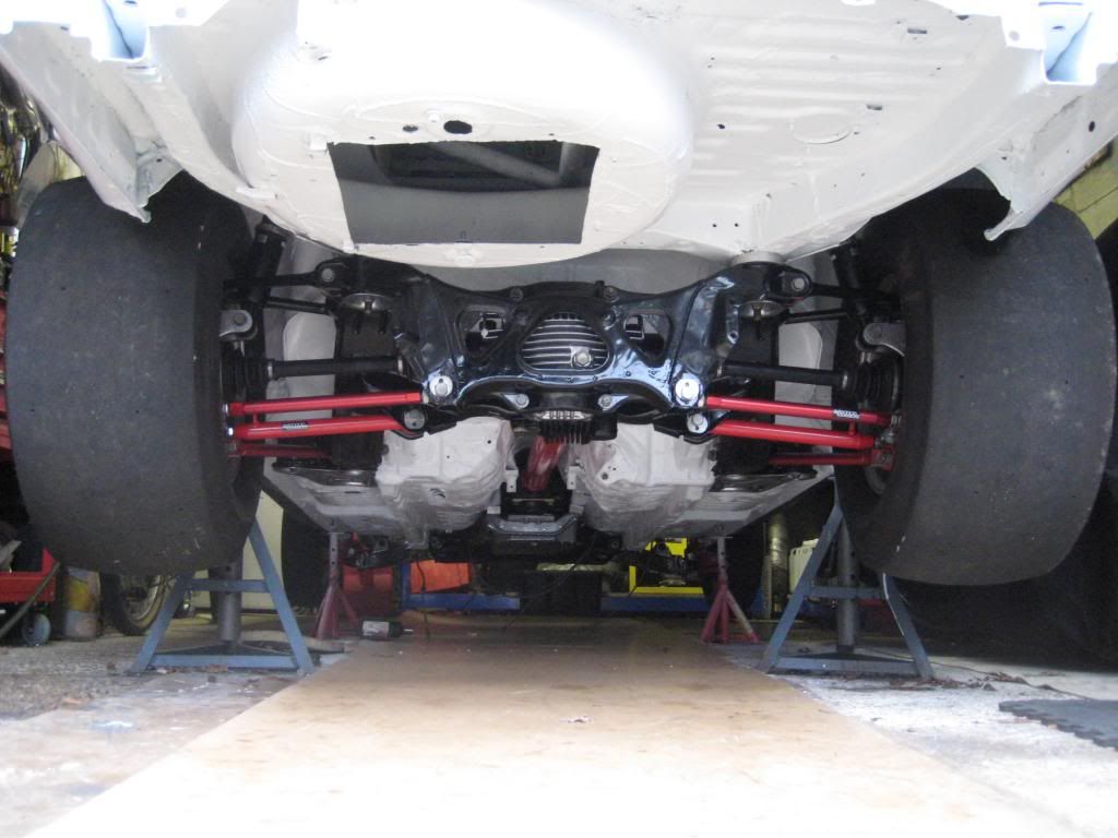

few pics of the current build from earlyer in the year.
