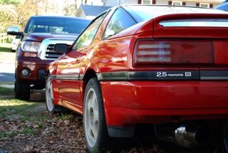

***UPDATE***

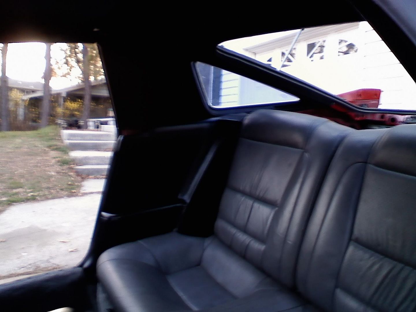

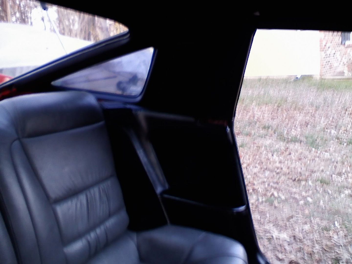

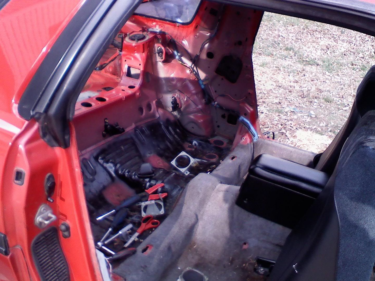

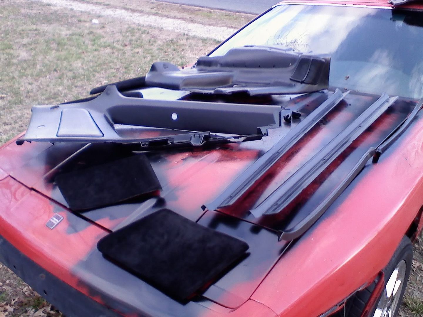

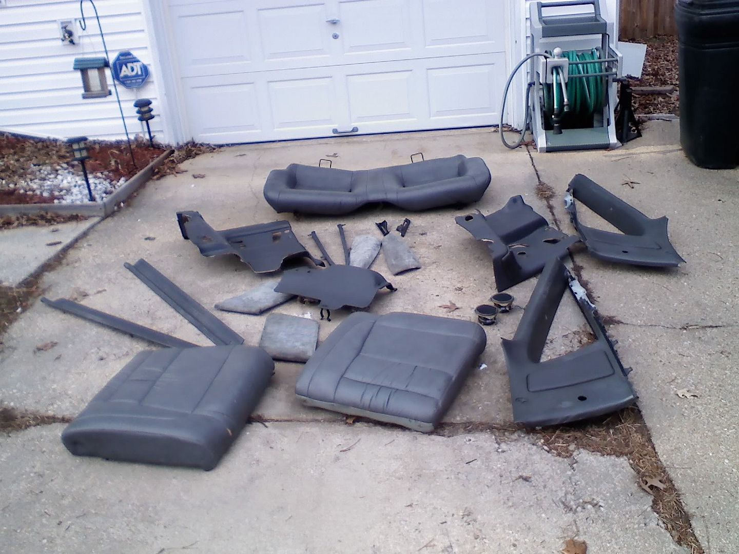

Ok today i decided to go mass with my supra took one look at my grey interior and said fuck it and just started going at it with a screw driver and this is what happen ...
It was just bugging me knowing i had black center console and door panels with grey panels in the back so i took it all out ...and about 35$ later it look like this .......
looks good i will take pics at better time when i have more light and with a camera not a phone

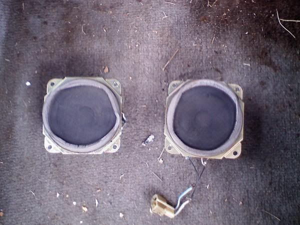

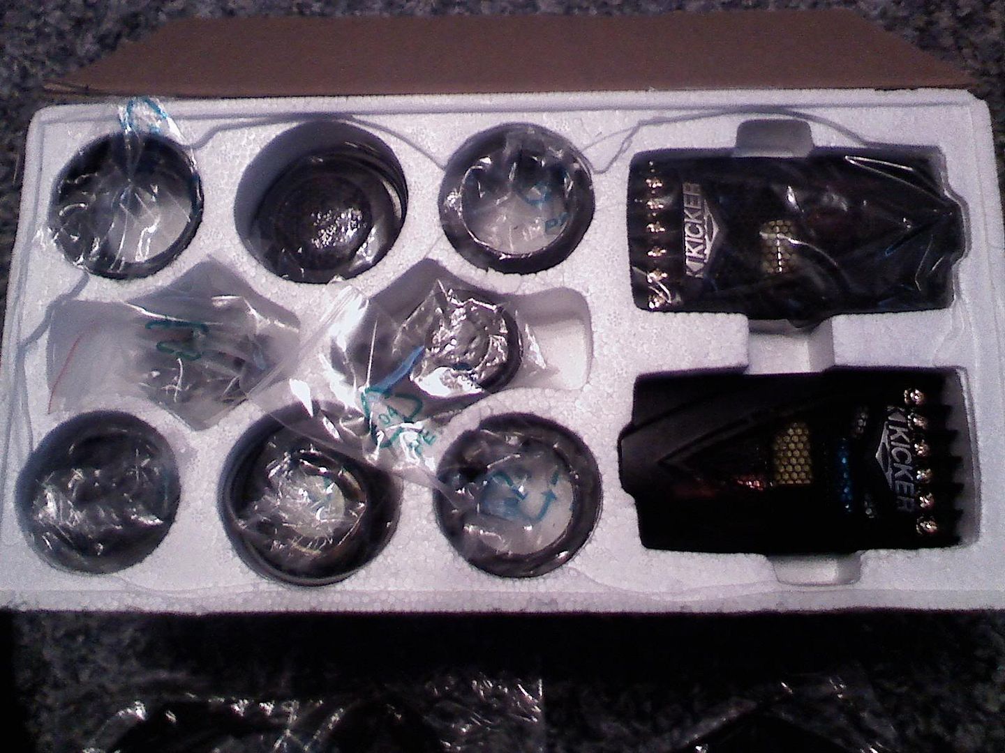

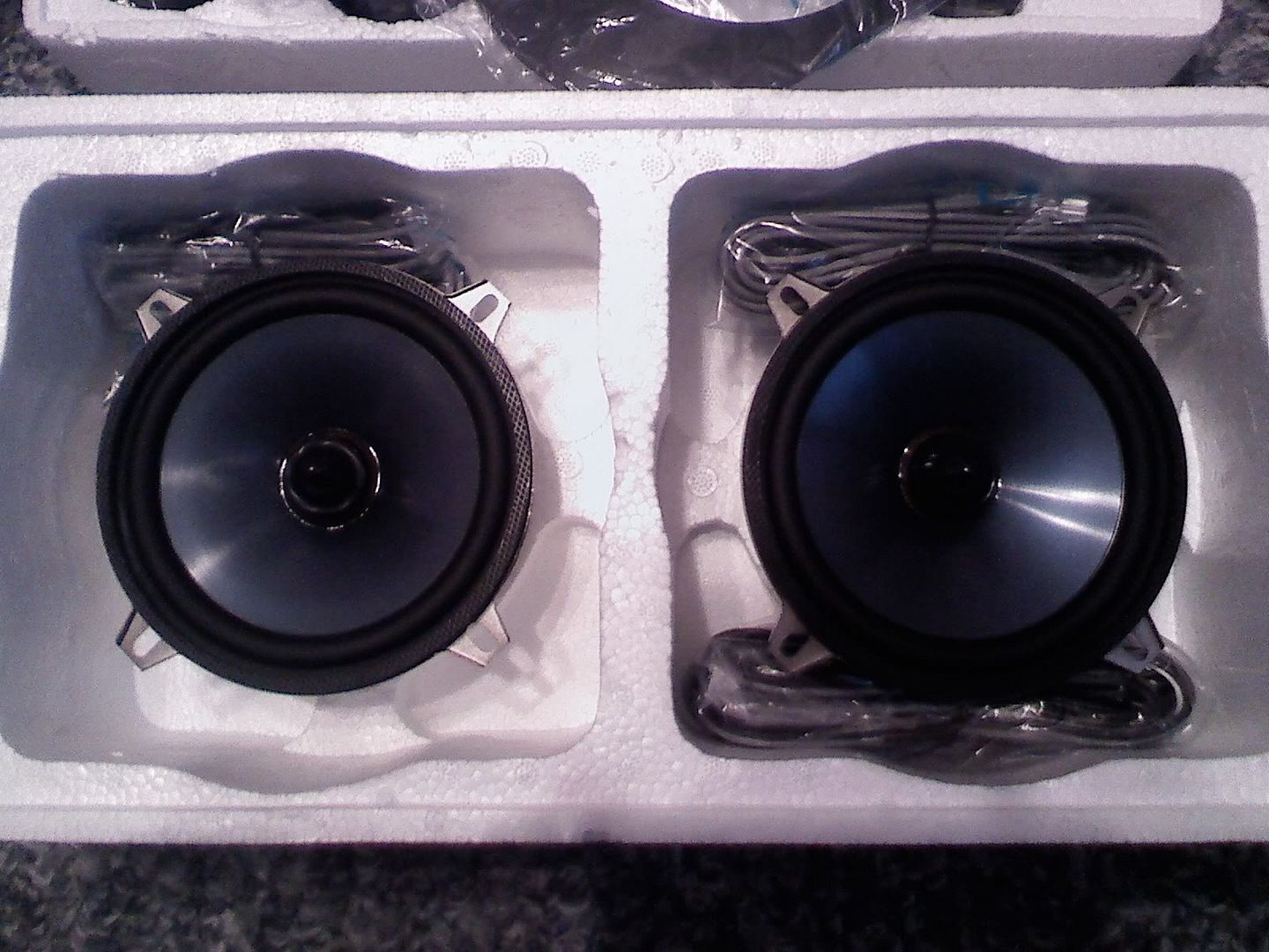

Took out my old cute little speakers while i was at and picked these up for 20$ thank you circuit city closing and employee friends ....
OLD
NEW TWEETERS
NEW SPEAKERS
I ALSO GOT TIRED OF THE GREY DOOR TRIM

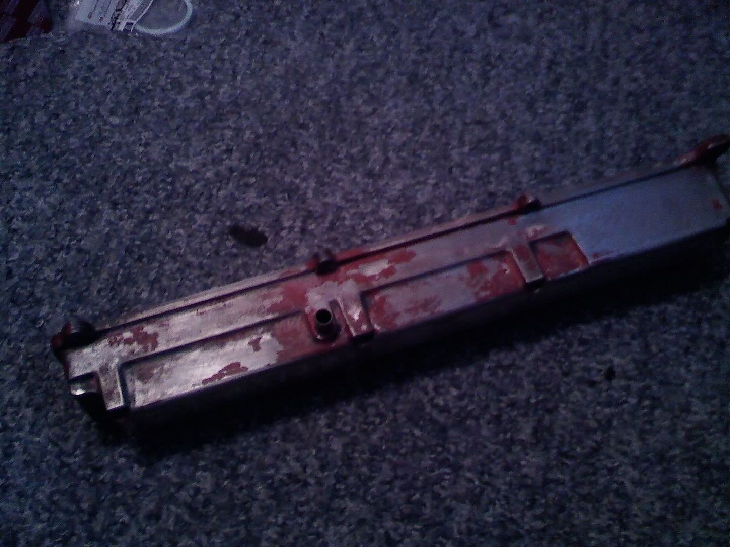

So i guess you could say i started my color change for my interior...Hope fully tonight ill b smart and stay home and finish polishing my valve covers

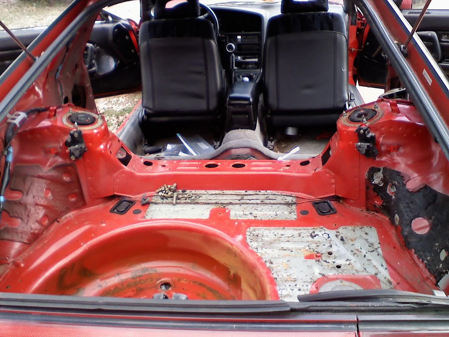

tomarrow if its nice out i plan on installing fog lights ,removing rear end out of shell (373 LSD rebuilt) and fuel tank (for friend) which has a Walbro 255 in it (mine)

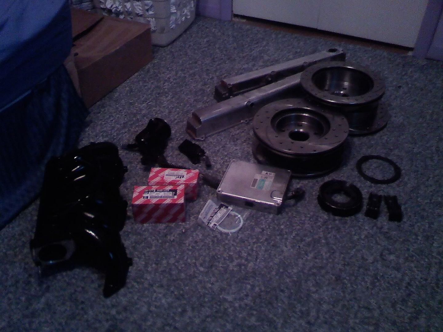

OK so i ordered my HARENeSS FINALLY!!!!!!!!!!!
plus DM ss brake lines and d-belt

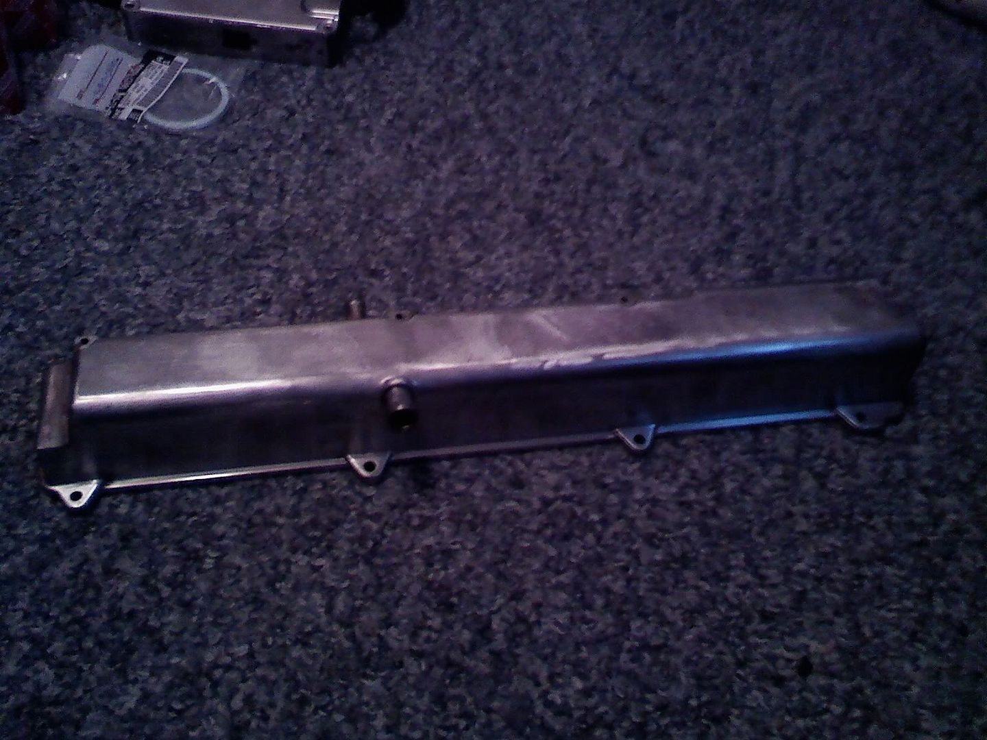

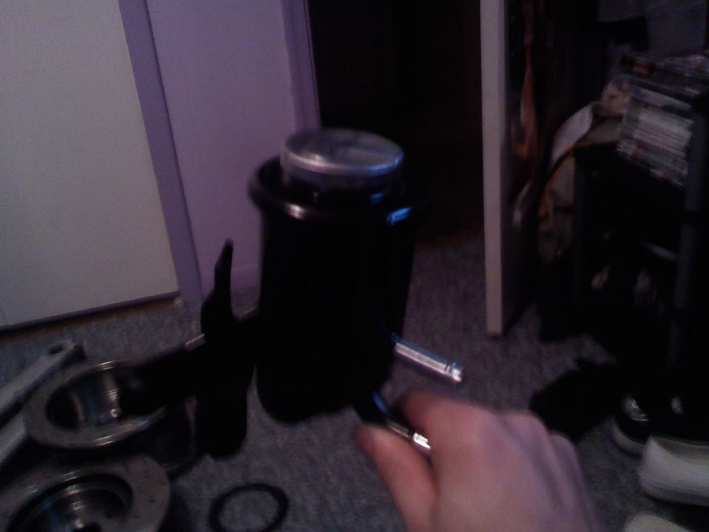

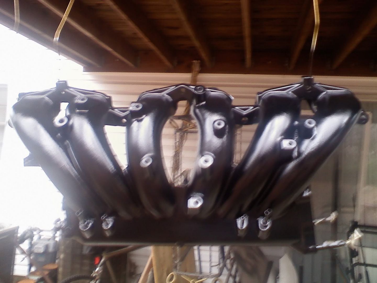

got rotors and pads and painted my manifold and p/s reservoir
also started polishing my valve covers my plans ot paint wheels goes into effect tomarrow im a sand blast them

MA70witBoost;1292898 said:
the car is comming out nice man. good job on the interior. Hopefuly you prepped it right and wont have the paint flaking off later on like mine is. :\
paint? for the vynil stuff you use vynil dye, it works and doesnt flake off. just has to be super clean or it wont dye the material.

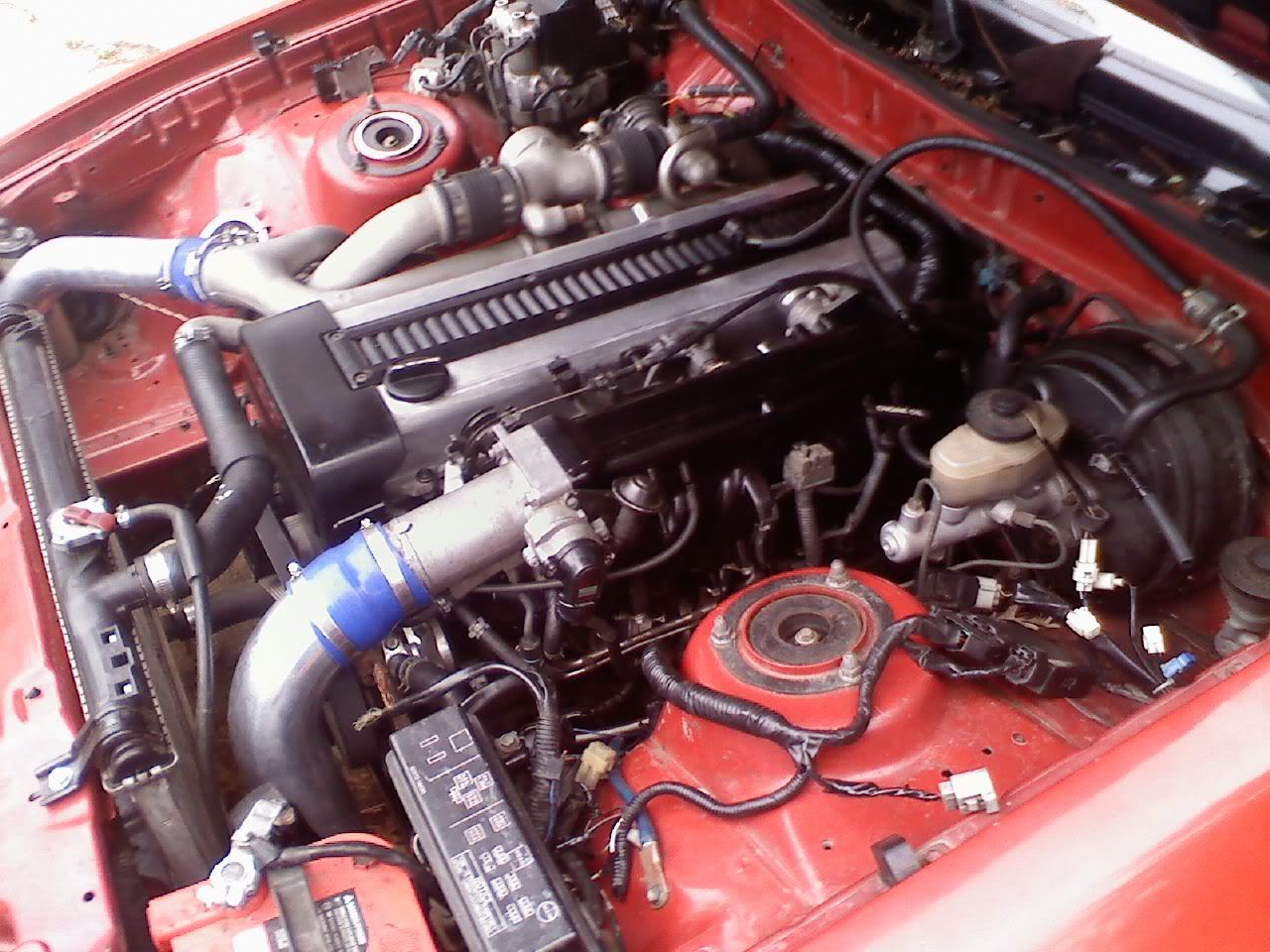

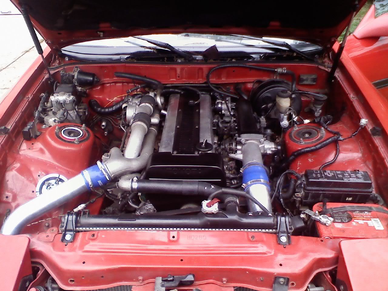

OK so i got the harnessin and i got nothing no power nothing so i was troubleshooting shit and checked everyting electrical come to find out my fuse box inside was missing all the fuses so after fixing that i still didnt get power .So i did more trouble shooting and my power wire was missing a wire to the battery so fixed that an bam got power, but then she would start she was cranking but no idle so i sprayed inforce in the intake to check for spark that passed checked fuel and had no so fuel pump will b replaced to a walbro tomarrow hard wired to a switch ..but heres a pic for now how it looks with new polished cam covers and black manifold
THANKS : SLOWSC3
Slow_Sc3
I beat bikes dude
Apr 2, 2005
401
Maryland
1) get the last power steering line and hook that up.
2) coolent hose on the back of the IAC isnt hooked up.
3) fix all your vac leaks on intake manifold run one of the lines on the intake manifold directly to the boost gauge.
4) your bov needs that rubber hose to work or else youll just blow the twins up.
5) double check all fluids ( engine,trans, coolent, ps)
6) hook up speedo cable.
7) install new brakes and bleed the lines.
go for a test drive and have some F'in fun!!!!

naw man honestly all i used was rattle can and clear but thanks alot
matt wtf hose r u tlkn bout for the BOV and boost gauge?
