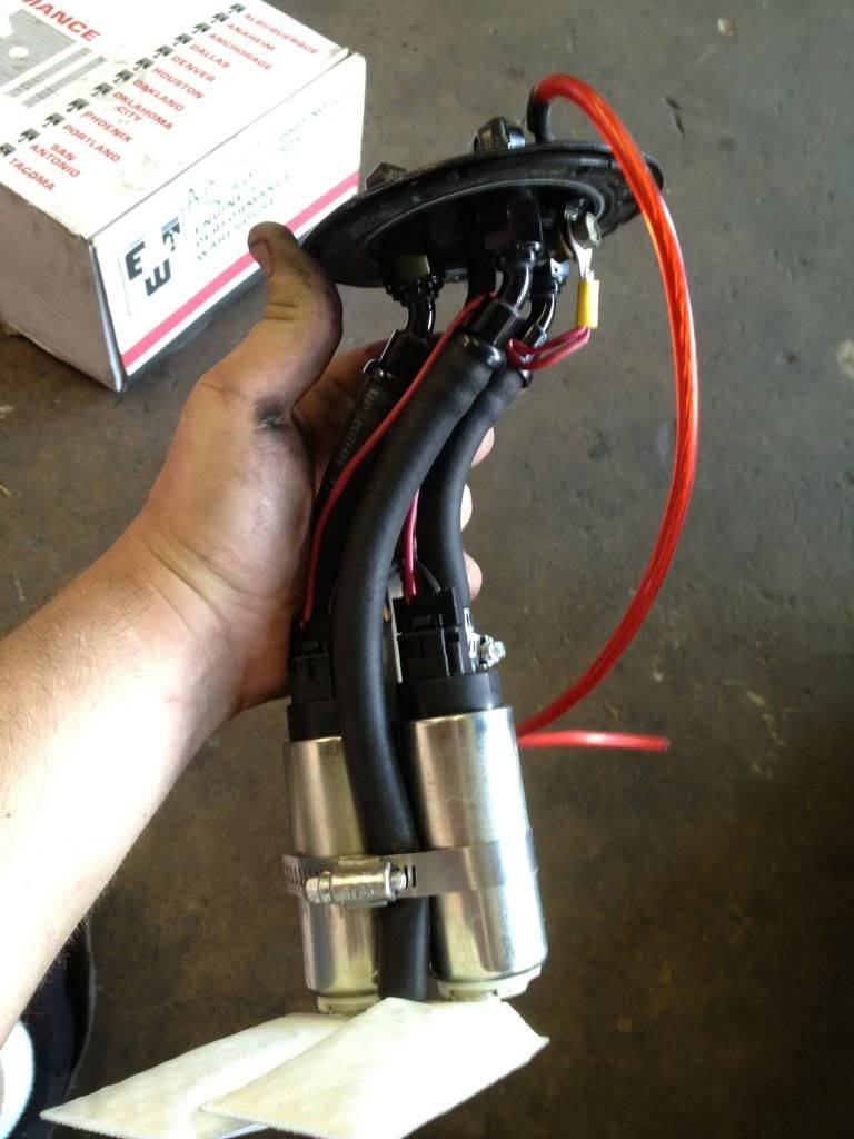

Tiny updates, nothing fancy... little by little :)

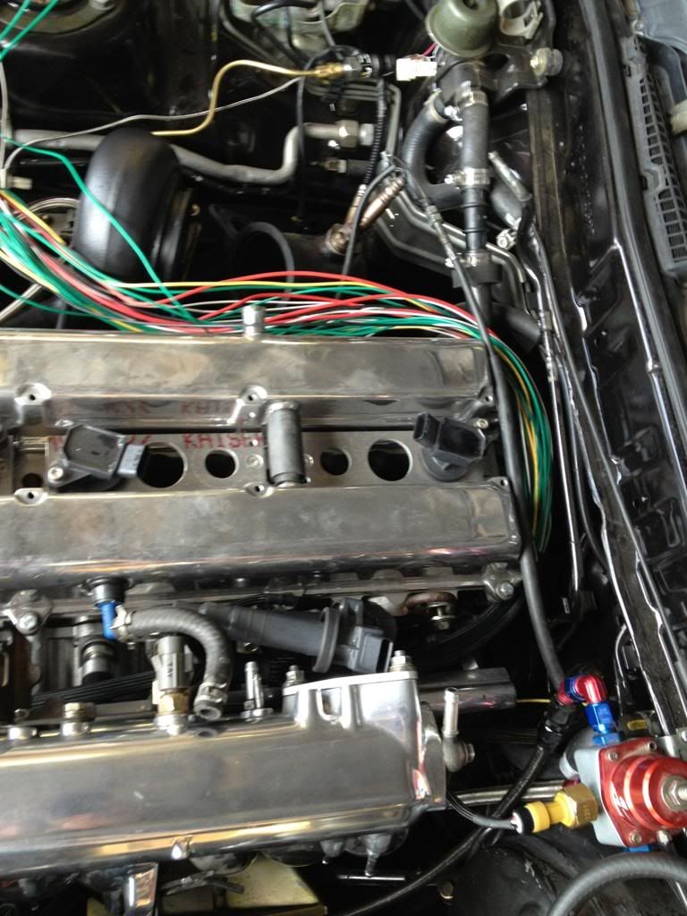

wiring and sensor on AFPR

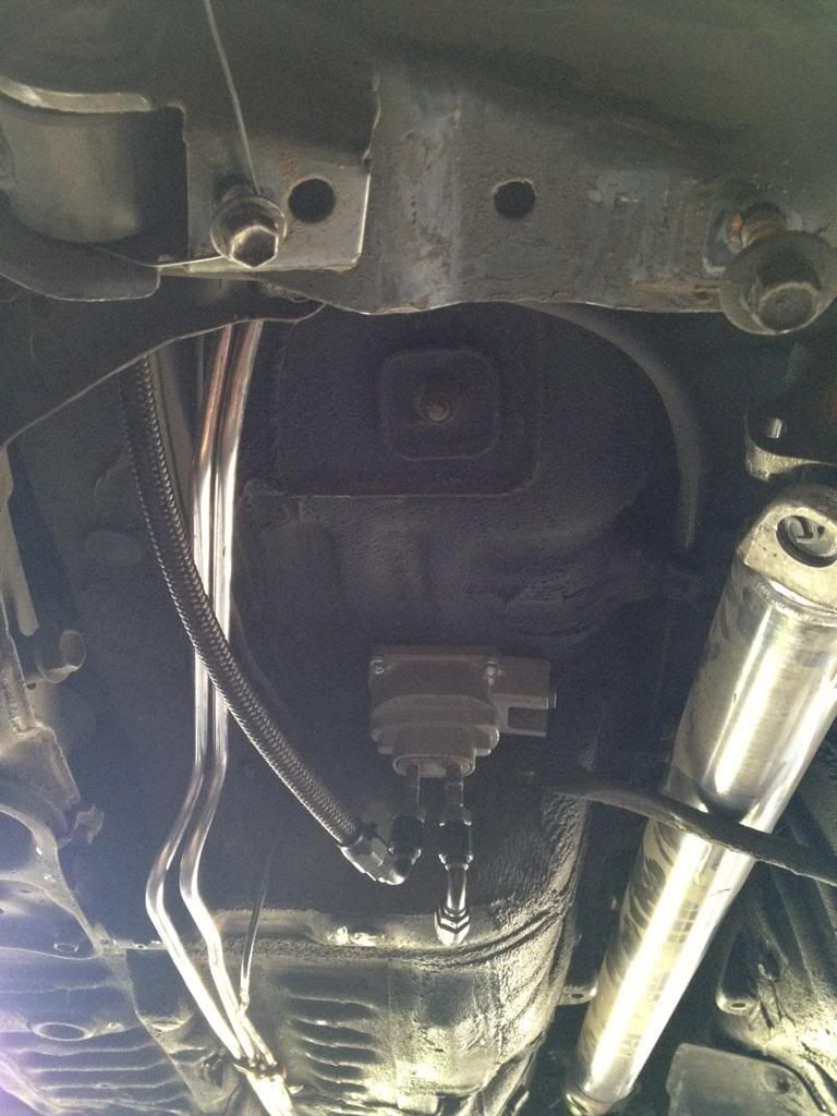

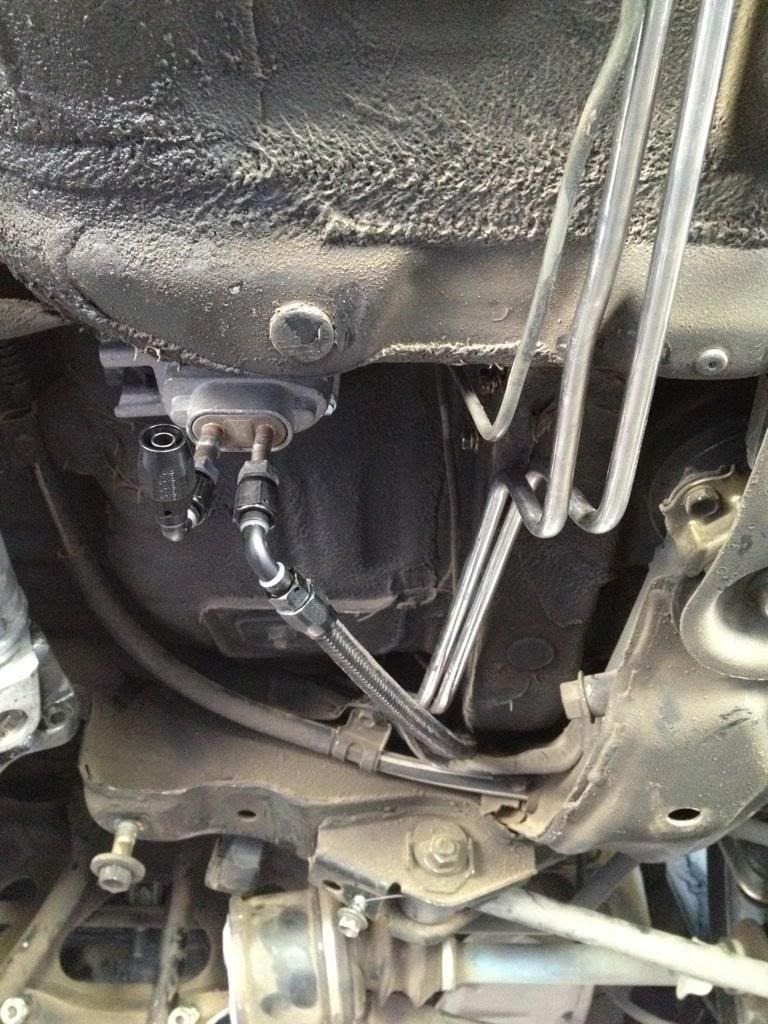

Dual Fuel pumps :)
I can make good use of this :).

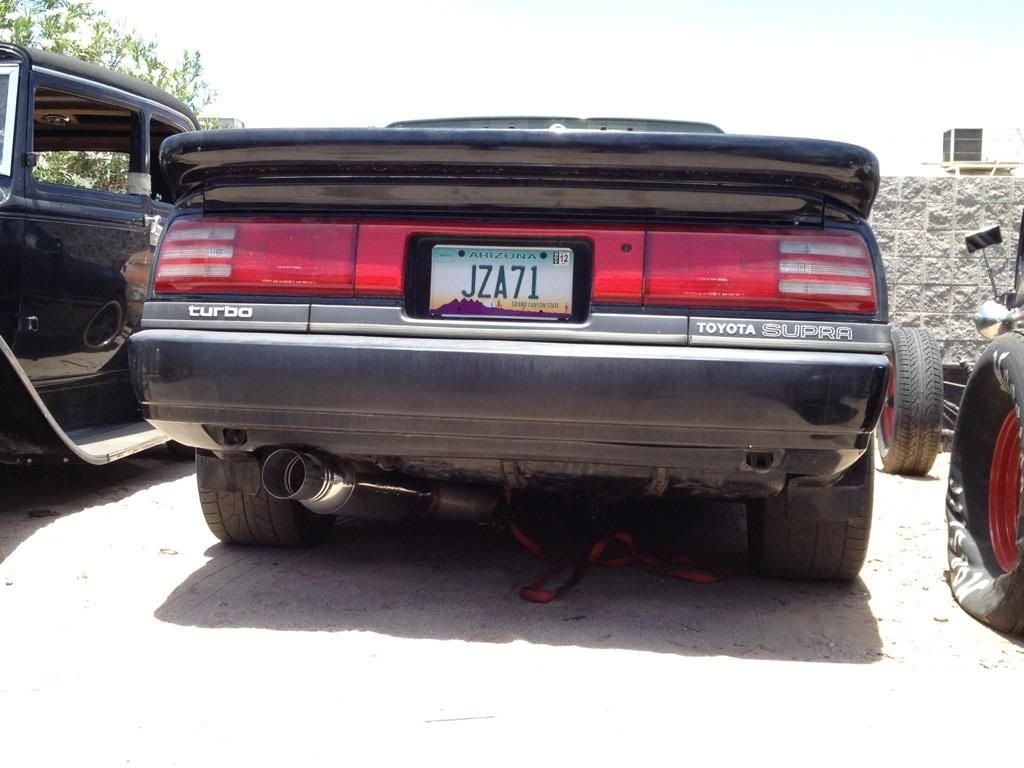

Mmmm... corn fuel! So when are you gonna get you some Works or Panasports Clint? Not saying the ADR's look bad, just wondering. :)

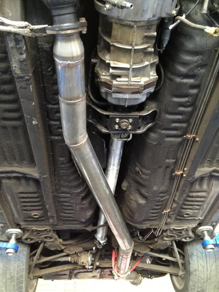

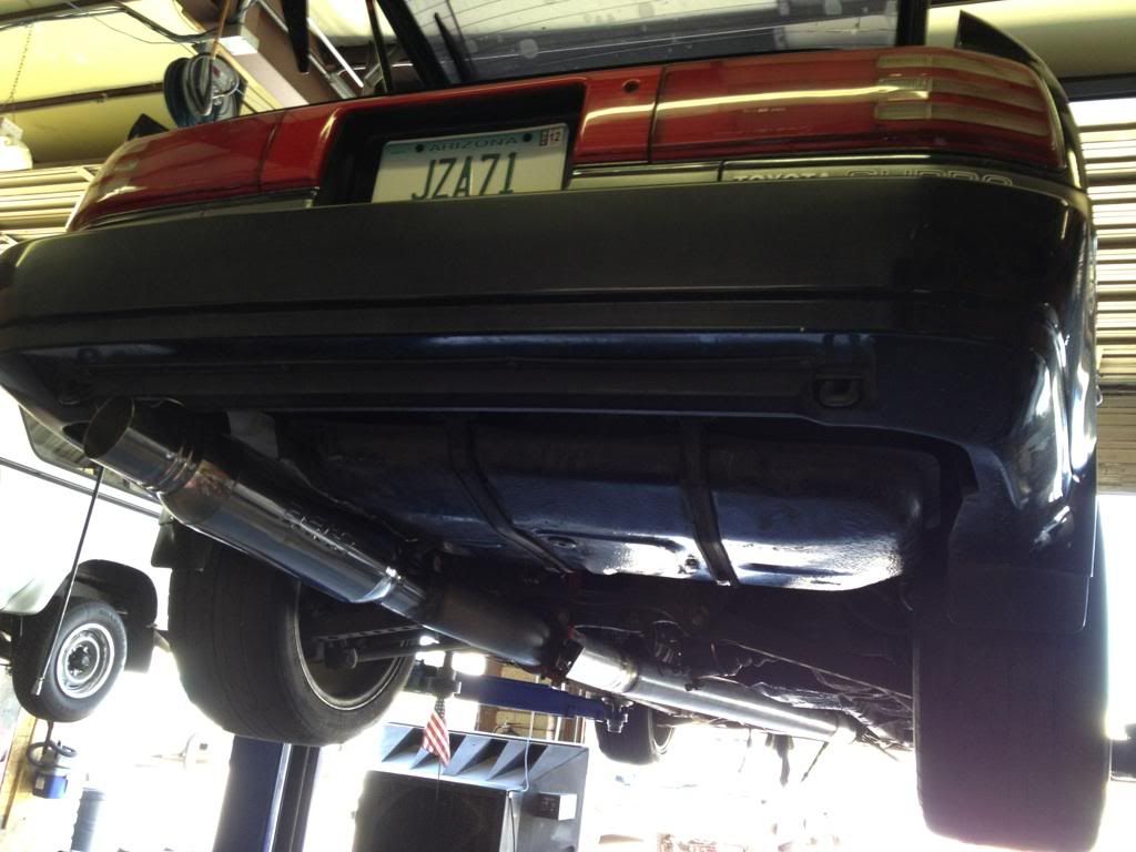

How's that exhaust sound by the way? That's an Aeroturbine muffler, correct?
I do not know how the exhaust sounds yet because the car is not running but yes it is a aeroturbine muffler.

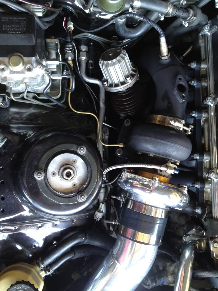

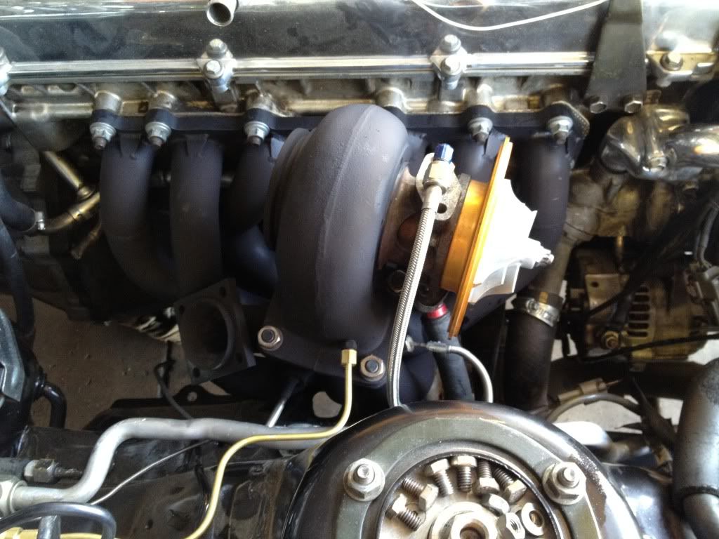

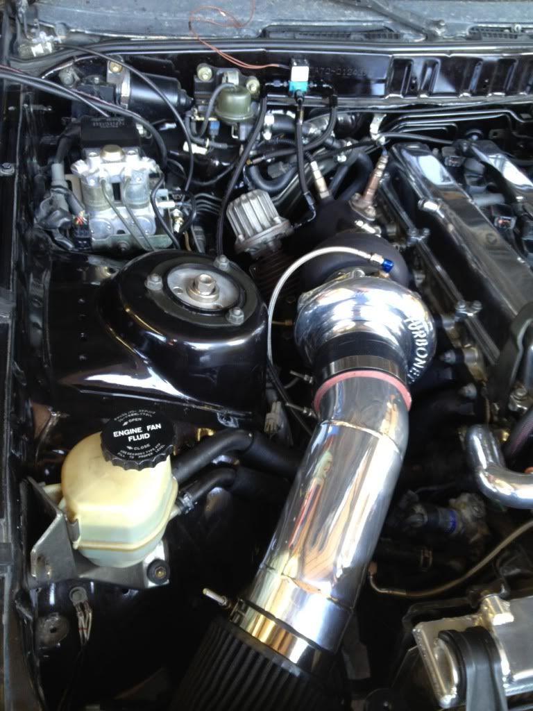

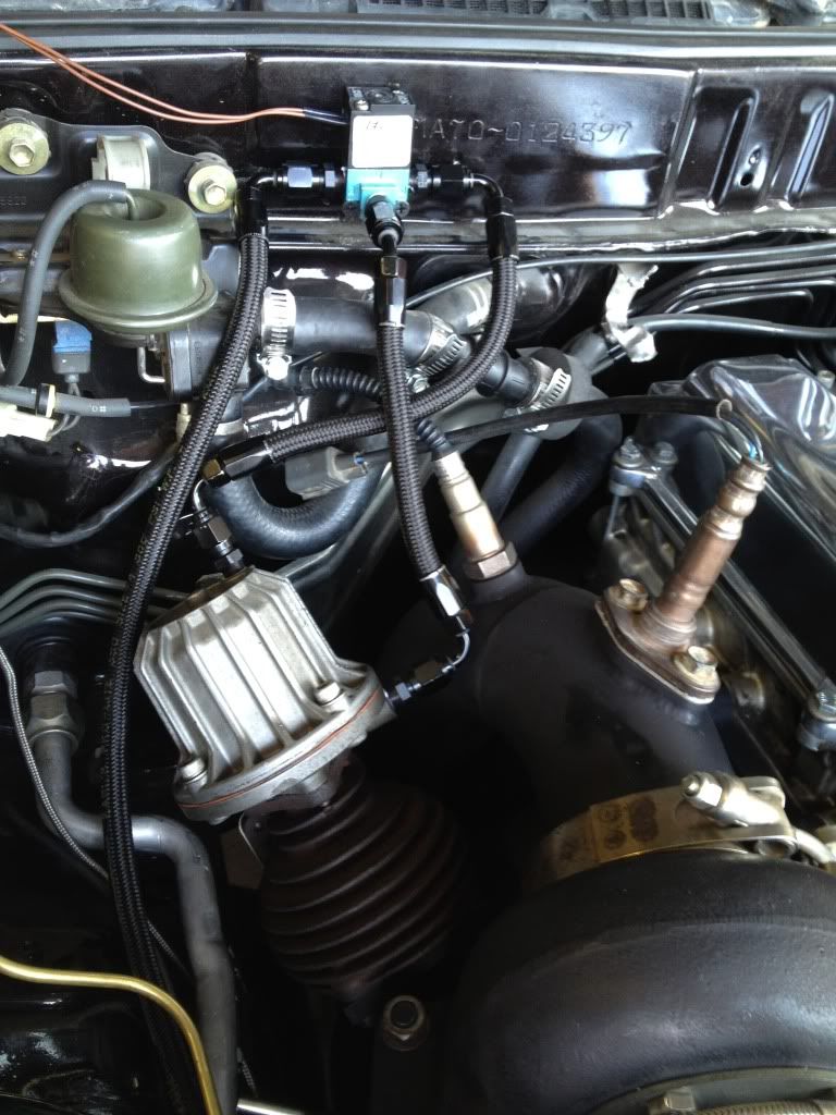

That boost control solenoid is hooked up unlike any other way I've seen them set up- is that an error or a completely new style? (I fear error)
Thanks for fixing the link and good catch, yes it does seem that the solenoid is connected incorrectly, according to AEM's website...
EDIT: According to this boost_solenoid.jpg there are other ways in hooking up the boost controller with external wastegate.

Seems like the WG would hang open given that design, but again- I'm open to new ideas, plus it does look very clean!
Not to mention all black -4 an fittings with matching hose, I'm so jelly!
