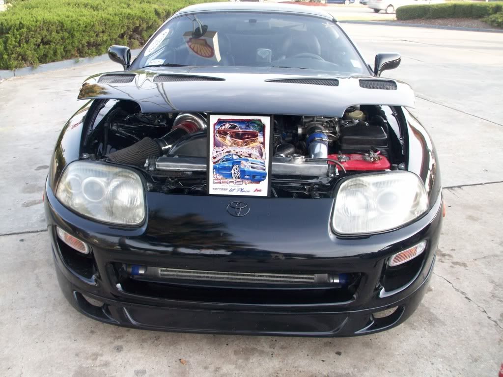

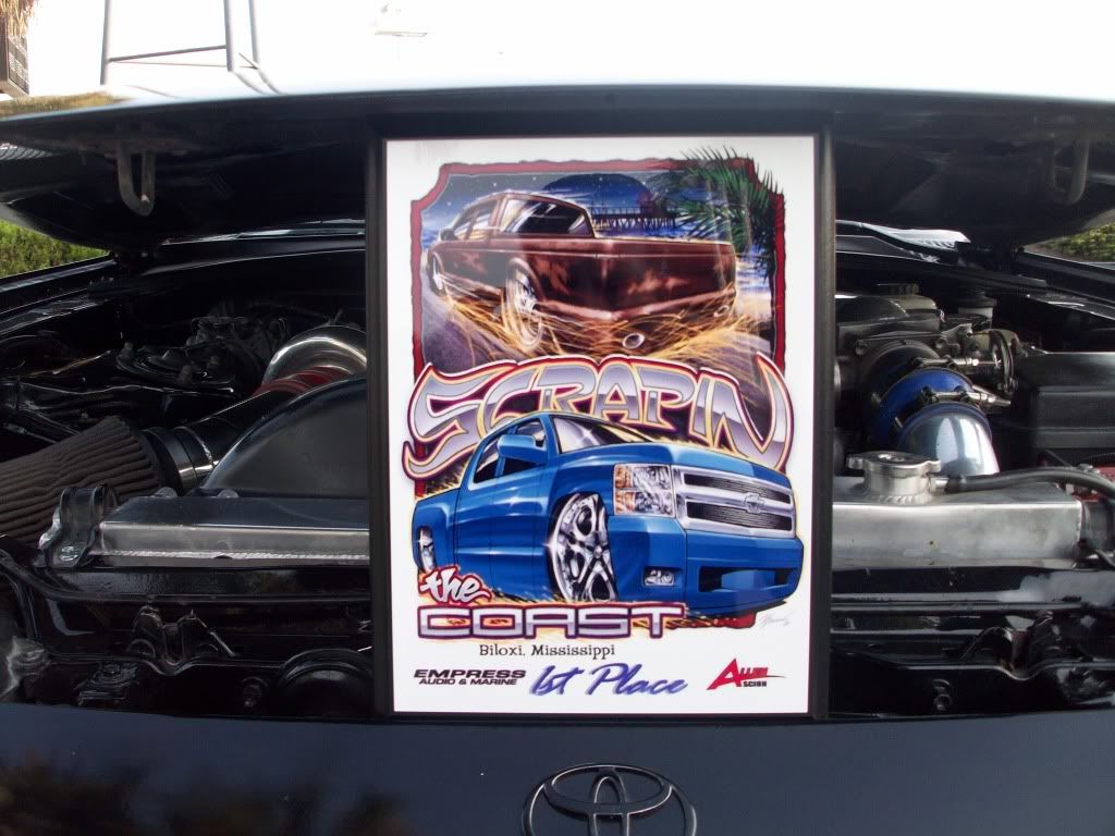

a few pics taken by a friend at scrapin the coast 09 with an actual real camera, not a POS like mine. For those of you that don't know, that is the biggest car show in the south with 6000+ people in attendance, and often 1000+ cars. I won first place in toyota class for those that care.
Sorry all the pictures have girls in them, I'm soon to get a professional shoot done by another friend.
And a few of the pictures that I took.
