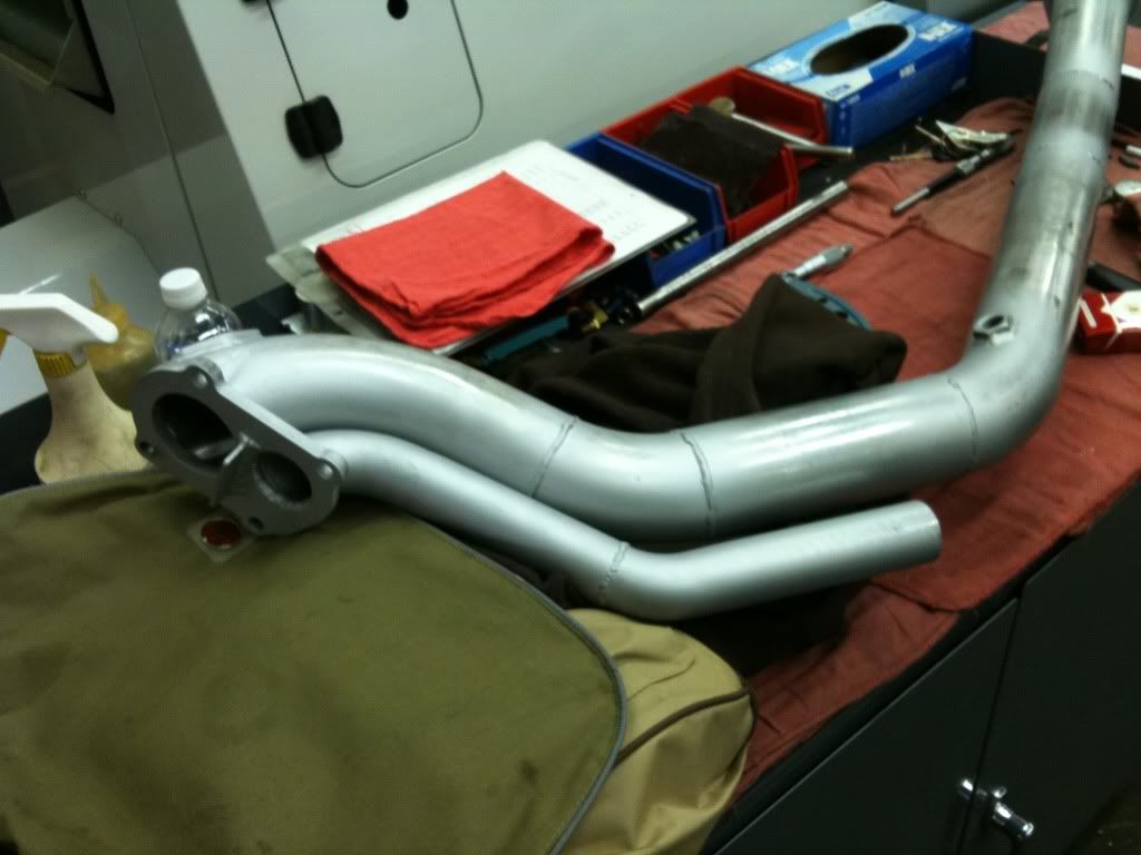

Also, eBay has a great DP on sale for around $250~$260. It recirculates the wastegate exhaust back into the system but needs the extra "lip" welded on to make it divorced. Here are some pics of it...
picture.php
picture.php
picture.php
The Flowmaster Super 40 3" muffler makes this work VERY well. :evil5:

The chinaman DDP's fit for crap and have the flex section in a bad spot. Trust me, I have one from the first run of them...

Drake69;1493984 said:
Don't know if this was already mentioned since I skimmed through this thread, but using V-clamps would allow you to change out and modify your stuff if you need to change things around, like for exhaust laws or noise issues.
Here's a pic of my set...
picture.php
picture.php
picture.php
picture.php
There is no divider that separates the turbine from the wastegate...another reason the eBay pipes fail:-(
this how it's supposed to be.
That's why after I bought it, Seth welded a metal divider on to separate the turbine from the wastegate. Should've added that bit of info in.
EDIT: I DID mention that...
Drake69 said:
It recirculates the wastegate exhaust back into the system but needs the extra "lip" welded on to make it divorced....

i have the Driftmotion / ebay DP. only issue is it needed to be grinded down a few mm for the gasket to match perfect.
