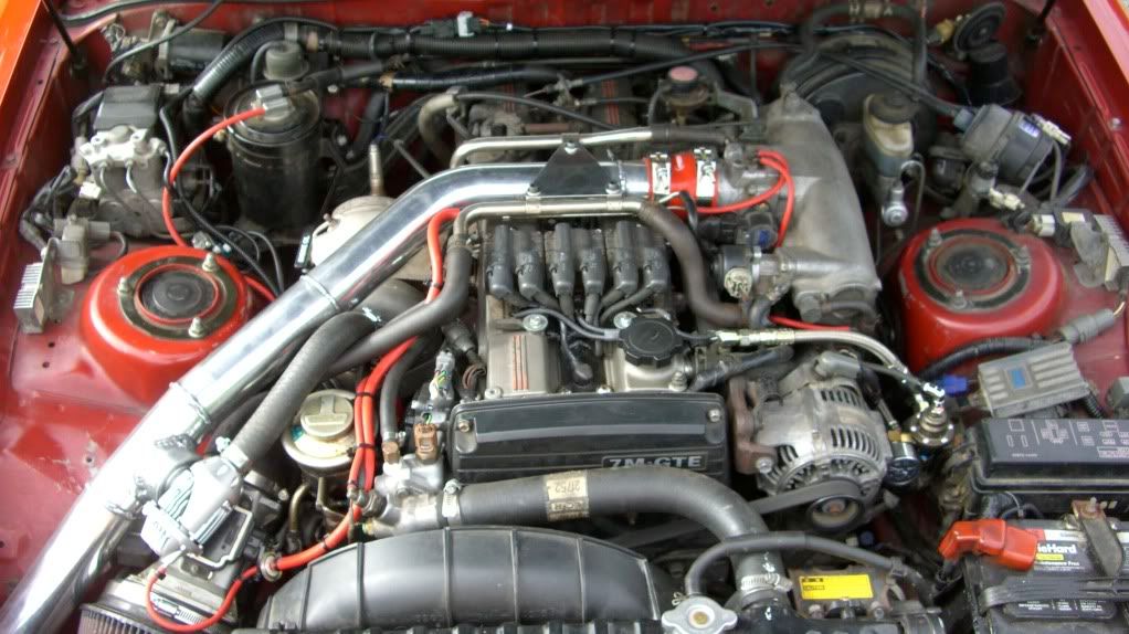

Redo the intercooler piping? I figured that's what I'd have to do because a filter even as small as the one I have will not fit right there beside the piping when its directly on the AFM. I see you have some aluminum piping. What size? As you saw mine is 3" and I'd appreciate a pic of your engine bay so I could see how you managed to route.

When I had an AFM, I had the K&N filter directly fitted to the afm housing. The IC piping is 2.5in and follows the stock flow pattern. Here is a closer pic of the engine bay before I upgraded my turbo and went with a VPC eliminating the afm. If you need more detailed photos...I could try and get one tomorrow or something....

Hmm 2.5 and the filter fits perfectly. Mine doesn't even had the crank fan or shroud it has an electric fan mounted on the radiator. My radiator isn't stock and I'm wondering if maybe its a combination of it being a bit too long and the piping being a bit too wide. Basically as you can see from my pics that whole area where the filter should sit is taken up. I tried putting my filter right on the AFM and just forced it to fit where it will sit, but I was getting fuel cut out the ass as soon as the turbo began to kick in so I assumed the little bit of the filter against the face of the radiator was causing the airflow to be strangled or something.

Just to clarify...I didn't necessarily mean redo the piping....just the accordian hose thing. If the goal is to keep the piping...you'll probably have to consider keeping it the way it is...or getting rid of the afm and using piggybacks to replace it so that you can shorten the hose to where the afm is and put a filter on there.
If that won't work, you might have to scrap the piping and start over.
Just way all your options, price out piping/custom metal fab work and make a decision.
Do you have any local performance shops that do custom fab work where you could get some ideas?
