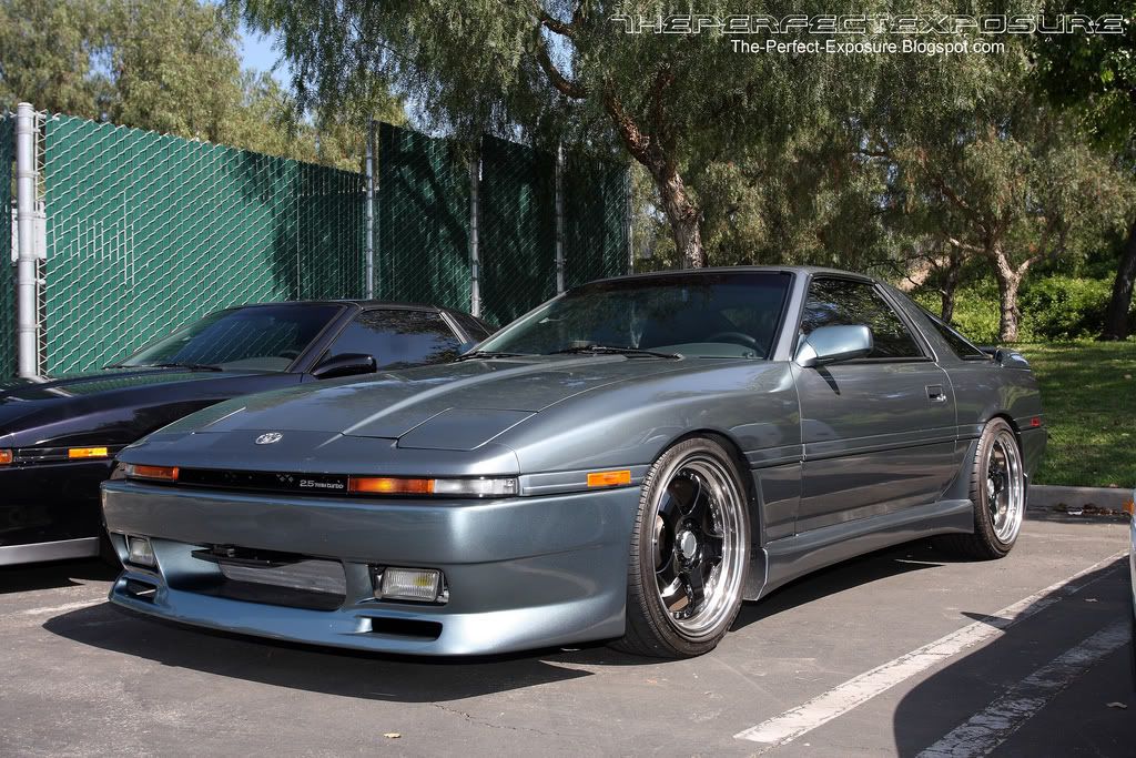

anyone have a picture of an 89+ bumper with the center thing cut out to look pre-89?
coming back to this, does anyone know if you have to swap out to anything 89+ for this to work? i assume the bumper just bolts up correctly.
Moy
It's broken...
Aug 6, 2008
2,432
Beach Park, IL
RazoE;1531467 said:
yeah, it's a bolt-on affair..
doesn't look very good on a stock bumper though..
looks great on a Gracer/Greddy bumper, though..
Looks pretty good with that On The Beat front bumper you Photoshopped too :)
(for those who haven't seen... and not my car haha)
(original)
SuprA70
SF.com 'Grounded' Champ
Do you mean swap in anything pre-89 (assuming you have an 89+ car) to install a cut 89+ bumper? If you intend to mount the pre-89 turn signals and grill, then yes. You need to swap out the header panel support (the metal frame). It has the mounting points for the earlier style signals and grill.
I want to ask about the innercooler mounting for this bumper set up. Is it mounted back further than usual? It looks set further back than normal.
Thanks!
SuprA70
Thanks!
Sits just behind the bumper support just like the stock IC. The Greddy bumper is what makes it look like it sits deeper (I also had the airdam closed up to forcefeed air to the IC).
