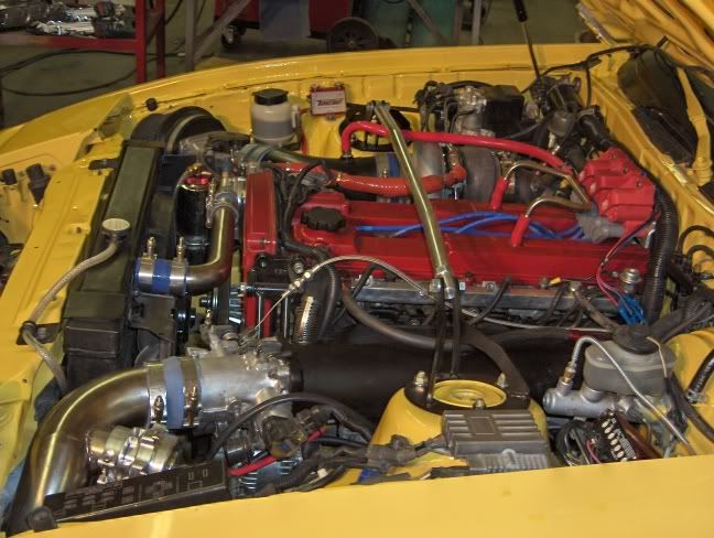

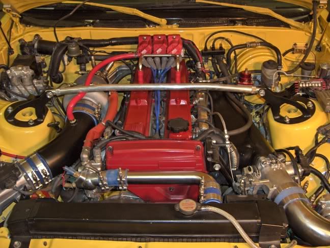

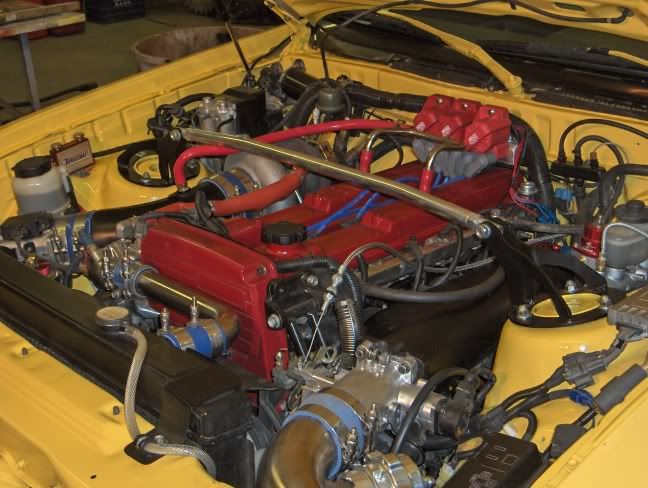

starscream5000 said:
I like your coil paks lintlars ;). How'd you wire them up? Any issues?
Same as the stock coil packs. (+) to all and ground triggers.
Coils cost about 120 some from MSD, but you need to change the plug wire ends as they're GM tower style.
