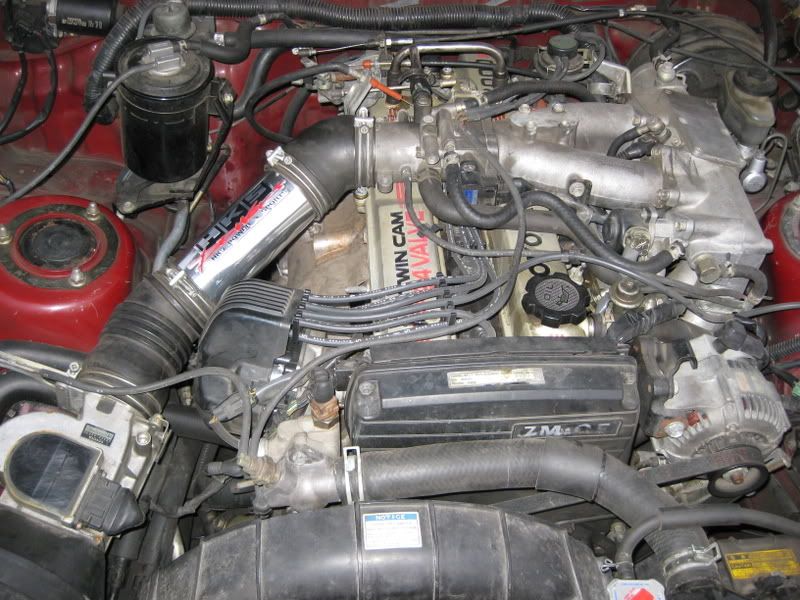

post pictures of your hard pipe air intake

so that i can gets some ideas. could you also tell me what and how you modded so that the stock air flow thing is still on.i tried with just the hardpipe and air filter but the engine kept on shutting off.

Yeah won't run with out that "stock air flow" thing, unless you're SD Maft-Pro.
Before I went that route I had a hard pipe from the first accordian pipe to the last one after the AFM, that's about all you can do with it. It elimates the big air canister. And you can put a aftermarket air filter on the AFM like a Apiex.

3" inner cooler pipe:
Ceramic coated the top pipe:
The pipe from the front of the AFM(Air Flow Meter) goes through the core support, and has my air filter on the end of it, just above and behind my fog light.
