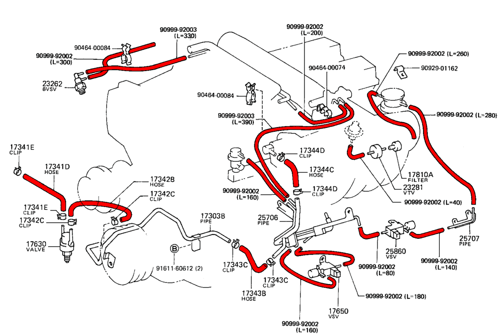

This might help you get your vsv in the right place and clean up your lines abit
