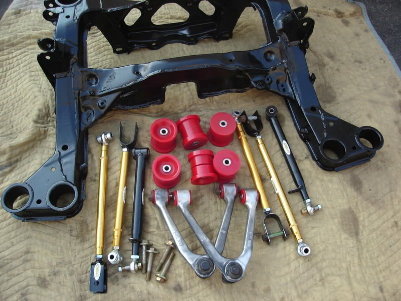

i used the eastwood brand 2 part converter.then i used there encapsulator and a top coat of there chassis black on my subframe's.it seems like pretty hard stuff after curing.i would have rather powdercoated the frame's but i don't have lamps big enough to bake them.
That looks REAL good BTW!!

^ it certainly does! i wasn't aware that anyone made aftermarket subframe bushings (the six large ones), but i also hadn't researched it yet. ;) time to find some!
those are from ron k.he posted about them here on sm
thanks for the comment's.

you're welcome. i'm working on the exact same thing. (just got my subframe sandblasted)
i'll have to pick up a set of those RK's. (i figured they were ronnie's) after slow66 welds my subframe up for me (cracked, and to reinforce it), i'm planning on getting it powdercoated. i was origionally going to paint it, but that was before i really knew that those bushings were available. ;) now i'll remove them, and go ahead with my plans. :)
