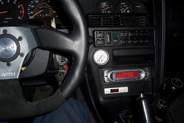

How did you guys hook up the wires for the light into the 12v source? Would I have to take apark the whole dash? Also what should the big red line going through the firewall from inside be connected to?

Fastway: all the power sources you would ever need are located in the cigarette lighter wires. pull out the radio trim and you'll find it. just check around with a test light and you'll be fine.

get rid of that cig lighter and do this... your wires are right there.they come on/off with the rest of the lights and it only takes about 10 min with a dremmel..
