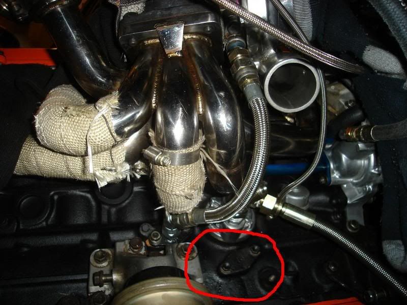

Justin727 said:
the dipstick doesnt have 2 studs around the hole.
DOH!!!:nono:
I see now... it's into the "block-wall", NOT below the mount area... I had the pic angle screwed up in my head!:icon_conf
Hmmmm... interesting. Is that "block-off" plate over the "stock location"?
(never had my HEAD down there on mine! it's sorta a "blind" feeler-install for me... engine left in, and all...)
LOOKS GOOD, though!
-crisp

that is pressurized.
can't return their.
with this mani the return must be to the oilpan.
only way it will work.

the turbo/ manifold setup.
zw manifold, gt76xsuper duplex dbb turbo.
good manifold, but oil filter adapter must be relocated.
