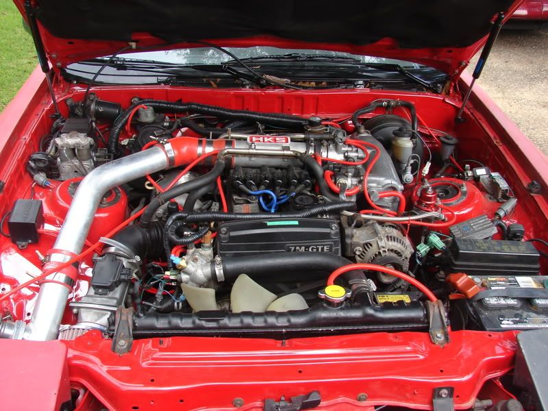

Looks good! I have the same IC kit, worked great on my 2j swap with the addition of a 45deg coupler on the turbo and another straight pipe (routed downward off the turbo 45), just had to cut the pipe that runs to the TB because the 2jzge TB is longer:
Also went through the fender for the IC to TB pipes because of where my turbo inlet is.
Like MA70Snowman said, pretty good kit for the $$, not direct bolt-in but I wouldn't expect that from an ebay kit. Definitely much easier than the completely generic kits IMHO...

This is how mine runs, but again, it is the driftmotion kit. The bends are achieved with couplers on either end of the straight pipe, one just before coming through the hole, and one after the next pipe. This actually pushes the bend upward to where the strut tower is, so I could never add a Strut tower brace. I may one day want to add that, so I would have to redo the piping up there. Cutting the bead off of a pipe is not the best situation, but if you are using T-Bolts, it should be OK. I have a couple of cuts in my set up. I actually used a cut off piece between the two couplers that are butted together at the 3000 pipe. Oh, and as the picture shows, my bay has been painted prior to the motor install. The exterior paint is yet to come.
